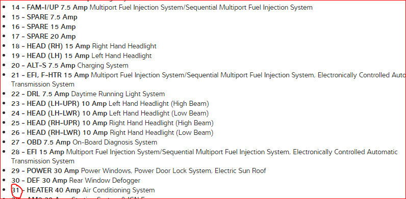

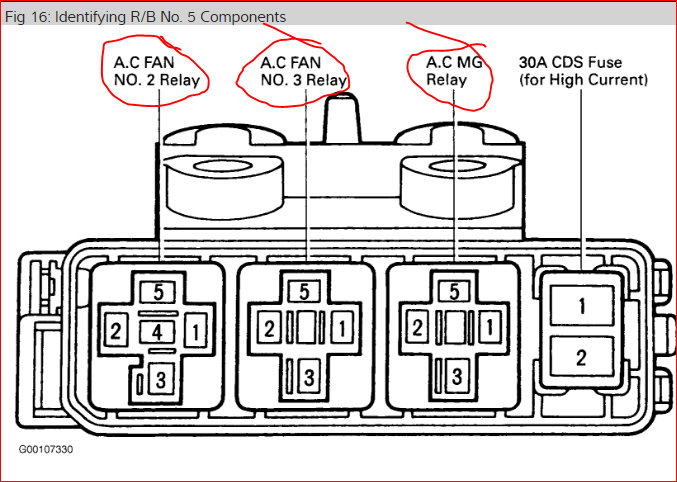

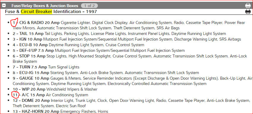

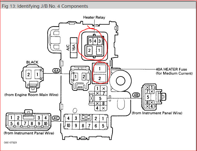

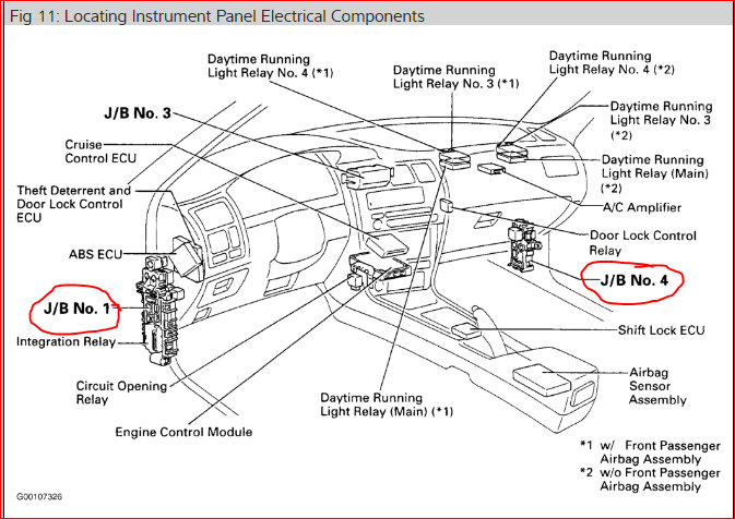

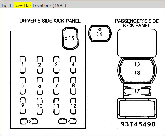

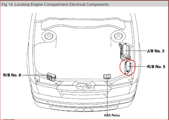

Where is the blower fuse located?
Wednesday, July 11th, 2018 AT 10:00 AM
DANNY L
  • 5,648 POSTS
Hello, I am Danny.
I have attached a few pictures with the locations of the fuses and relays related to the A/C system and blower motor. Everything to check I circled in red. Hope this helps and feel free to ask any further questions if needed. Thanks again for using 2CarPros.
