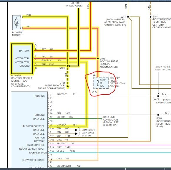

Car has CJ2 climate control with the programmer sending a variable voltage to the blower control module. The module transistor varies the voltage to the blower motor. I tested motor with 12 volts direct ... OK. The module receives 12 volts power and ground ... OK. Output wire from module to motor ... OK.
But, with module disconnected, I try to check the variable voltage coming from programmer. It reads 8.2 volts at every fan speed with ignition in "run" position.

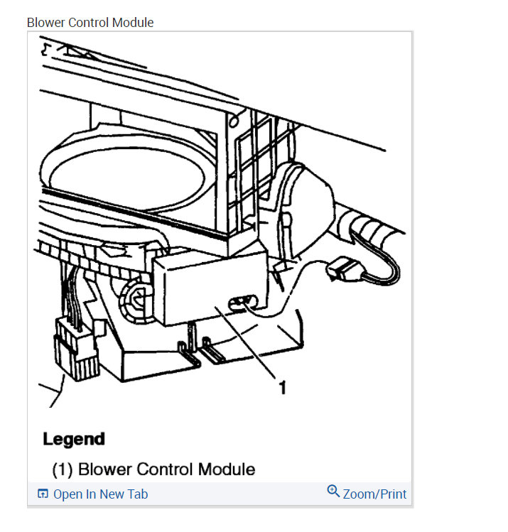

Good morning,
This sounds like the blower motor control module has failed internally and not changing voltage the way it should.
I would verify power to the module. If you have battery power to the module then most likely the blower module is the issue.

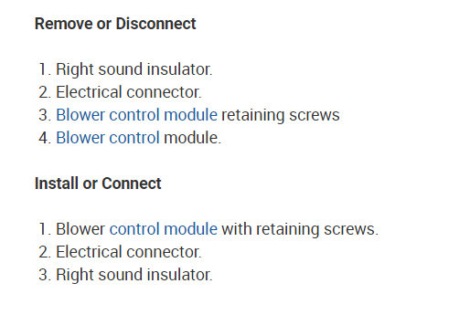

I attached the diagram of the system for you below for you to view. I also attached the procedure for you for the replacement.
Jun 22, 2021 at 7:49 PM

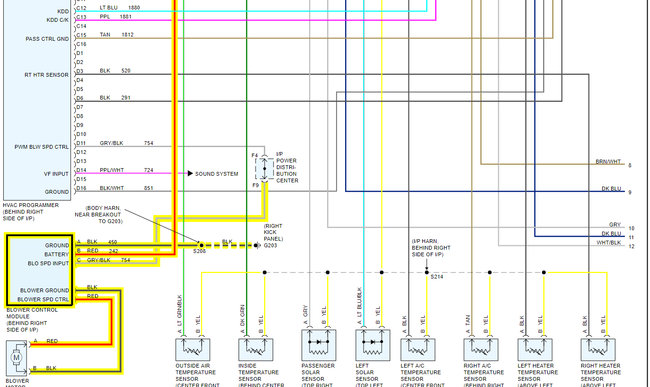

The diagrams are quite different from the factory manual drawings. The module has 4 terminals: hot power, ground, input signal, and output voltage. I have checked those things. My concern is the input signal from the HVAC programmer. With the module disconnected, the signal reads 8.2 volts instead of a variable voltage as the speed button is changed. If that were true it shows the programmer is at fault. But all the door functions work normally, except blower fan. I guess my next step is to back probe the input signal when the module is connected. The symptoms indicate a bad module, but only if the input signal checks okay. My module is ACDelco 15-8684.

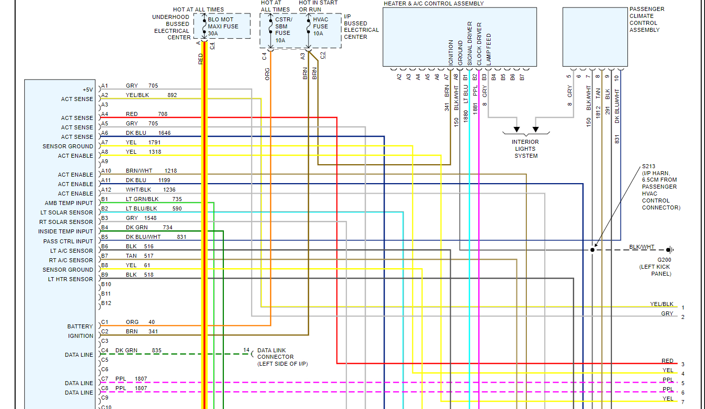

The 8.2 might be good. It or the control may just be calling for a slower speed than full blast. I attached the correct diagram for you.
Check the fuse I circled for power on both sides.
Jun 23, 2021 at 2:07 AM

The blower feedback fuse 11 in the relay center checks good. The factory flow chart says the input signal voltage should be between 6-8 volts, definitely not less than 6 volts. So that checks okay. I am 99% certain it is the blower control module. A new module is $200.00 plus shipping to Canada. Since I am also an Electronics Tech, I am going to replace Power Transistor.

When the module is disconnected, I believe the input signal just shows a standby voltage since there is no blower feedback signal. Getting closer!

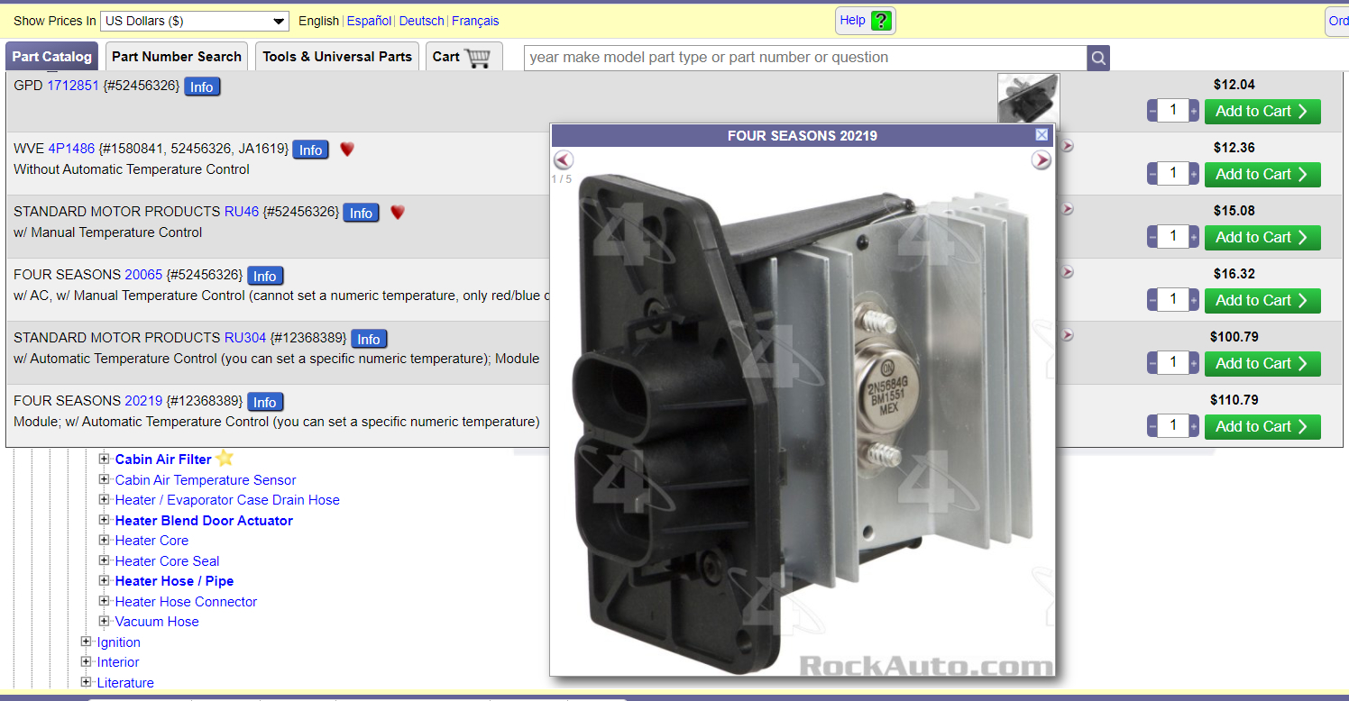

That is correct.
I attached the part for you from Rock Auto. It has a power transistor attached to it. It is only $110.00. Call them and see what the shipping is to your location.
Jun 23, 2021 at 5:09 AM

I ordered a new module from RockAuto, after soldering in a new power transistor did not work. Now it works great. During my initial testing I spun the squirrel cage blower by hand to confirm that it was not tight or seized. I also applies a direct 12 volts to it. All was good.
