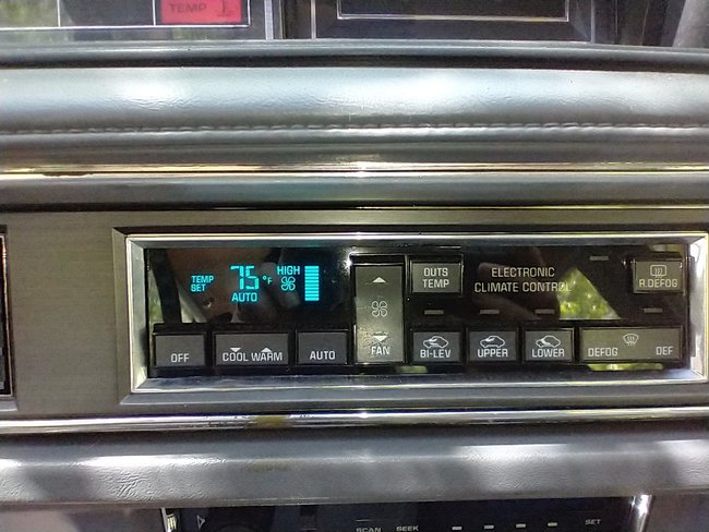

The car listed above is an Olds 88 Royale Brougham. The blower fan continued to run after turning off the car and had to disconnect the battery to get it to stop. Now the blower fan won't come on at all for heat or A/C. The A/C compressor comes on, but nothing comes from the vents. I tested the blower fan and it is good. Tested the relay and it opens and closes. New A/C was installed last year. Any ideas on what to check?

EEDGE
It has all the electronic stuff and no knobs for turning on the fan if that makes a difference. But now off to find a relay. Thanks again

  • 15,418 POSTS
Okay, that makes it a bit different. The electronic controls use a blower control module and not a common relay. To test it you unplug the connector from the module and verify power at the red wire in the connector. Then use a test light on the gray wire with a black stripe. That is the control output. If you plug the connector back in and probe the back of that wire the test light should get brighter as you turn up the blower speed. If it does then the controller is bad, if it doesn't then the control head in the dash may have failed.

EEDGE
Finally got time to test. There is power at the red wire but I get nothing on the grey wire with the black stripe.
May 11, 2022 at 7:14 AM
STEVE W.
  • 15,418 POSTS
Okay, try connecting the test light to the red wire then touching that to the grey wire with red. Then move the blower speed control. See if it changes now. If not, then the issue is likely in the dash controller. If it now shows a light that changes as you adjust the fan speed, then it's the speed controller. These early systems were never really designed for testing, the SOP was to grab a new one and install it as the test.
