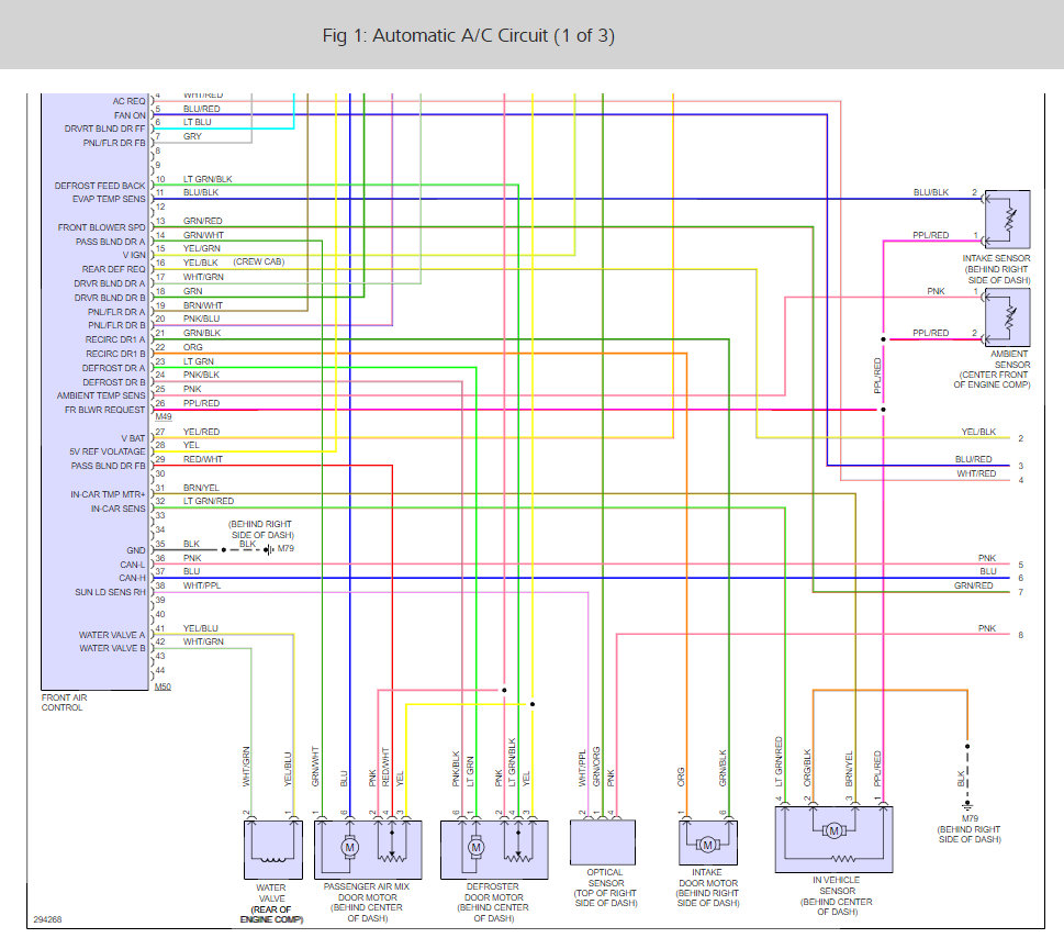

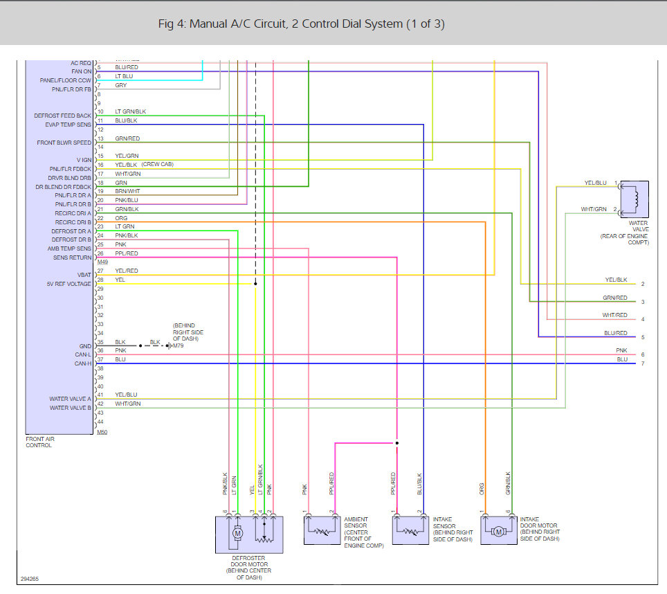

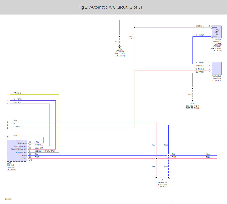

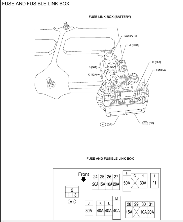

A/C/heater blower fan runs all the time. A/C works when control knob is engaged. Replaced center control unit but blower fan runs all the time.
Sep 4, 2017 at 10:02 AM
  • 55,423 POSTS

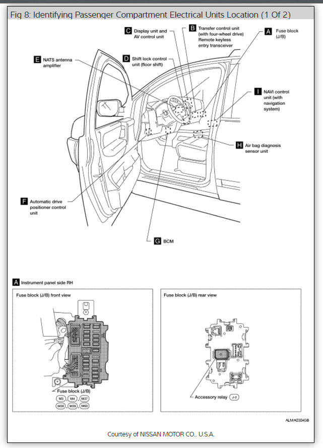

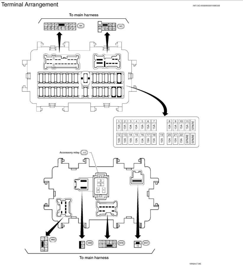

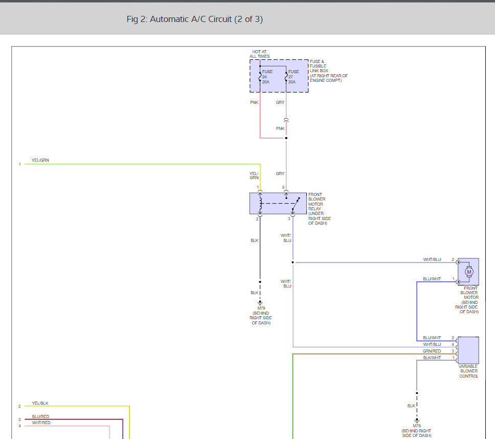

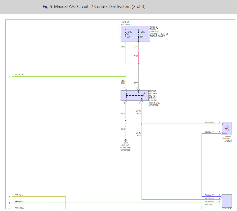

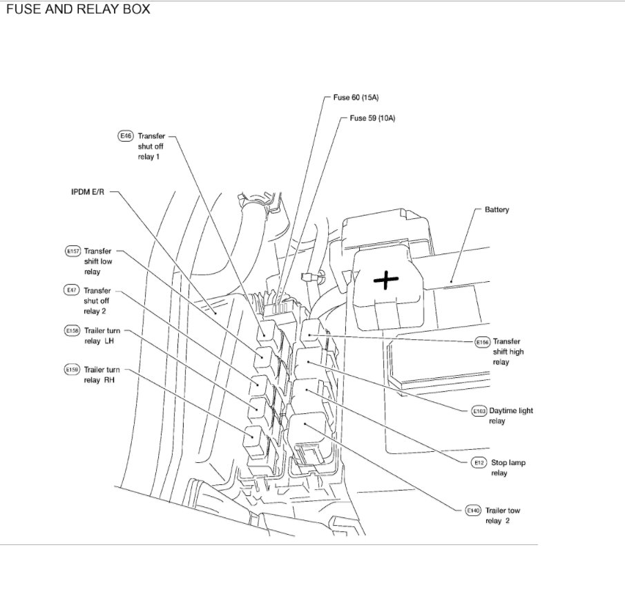

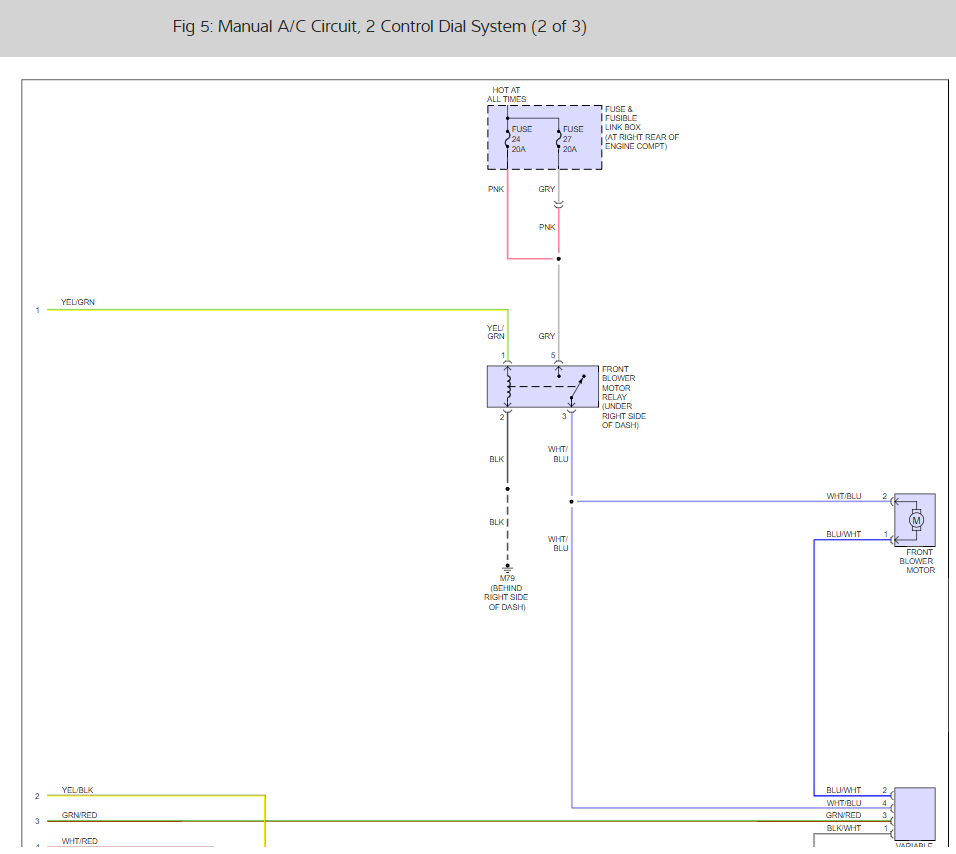

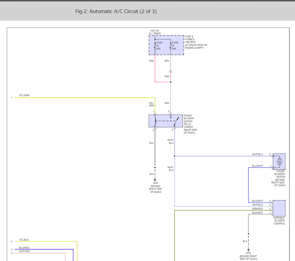

It sounds like you have a blower motor relay that is stuck on, try to remove it to see if the blower stops.

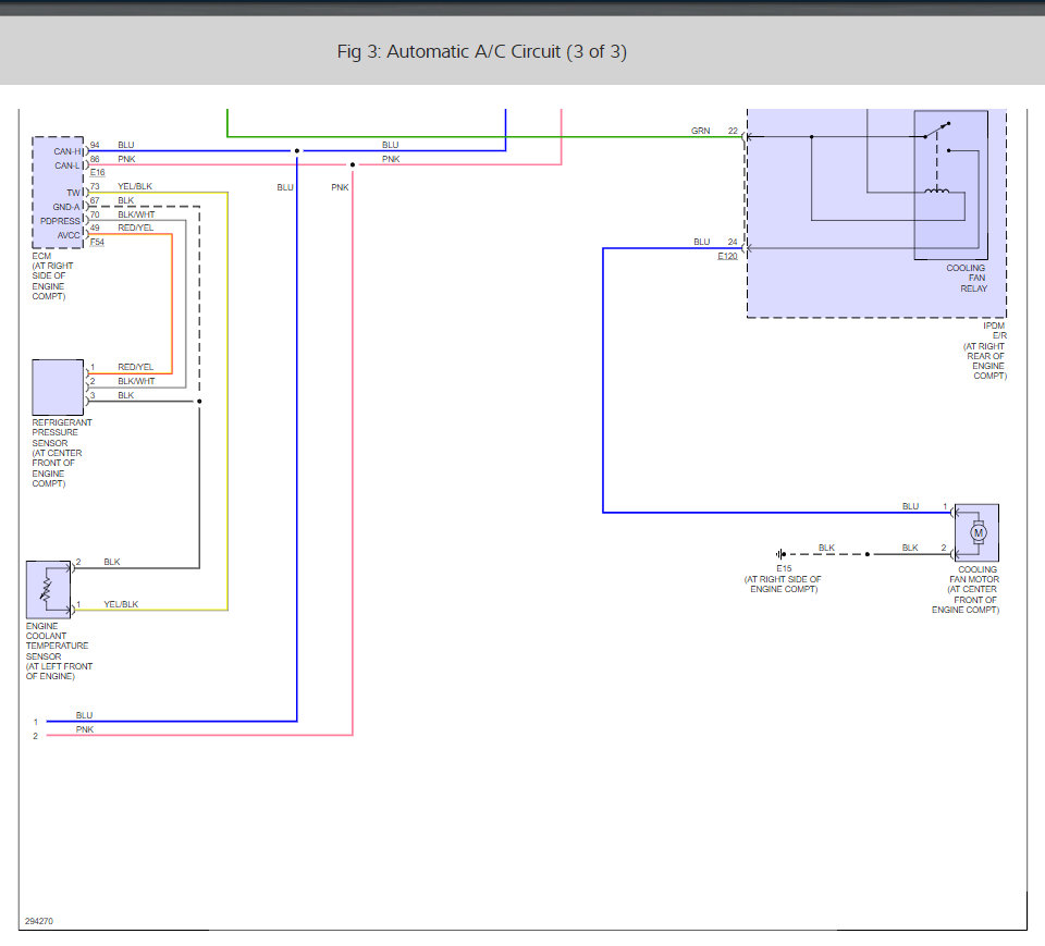

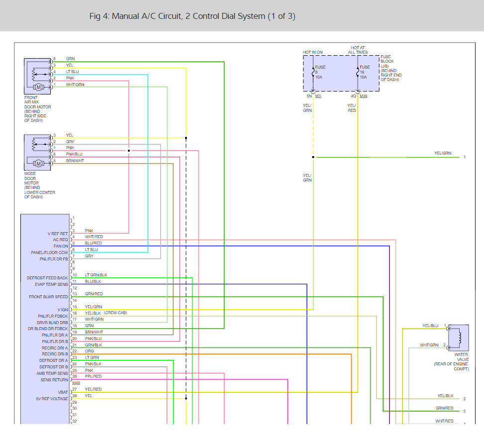

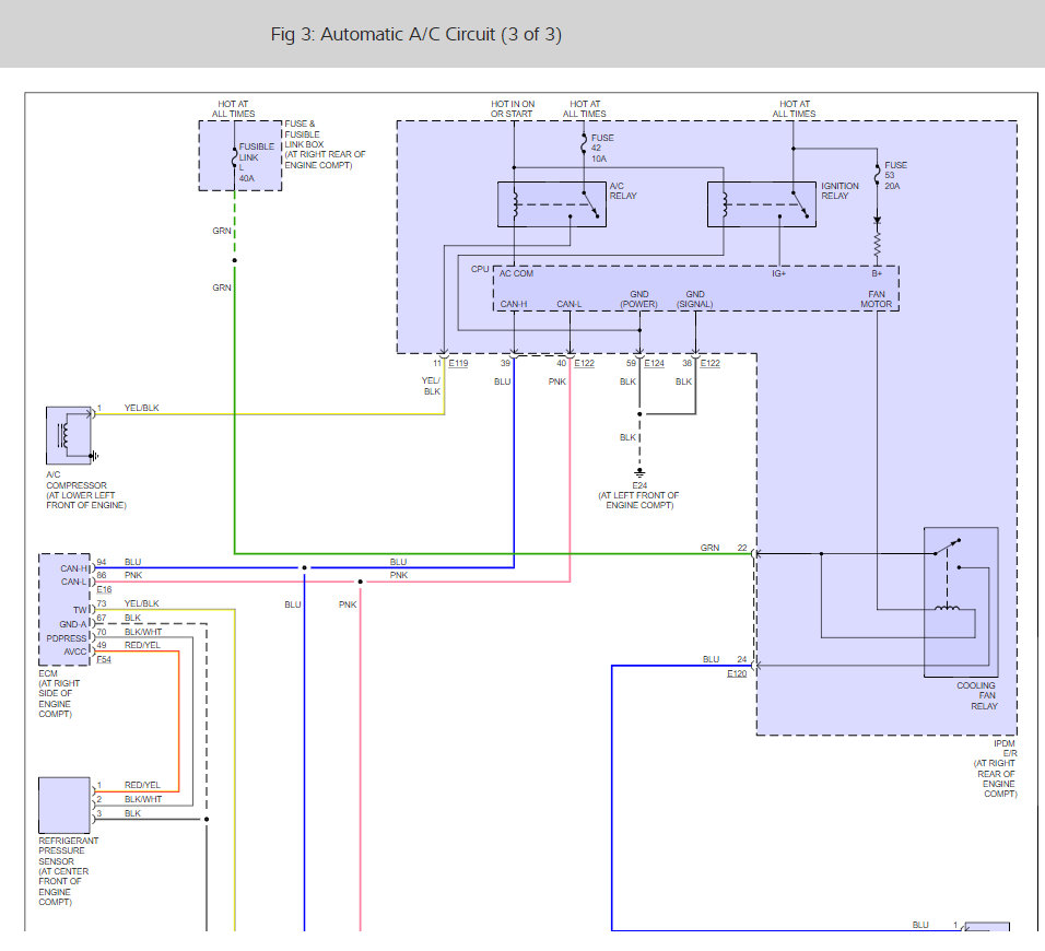

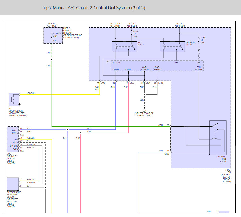

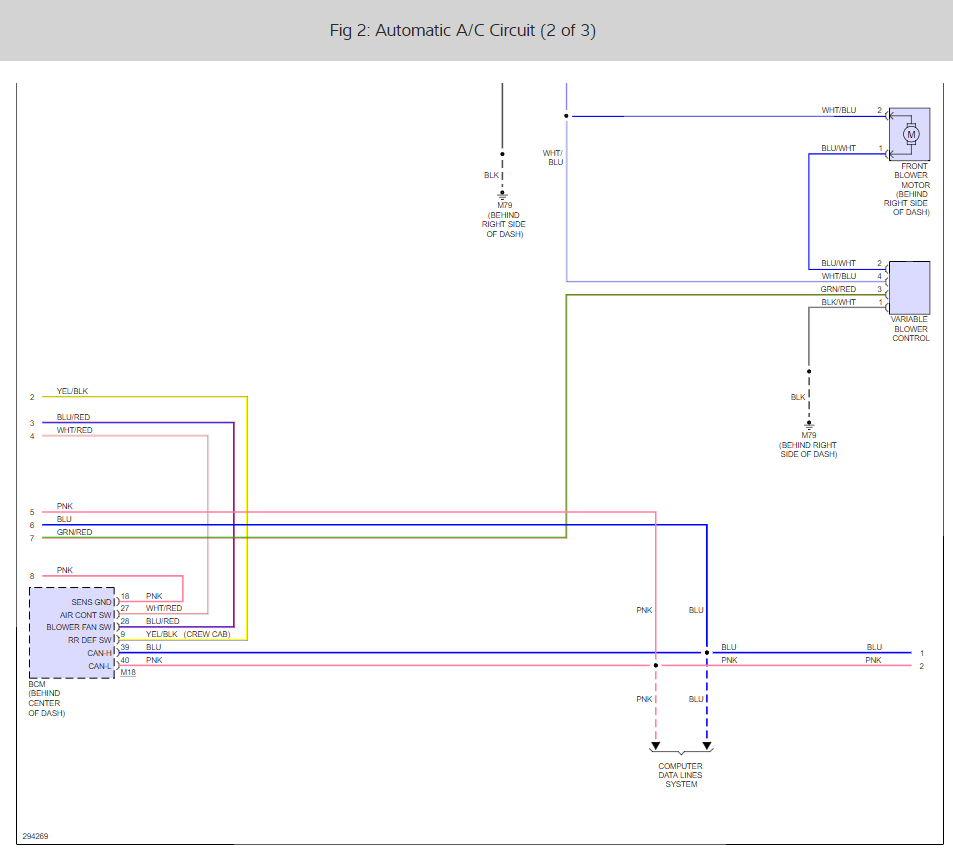

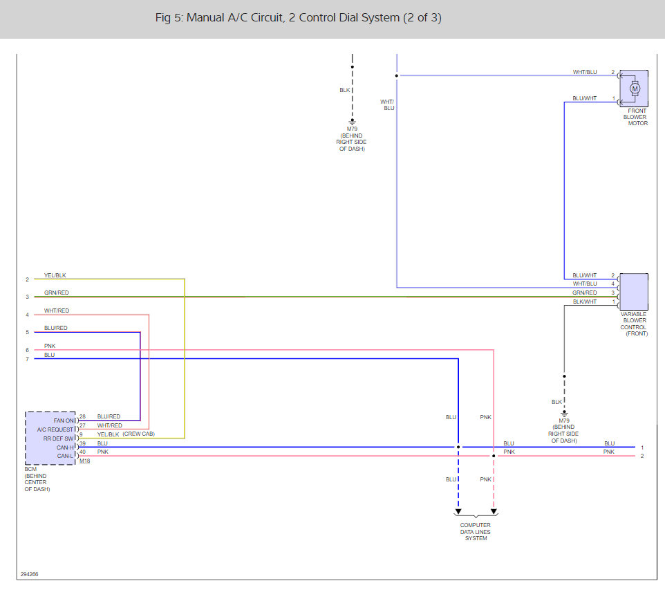

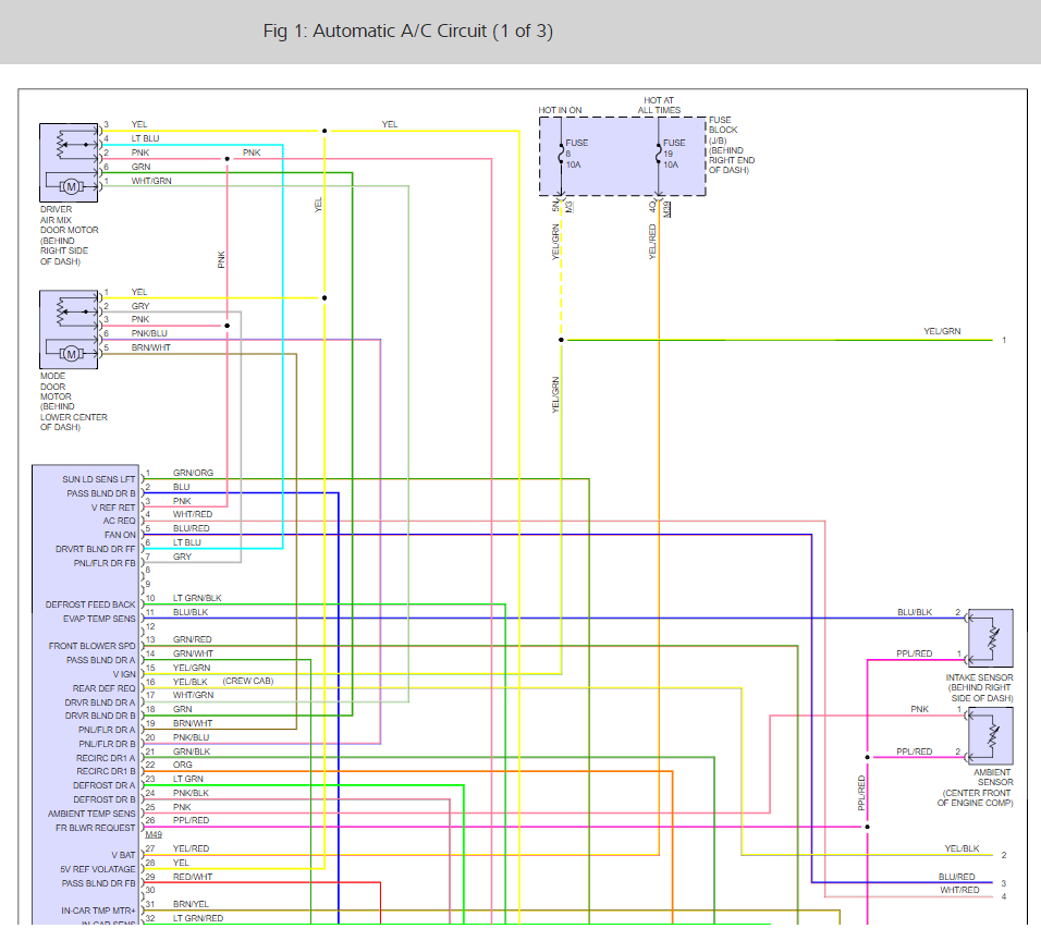

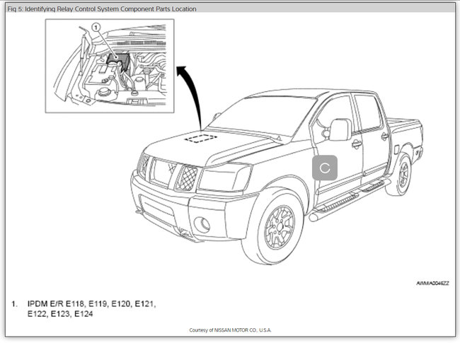

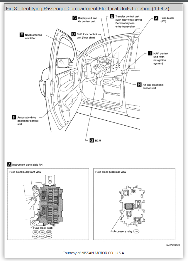

Here are some diagrams (below) and a guide that will help us fix the problem. The relay is #107 in the last fuse box diagram

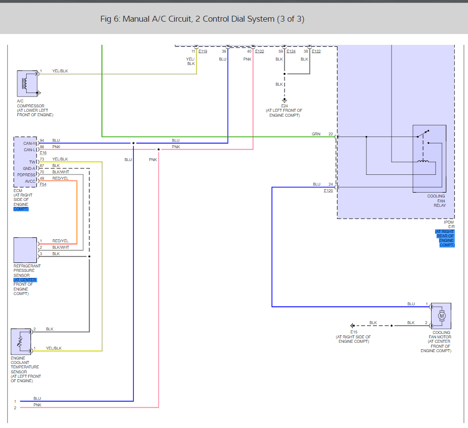

I included the wiring diagrams for both manual and auto system is case we need to go deeper.
Please let us know what happens so it will help others.
