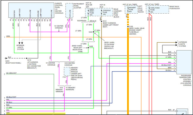

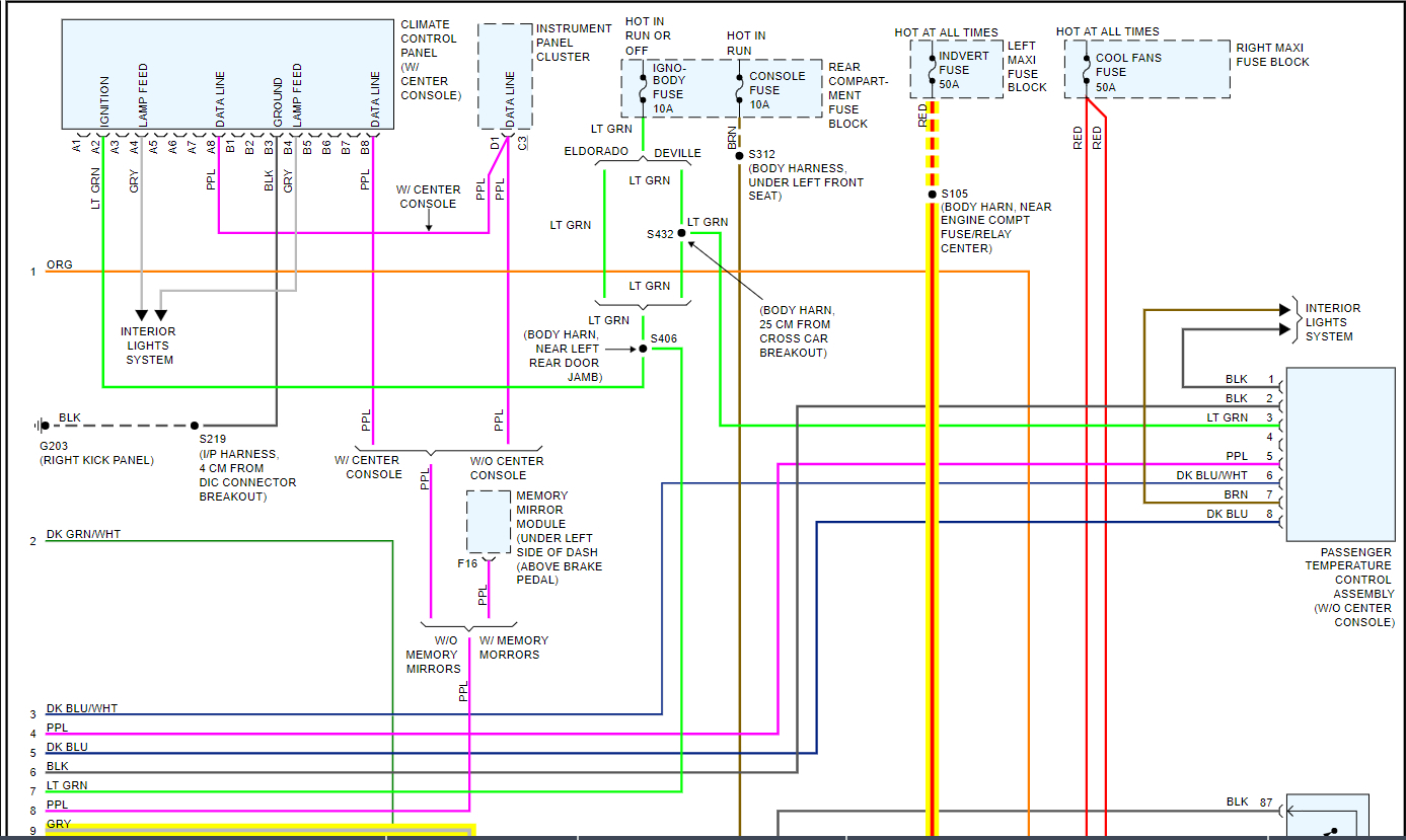

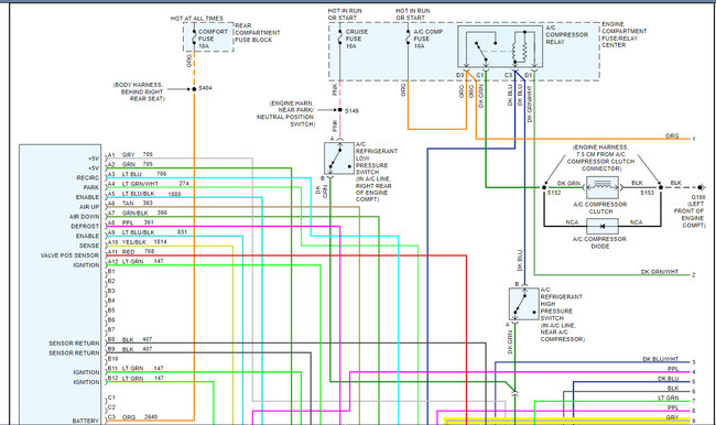

My blower motor or fan will work just fine then it will just shut of,, but no sooner then it cuts off and tries to come back on.
It’s like I can hear powering back up.
Nov 13, 2020 at 5:25 AM
  • CAR REPAIR CONTRIBUTOR
Good morning,

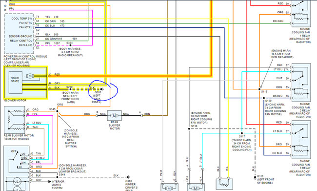

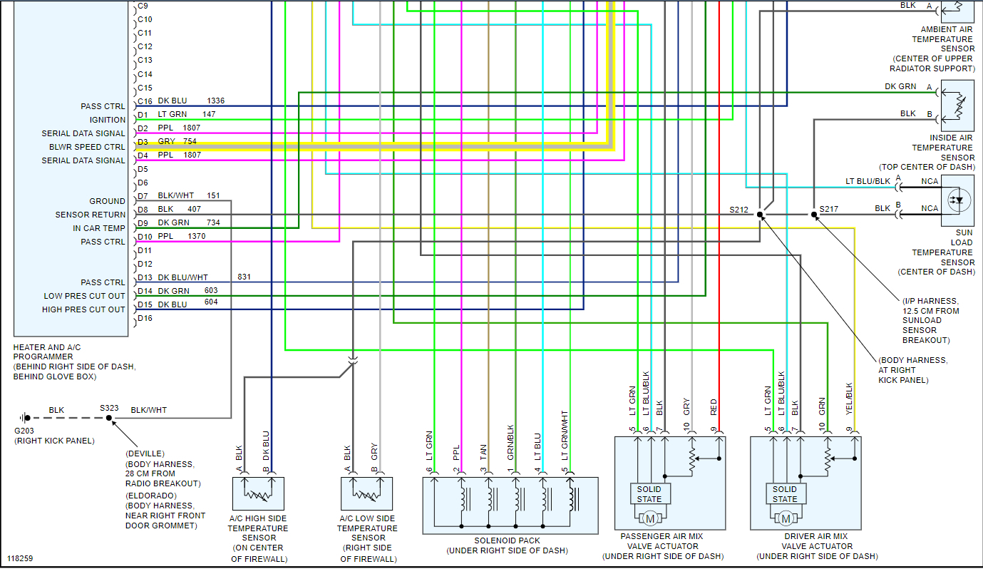

I attached the wiring diagram of the system for you. You need to do some voltage checks at the blower motor to be sure the connection is good as well as the voltage.

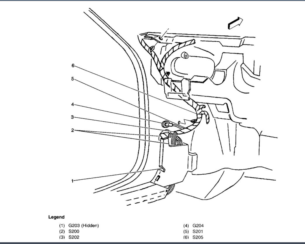

In the left front of the passenger compartment, behind the kick panel
I would also check the ground connection. I attached a picture of the location for you. It is G203.
