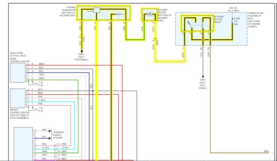

The air stopped flowing in my car and after I replaced the blower motor and resistor. It is still not working. I think I will check the fuse next, but I am not sure which fuses to check.
Anything else I should consider before taking it to a mechanic?
Dec 23, 2020 at 7:06 AM
Good morning.

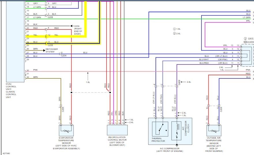

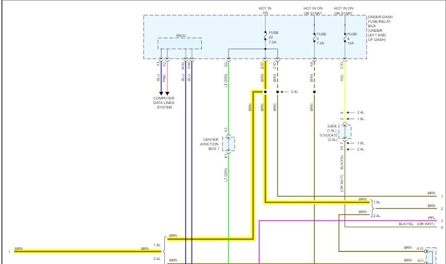

I attached a wiring diagram for you to view. Check the fuses for the relay to be sure power is at the blower motor itself.
