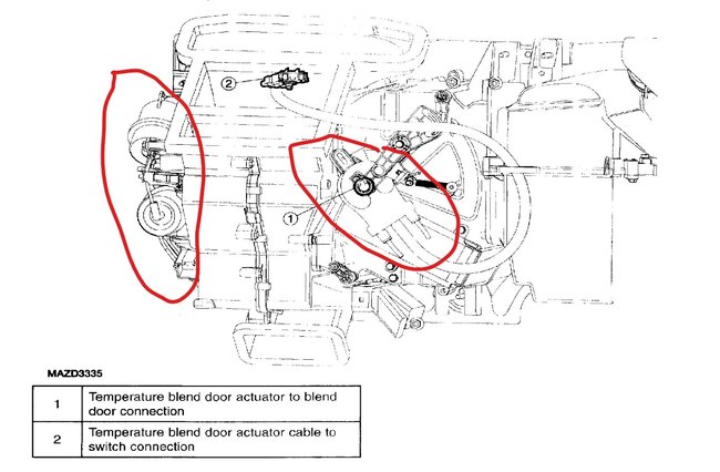

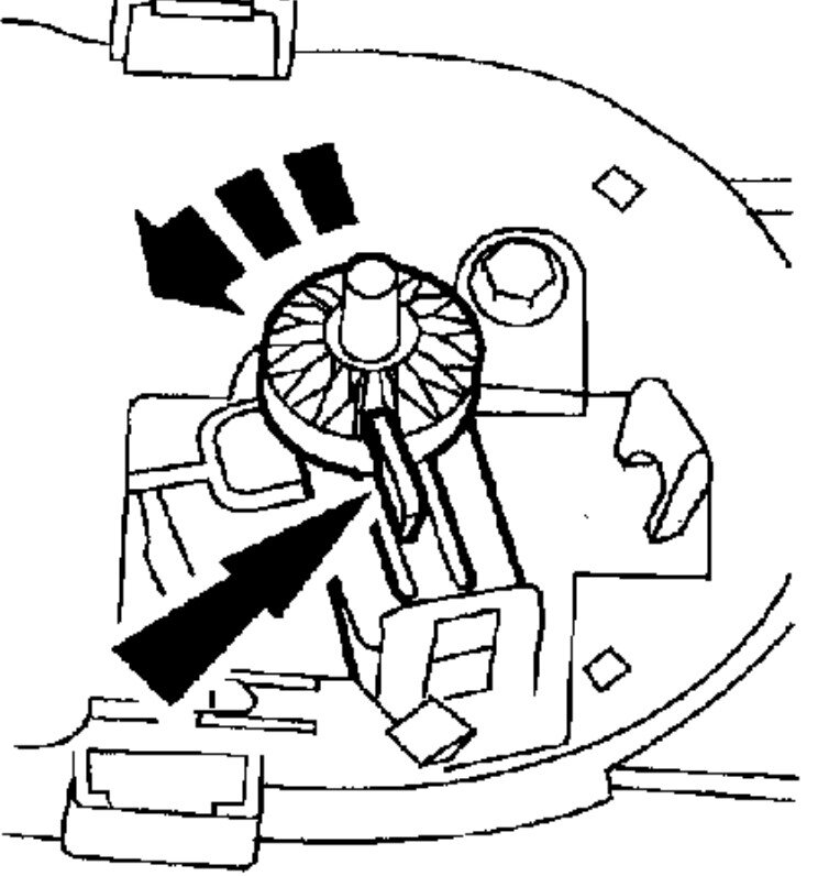

I am having the most difficult time locating the blower door and actuator for this vehicle. I am fairly confident that i have rule it down to that being the problem. Confirmation would be helpful, and an exact location would be amazing.
heat and air temps are barely functioning correctly.
Air flow is normal.
When the vehicle is off all knobs turn freely
When the vehicle is on, if the circulation knob is centered on fan mode, the temp adjustment knob turns freely.
If the circulation knob is pointed to either exterior or interior, the temp knob has significant resistance when turning from hot to cold. Noticably less resistance from cold to hot but still far more resistance than should be present.
There is obviously an audible flopping sound when transitioning from hot to cold, at which point all resistance goes away.
When put back to fan resistance goes away.

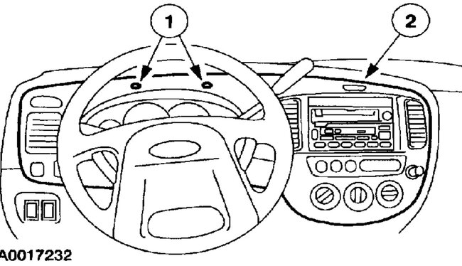

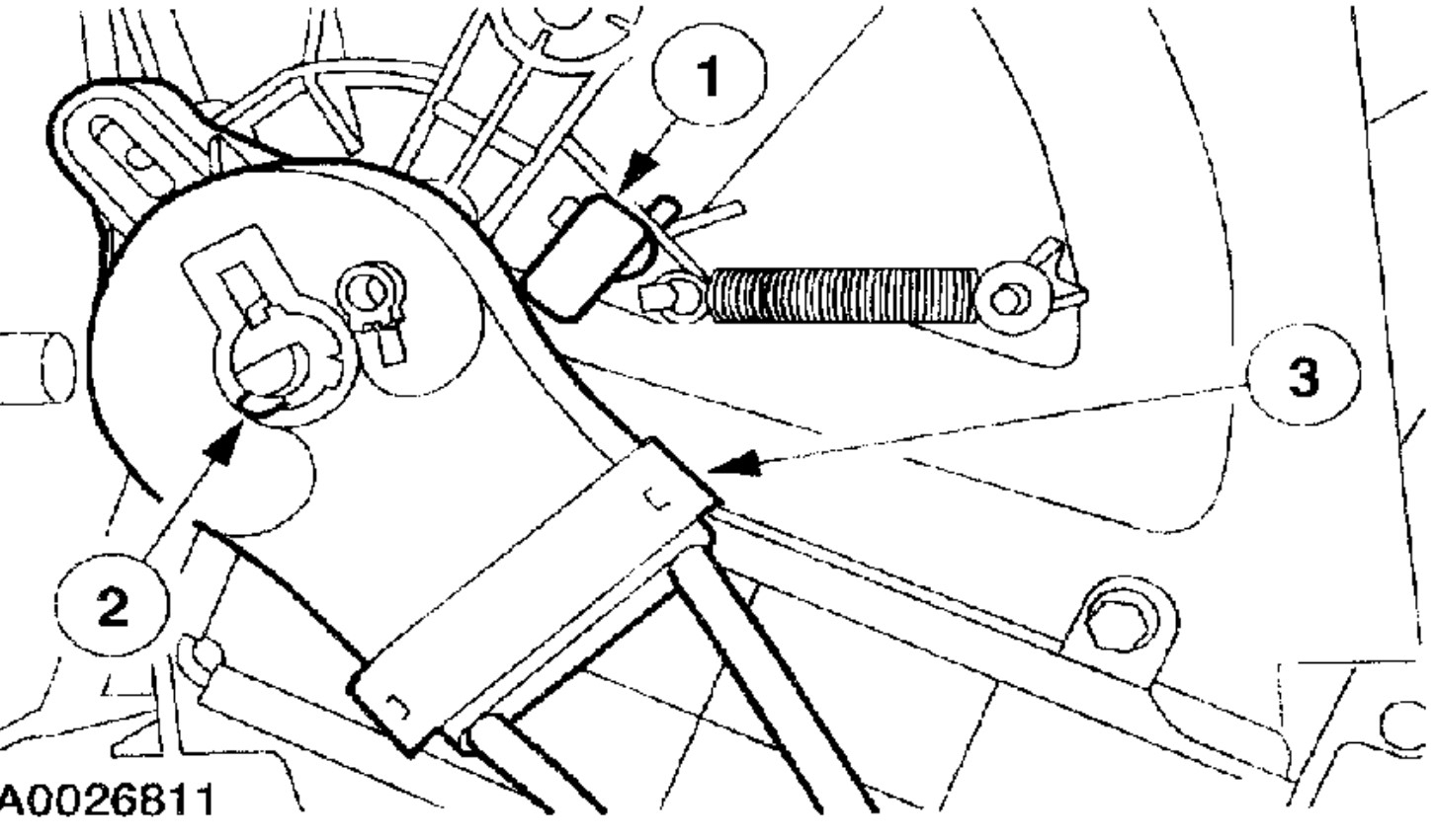

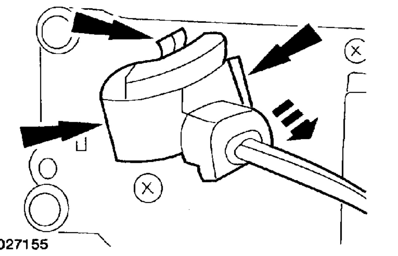

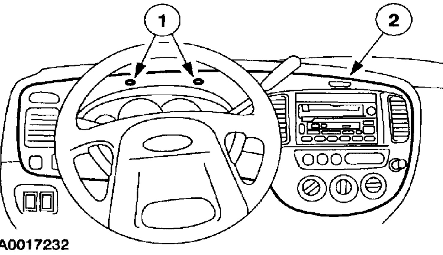

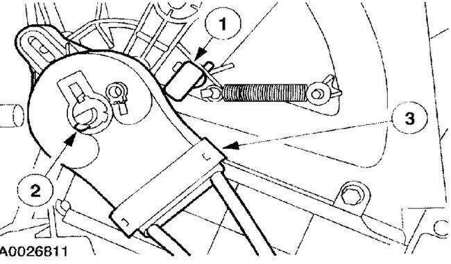

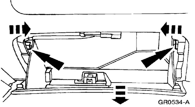

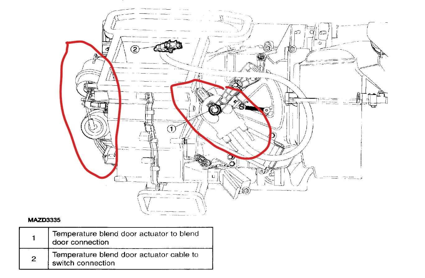

That truck doesn't use electrical actuators for the blend door, it has an old school cable control for temperature and vacuum pots for the mode controls. You can access the cable from two locations, through the glove box opening after you remove the door and if the opposite end is the problem then you would remove the control head to get to it. To get the GB door off you release the two tabs at the back by pushing them in and letting the door drop down then it should lift out. Behind it will be the control cable like the second image. The special tool is to lock the blend door in place and commonly comes with a replacement cable as it's basically a short pin with a handle. The third shows the mode pots on the left and the blend door on the right. Next you pull the dash trim to get to the back of the control head. Your description sounds like the gear that moves the cable may have split. With the trim down you will see where the cable connects to it. Disconnect it and examine the gear there and the one in the cable. To replace it you need to make sure the gear is aligned with the locking tab.

2. Lower the glove compartment. Press the glove compartment release tabs inward while pulling downward on the glove compartment door.
3. Disconnect the temperature blend door control cable.
1. Align the locator holes and insert the special tool.
2. Release the locking tab.
3. Remove the temperature blend door control cable from the blend door shaft.
4. Remove the instrument cluster finish panel.
1. Remove the two screws.
2. Remove the instrument cluster finish panel and disconnect the electrical connectors.
5. Depress the three tabs and remove the temperature blend door control cable.
6. Rotate the gear to align the locking tab with the notch in the gear before installing.
