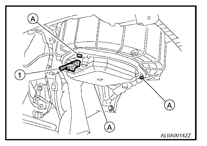

Lately anytime I turn on the blower for anything, A/C, heat, defrost, the blower doesn't come on right away. It will eventually start blowing but only after 4-5 minutes, like it needs to warm up or something. I have done some mechanic work but I have no knowledge about electrical.

It sounds like either the motor is going bad or you have a bad connection. When the fan runs, does it make any odd sounds?
Do me a favor. Here are the directions for replacing the blower motor. First, locate it and check the condition of the plug. Make sure nothing is loose and the contacts are not corroded. Then, confirm there is power to the connector when you first turn the fan on and nothing happens. If there is, then the motor is likely the issue.
The pictures correlate with the directions.
___________________________________________________
2007 Nissan-Datsun Altima L4-2.5L (QR25DE)
Removal and Replacement
Vehicle Heating and Air Conditioning Blower Motor Service and Repair Removal and Replacement
REMOVAL AND REPLACEMENT
BLOWER MOTOR
Removal and Installation
pic 1
REMOVAL
1. Remove the glove box.
2. Disconnect the blower motor connector (1).
3. Remove the three blower motor screws (A) and remove the blower motor from the blower unit.
INSTALLATION
Installation is in the reverse order of removal.
