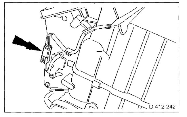

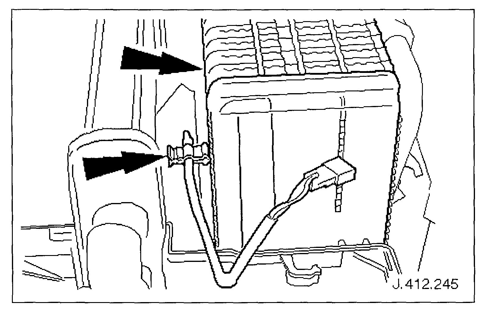

My wife's Jaguar XJ8 Vanden Plas blower motor sounds perfectly fine with plenty of force (cfm's) from sound but the dash vents produce little air discharge. I am assuming that when we purchased the car there might be an issue we were not aware of, like possibly a dirty or clogged EVAP coil or blockage in the ducts. Do you have a diagram of the air handler duct assembly for this year? If so, then I can further diagnose the issues. Air temperature differentials are fine in readings but what should my suction line pressure be? Note: I have all the AC equipment, gauges, vacuum pump recovery unit, etc.

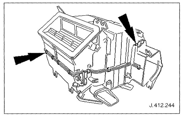

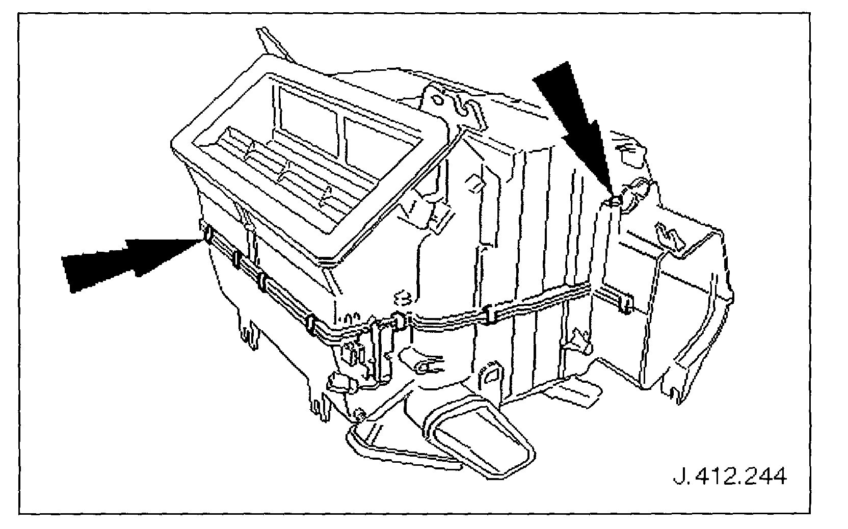

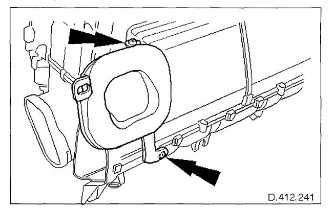

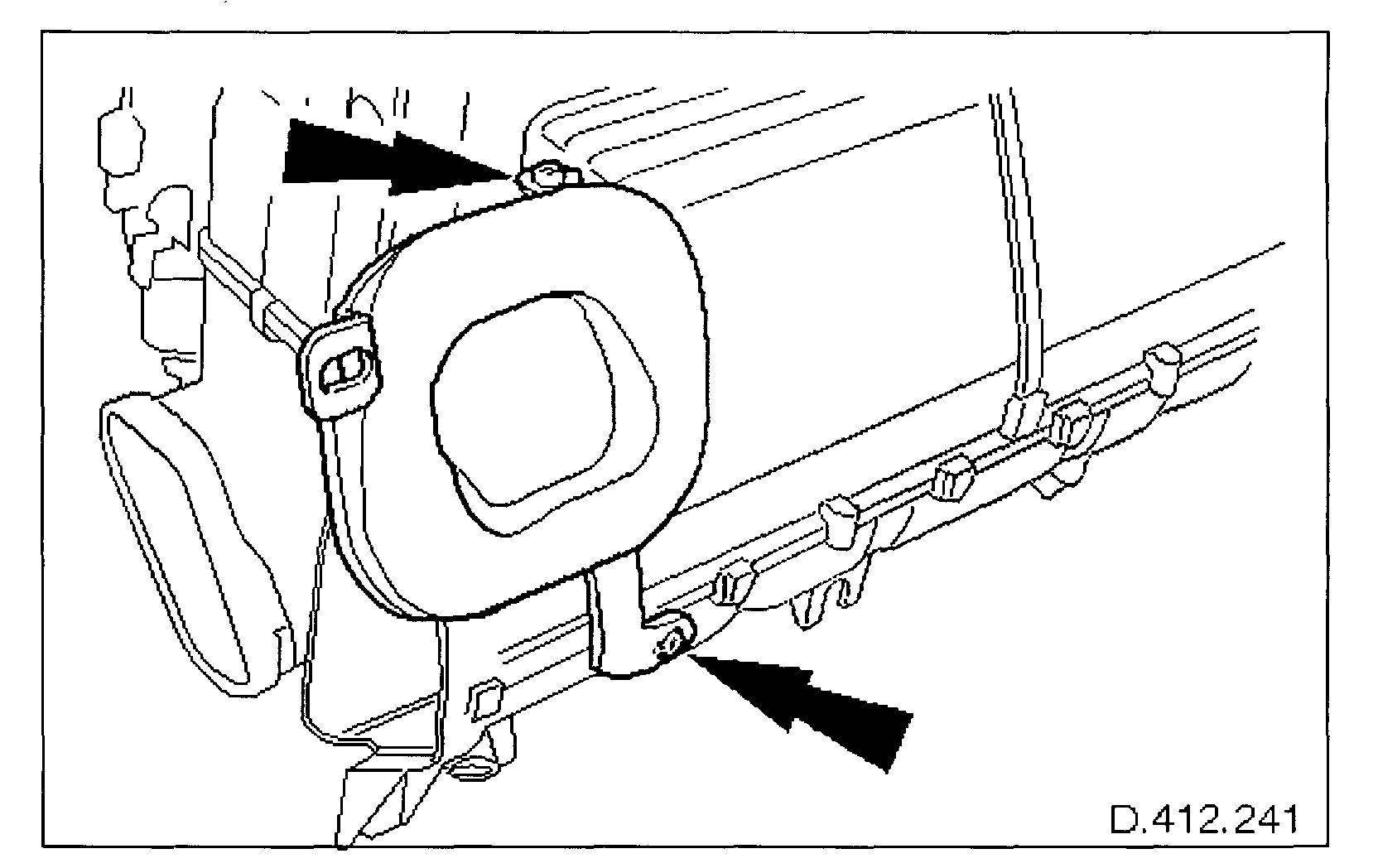

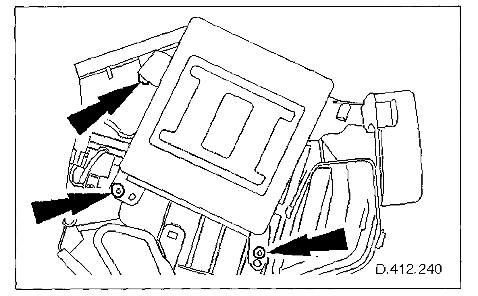

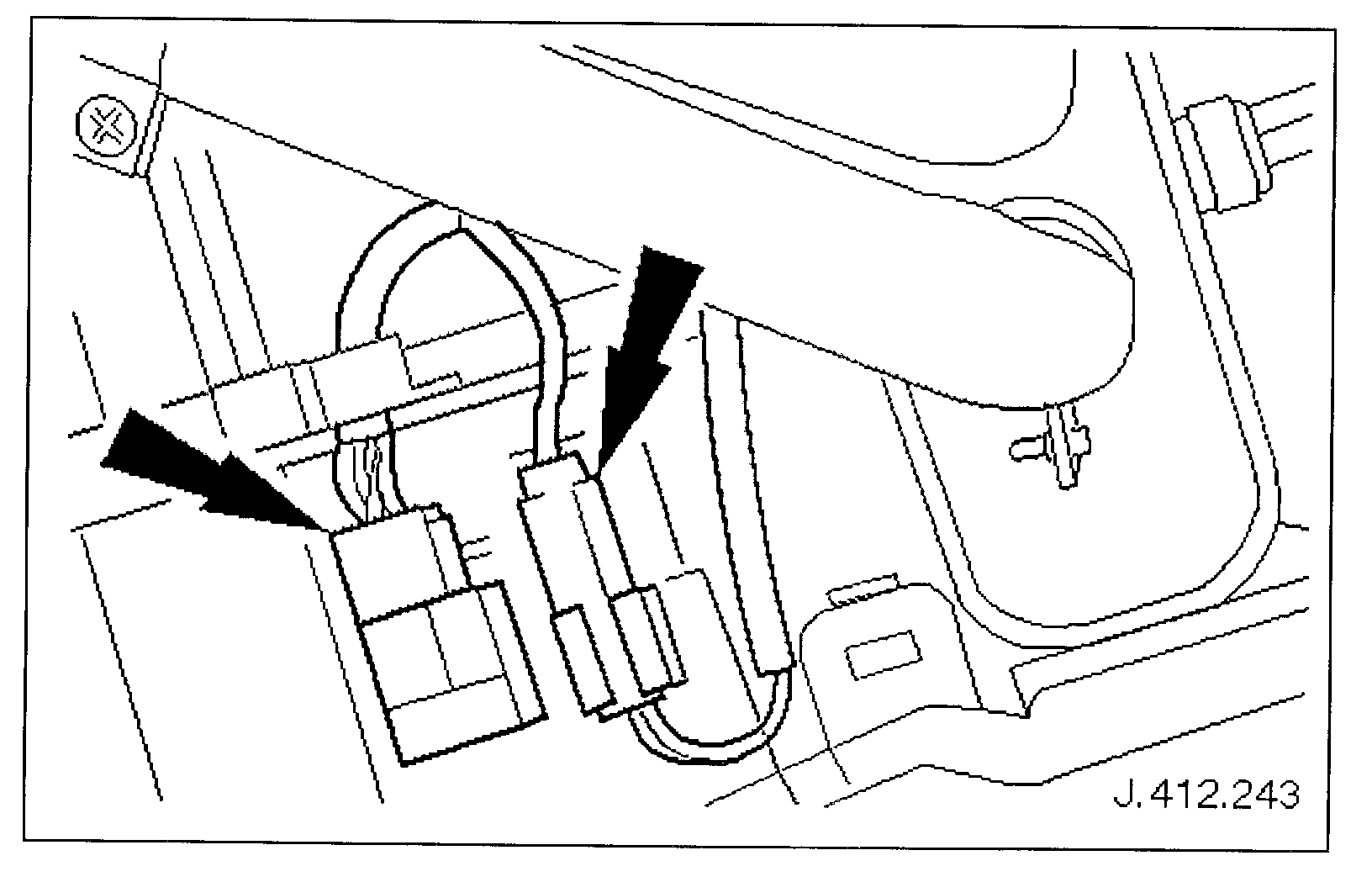

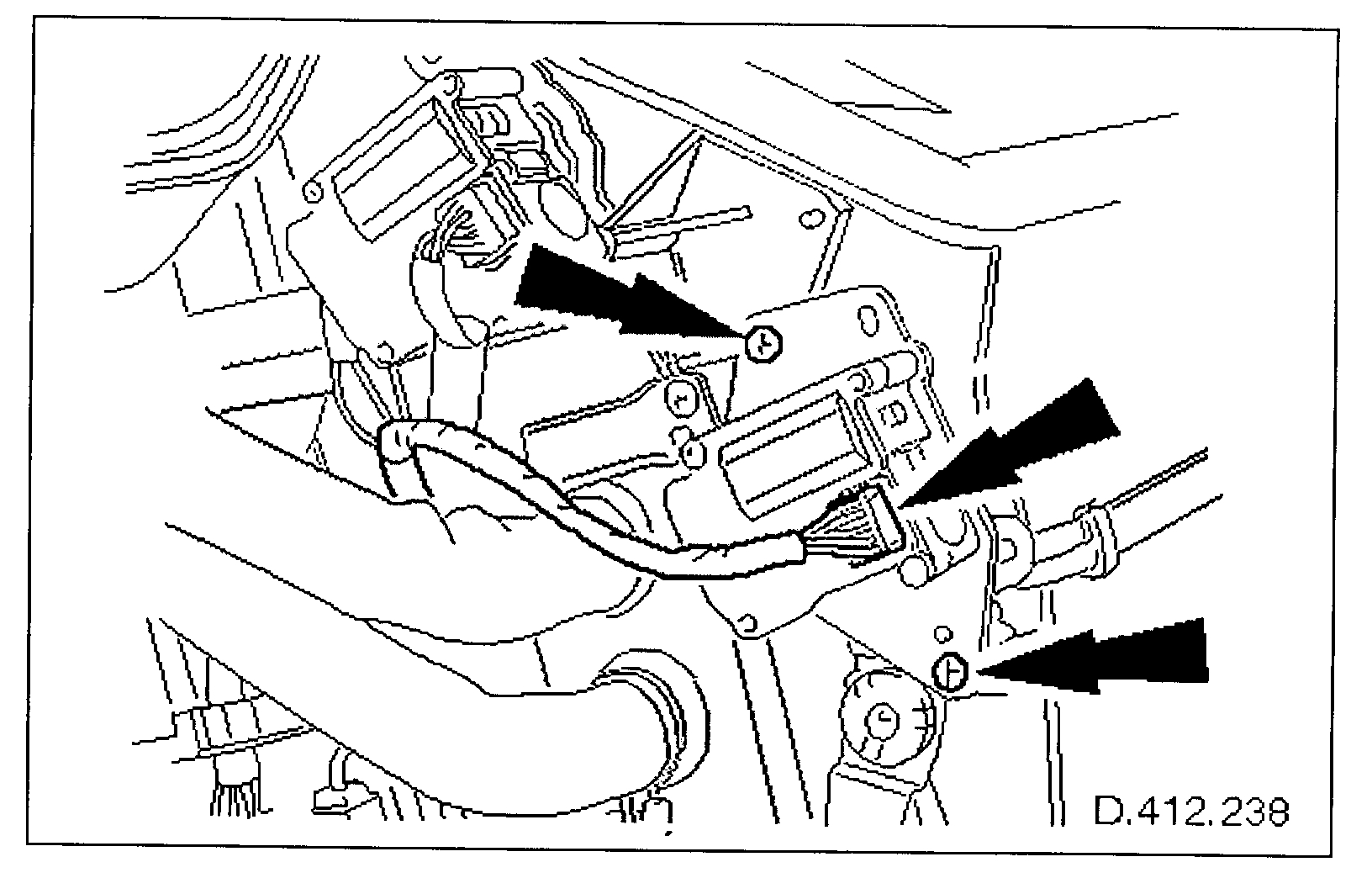

The only diagrams I was able to locate related to the system was for removal of the evaporator. It includes pictures of the box/vents. I will attach the directions so you can identify different parts. All attached pictures correlate with these directions.
___________________
Vaporator
Removal
1. Remove heater/cooler unit;
2. Remove air conditioning control module from heater/cooler unit.
- Slacken upper fixing.
- Remove lower fixings.
3. Remove evaporator pipe firewall seal plate.
- Remove screws.
- Remove plate.
4. Disconnect heater matrix temperature sensor.
- Detach beater matrix temperature sensor connector from unit.
- Disconnect connector.
5. Remove footwell servo motor from heater/cooler unit.
- Remove screws.
- Remove motor complete with bracket.
6. Disconnect evaporator sensor connector
- Detach heater/ cooler unit connector.
- Detach evaporator sensor connector.
7. Remove heater/cooler unit upper case from lower case.
- Remove screw.
- Remove 15 clips.
- Remove upper case from lower case.
8. Remove evaporator from case.
- Remove sensor and clip.
- Remove evaporator.

Let me know if this helps.
