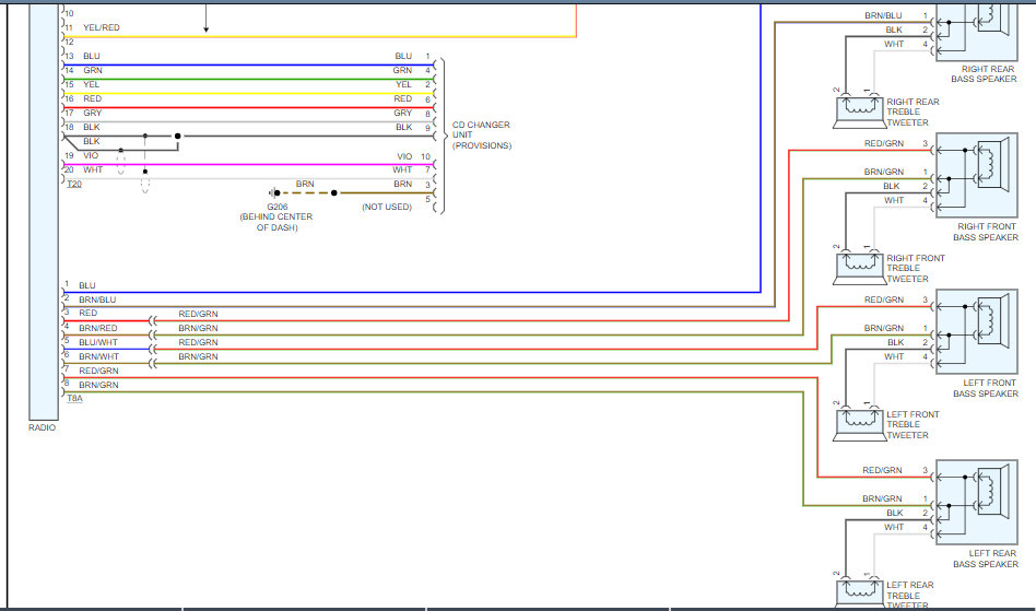

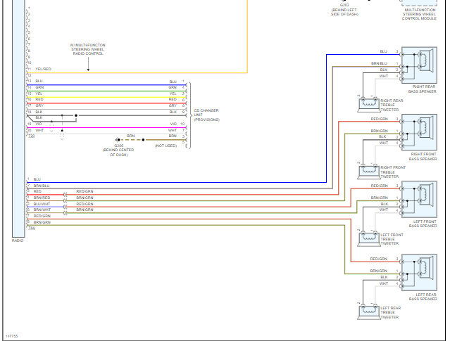

Yes, I've found out that your car does not have the Monsoon feature.The 4 wire speakers are the bass speakers in the bottom of your doors.There are 2 wires for an input and the other 2 wires are an out put for the tweeter speakers in the same door up above. I've attached the wiring diagram in case you're interested below.Would you like me to find a speaker brand replacement for you that is compatible with your car? Hope this helps and thanks again for using 2CarPros.

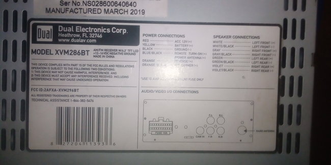

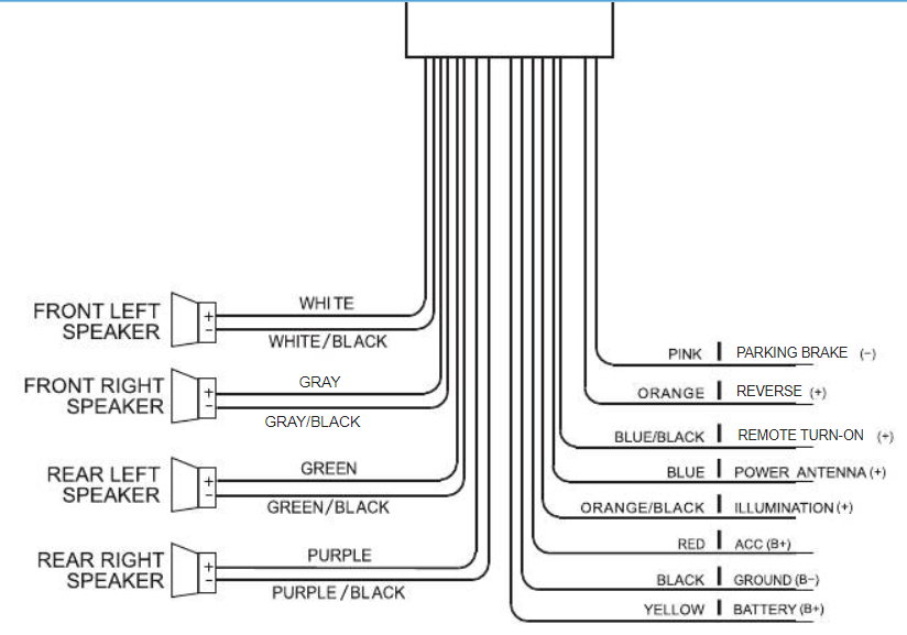

Hi sir, thank you for the diagram. Got another question if you could please? I have an dual Bluetooth receiver # xvm286bt could you possibly help me out to fig out how to wire it up to the car without a wire harness please?? Because i don't have one to connect it together...
Thank you for your time sir..

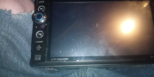

Dual Bluetooth receiver # XVM286BT, Dual is the name of the receiver. An yes the XVM286BT Is the model number.

DANNY L
  • 5,648 POSTS
Hello again,

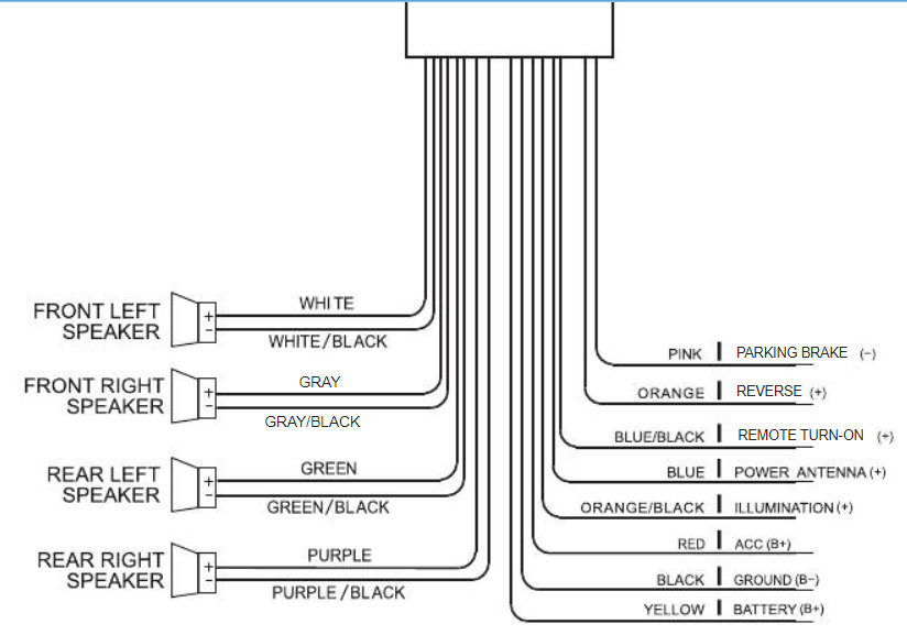

I've attached a picture below of the wiring diagram.Let me know if this helps and if you have any further questions about your wiring.Thanks again for using 2CarPros.

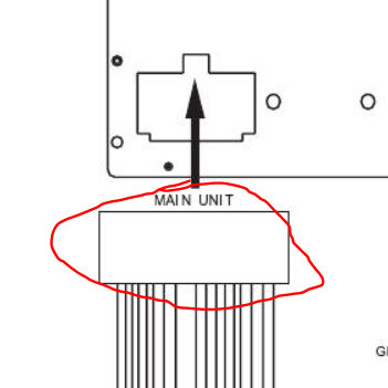

MOUSE357
  • 58 POSTS
Um, sir I'm lost here no disrespect intended.. But I told you the name of the stereo and the model number last night. Then you asked me for the name and if the model number was the model number?? So I sent to pictures of the stereo. I appreciate your help but I already have the wiring diagram in the stereo.... What I was asking was how to wire the stereo to my car without an adapter to wire up and plug it in the wire harness for my car... because I'm not sure how to match the wires up without the other plug??? An once again no disrespect intended thank you for your time and help...

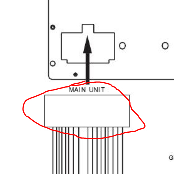

DANNY L
  • 5,648 POSTS
Hello again.
Do you have this plug that came with the replacement radio? I've attached below.Just to be on the same page if you have this plug are you asking how to wire this plug to your existing factory harness? Hope this helps and thanks again for using 2CarPros.

MOUSE357
  • 58 POSTS
Yes sir I have that plug. But not for sure how to connect it to existing harness in my dash without the adapter plug so that everything is wired correctly. Due to having all the electrical and the alarm system.... So nothing short circuits or malfunctions and everything still works... Sorry for the confusion. thank you for your time..

DANNY L
  • 5,648 POSTS
Hello again.

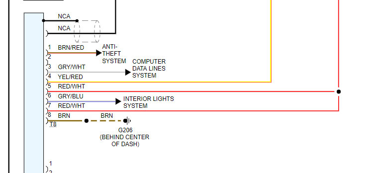

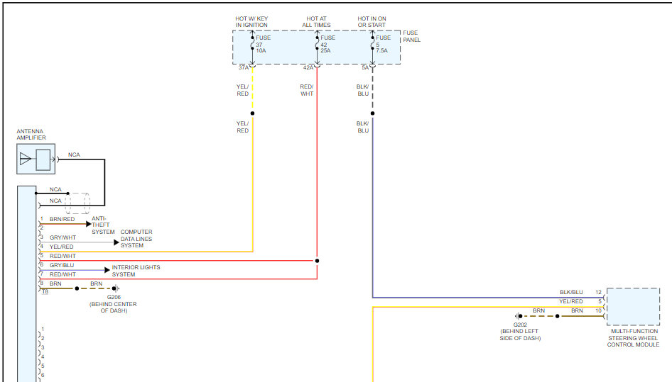

I've attached your factory harness radio diagram below and I'll break this down best I can.The main power wires red,yellow,black,and blue remain the same. Only the speaker wire colors will be different.Here is how they will attach.
New harness colors Your factory VW harness colors
Red- Battery positive Red- Battery positive
Yellow-Battery positive Yellow-Battery positive
Black- Ground Black- Brown
Blue- Amplifier-Power antenna Blue-Amplifier-Power antenna
Orange-Black Illumination Grey-Blue Illumination
Speakers
Left front positive White Left front positive Red-Green
negative White-Black negative Brown-Green
Right front positive Gray Right front positive Red-Green
negative Gray-Black negative Brown-Green
Left rear positive Green Left rear positive Red-Green
negative Green-Black negative Brown-Green
Right rear positive Purple Right rear positive Blue
negative Purple-Black negative Brown-Green
Hope this helps and let me know if you have any further questions about this.Thanks again for using 2CarPros.
