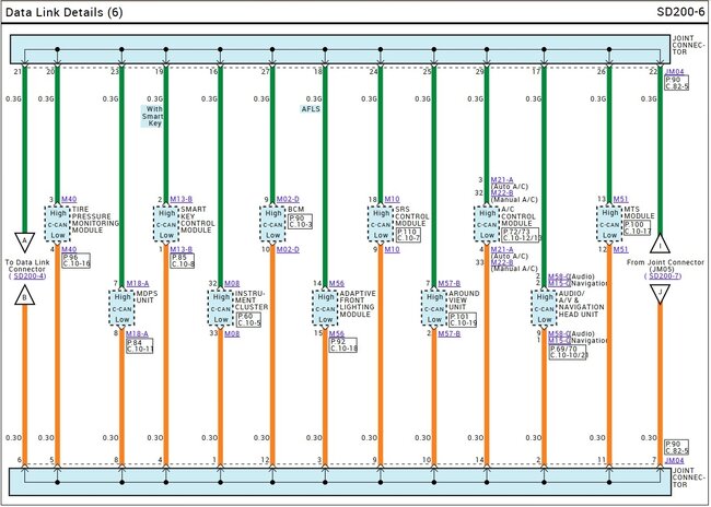

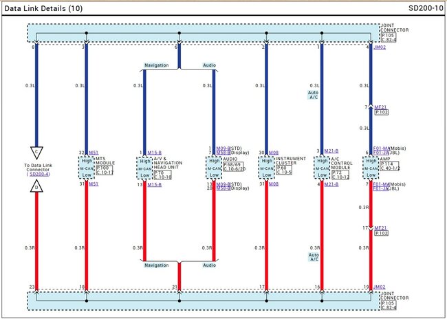

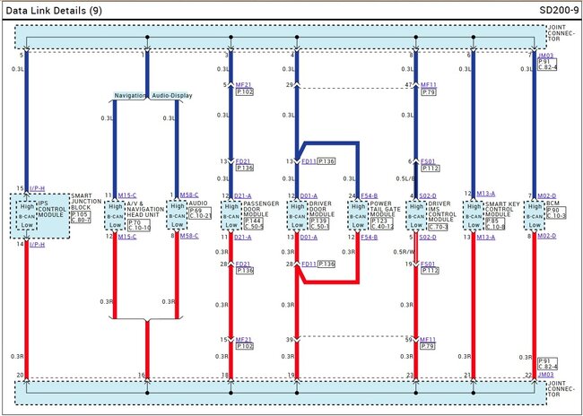

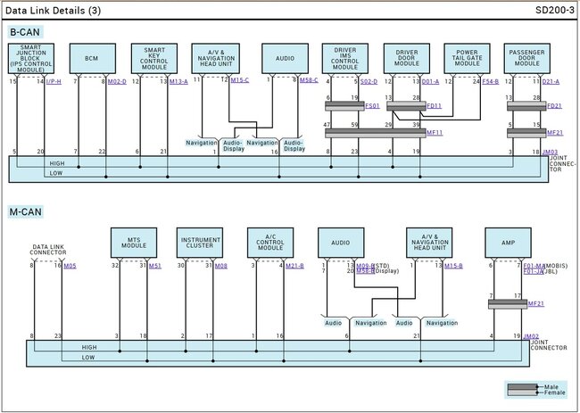

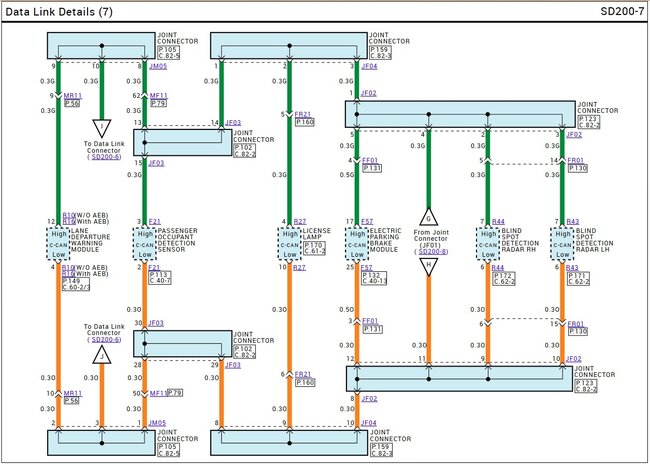

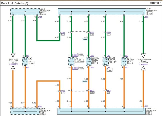

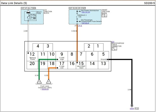

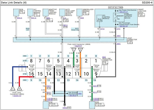

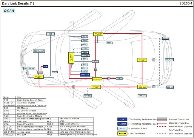

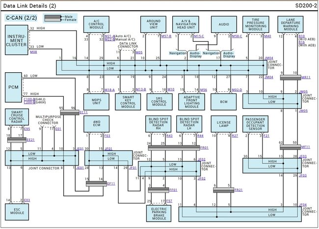

Please to have image of how the modules and places on the network.
like a list of all the modules on the High and low speed Can Bus
5XYZTDLB4HG391081
Dec 9, 2025 at 6:39 AM
STEVE W.
  • 15,423 POSTS
These cover the various networks and interconnects as well as the test connections. However you may not have every module depending on the options and exact model you have. The only way to know that would be to scan it with a scan tool that shows network topography. That would show the modules and connections as well as which modules are active and which have faults. Be careful working on the network, it is usually very fault tolerant but can be damaged.
