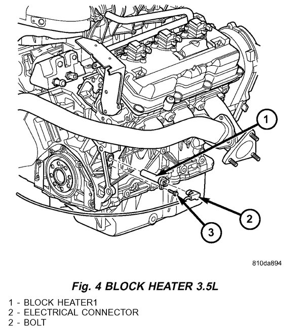

I'm trying to locate the block heater plug if there is one on this vehicle.

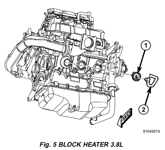

Location is based on which engine you have. The first picture shows it on the 3.5L. Picture 2 shows it on the 3.8L.
Let me know if this helps.
