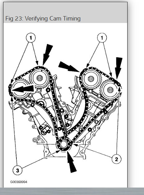

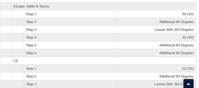

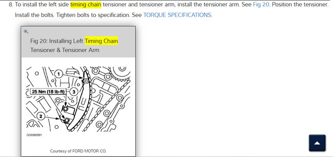

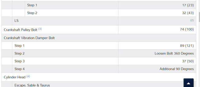

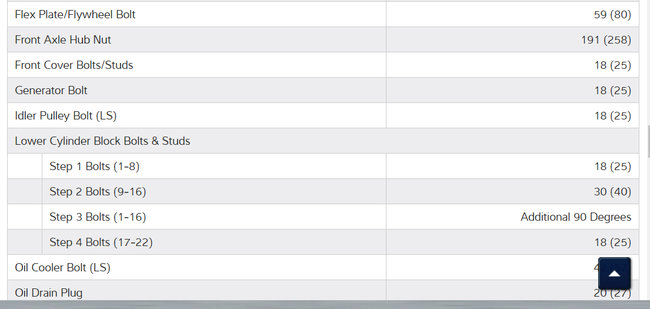

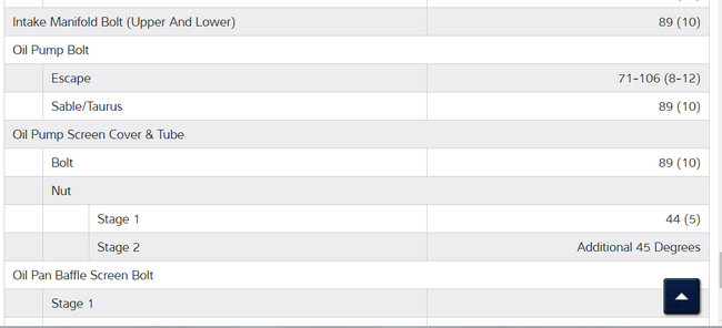

torquing order for the bolts and the proper way to do the timing belt
2001 FORD ESCAPE
18,090 MILES • 3.0L • 6 CYL • 2WD • AUTOMATIC
BANTONIO

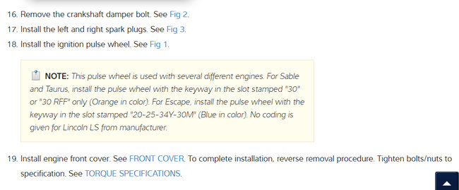

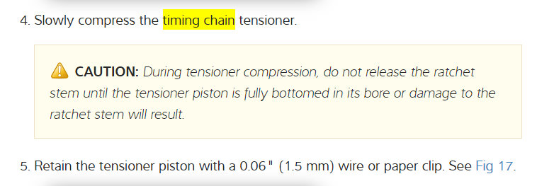

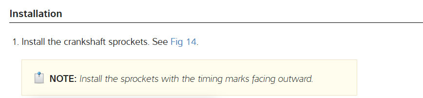

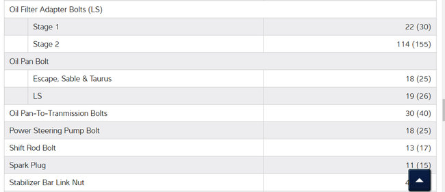

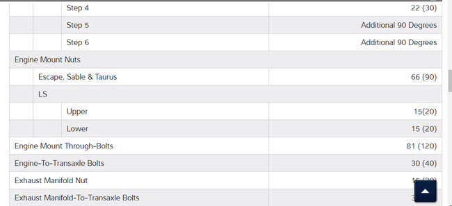

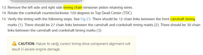

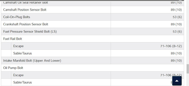

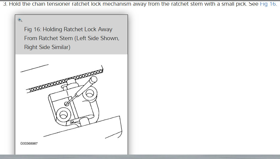

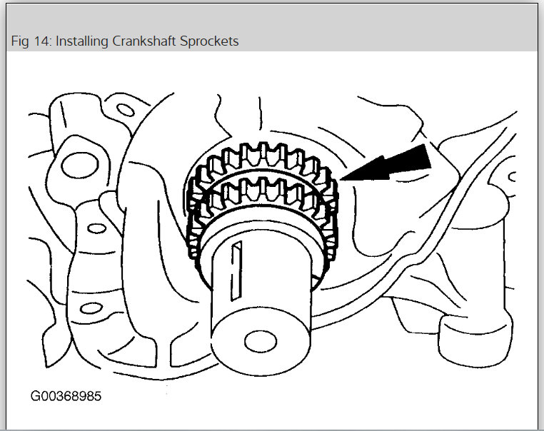

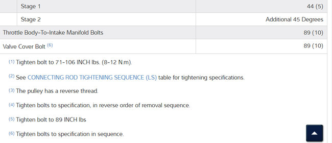

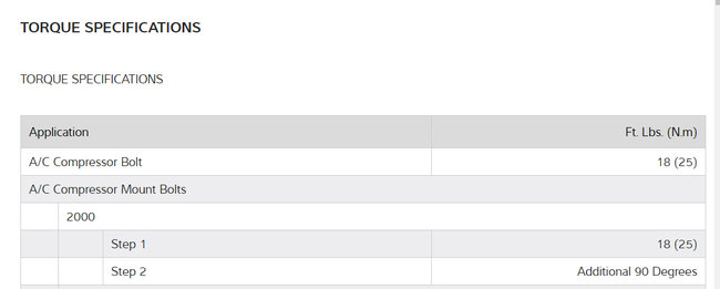

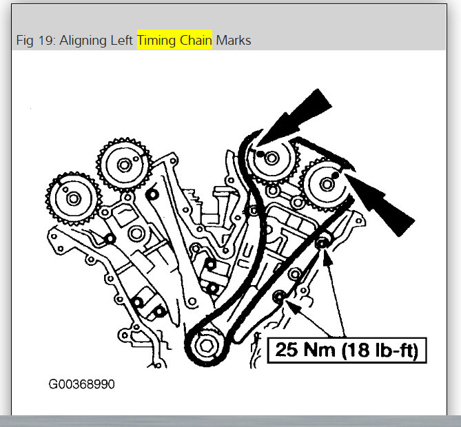

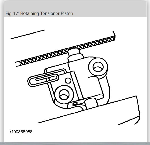

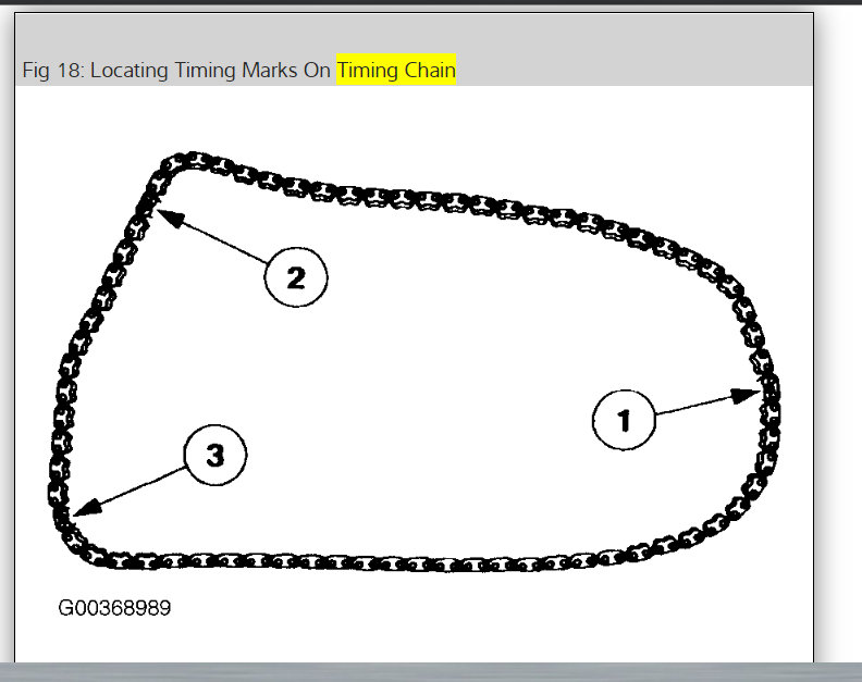

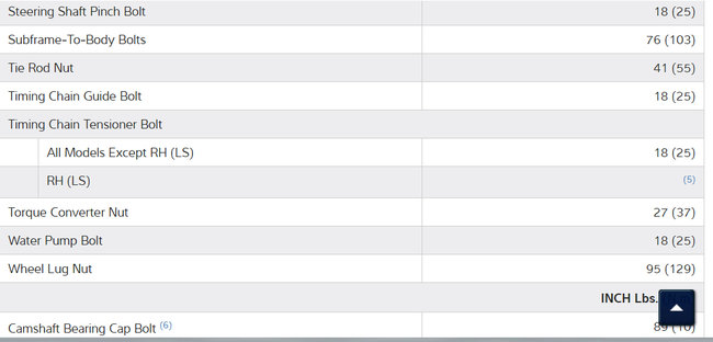

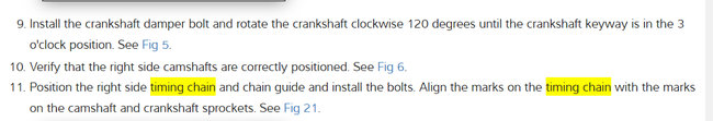

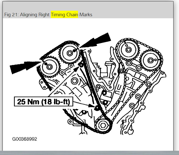

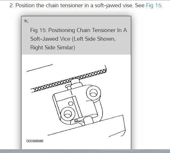

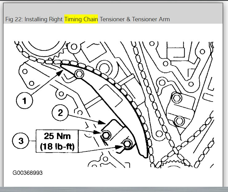

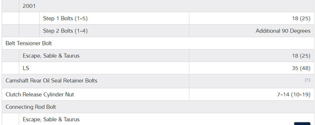

I’m putting the engine back together I need the order of torquing the bolts and the proper way to do the timing belt. thank you
Apr 12, 2019 at 8:33 AM
SCGRANTURISMO
  • 4,897 POSTS
The information that you requested is in the diagrams down below. Please, feel free, if you have any other automotive questions to ask. That is what we are here for. Go through the information and get back to us with how it turns out.
Thanks,
Alex
