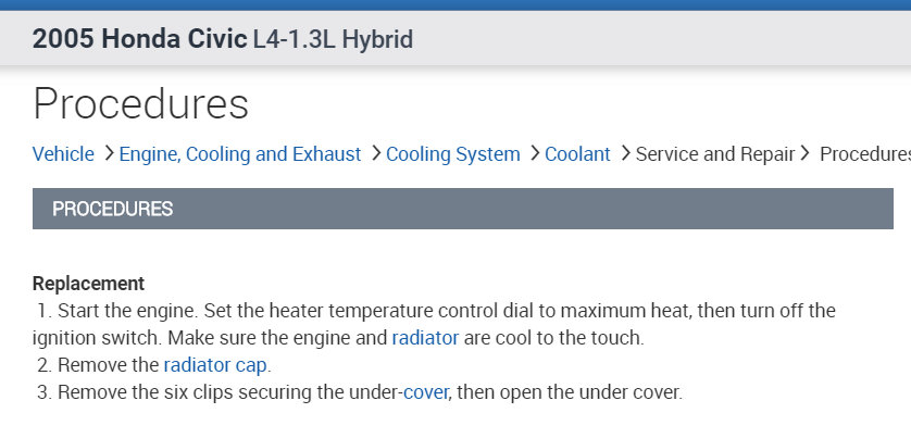

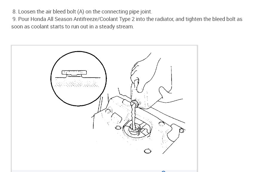

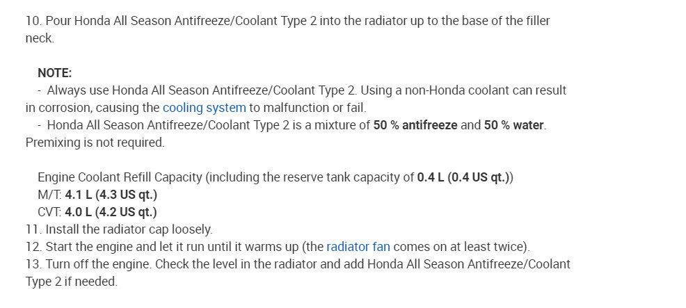

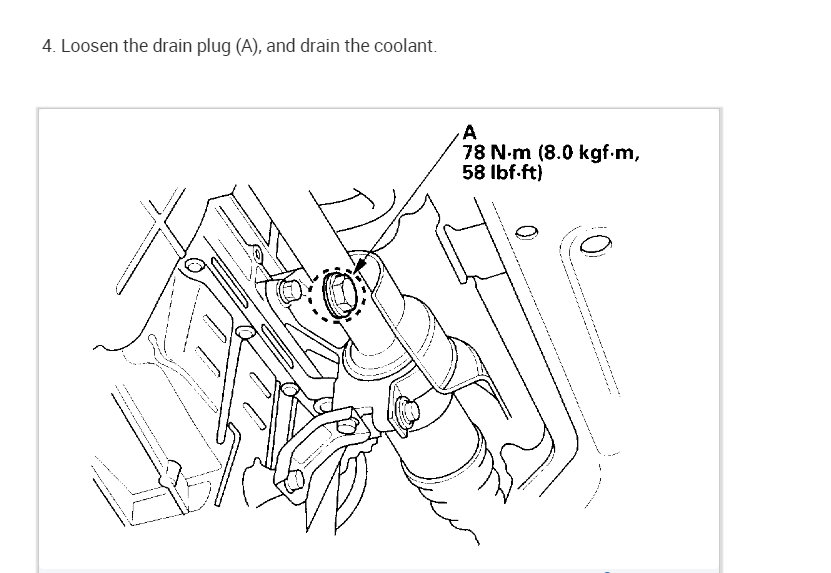

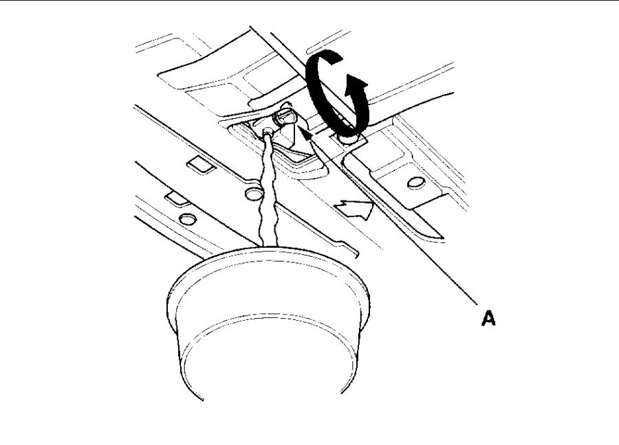

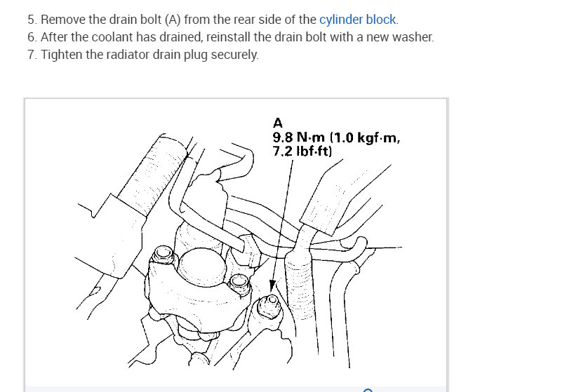

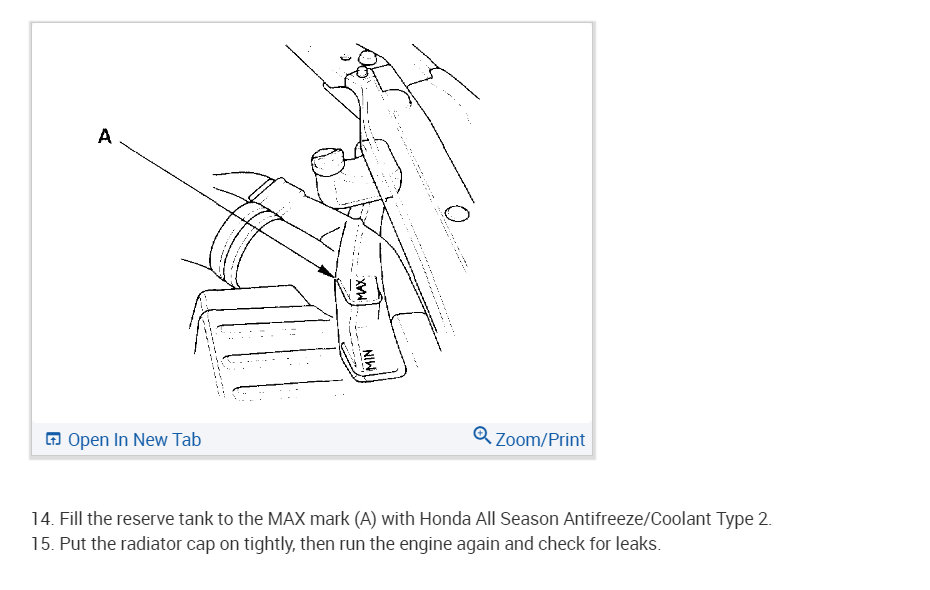

Coolant exchanger only draws out less than half capacity. Where is the block drain plug located in order to get the rest of the coolant out? Have distilled water in block after flush. I have 50/50 mix and can't dilute it more so have to drain the block first I guess.
Sep 21, 2019 at 7:31 AM
SCGRANTURISMO
  • 4,897 POSTS
In the diagrams down below I have included the procedure form the vehicle manufacturer on how to drain and refill your vehicle's cooling system. Please go through this guide and get back to with how everything turns out or if you should have any other questions for us.
