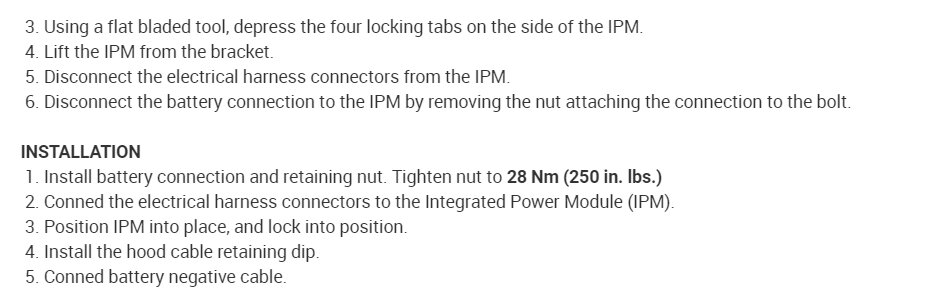

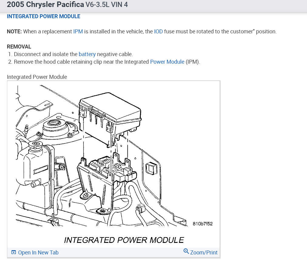

Yep, the integrated power module goes out all the time in these vehicles, to be sure we should do a CAN scan which is easy. You can get a CAN scanner (Controller Area Network) which will work on most cars from Amazon.
here is a video to show you how:
https://youtu.be/u-4syLc-ifQ
Here is the location of the IPM and how to change it out in case you need it. Check out the images (below). Please let us know how it goes.

Thank you for your response. Question, I tested the fuses (but not relays) within the IPM, and they had power. Is this possible when the IPM goes on the fritz? Also, I forgot to mention, that I plugged a tested code scanner into the diagnostic wire connector three times and it was unable to connect, and I know it was working last month when I had the car inspected.
