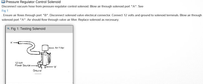

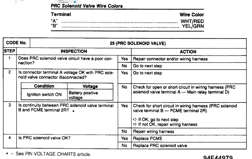

dash light blinks five (5) times, hesitates and then blinks two (2) more times. Can't find info on that particular code.

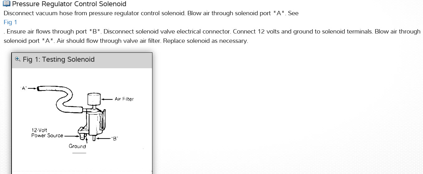

see pics the code is probably 25 and not 52
