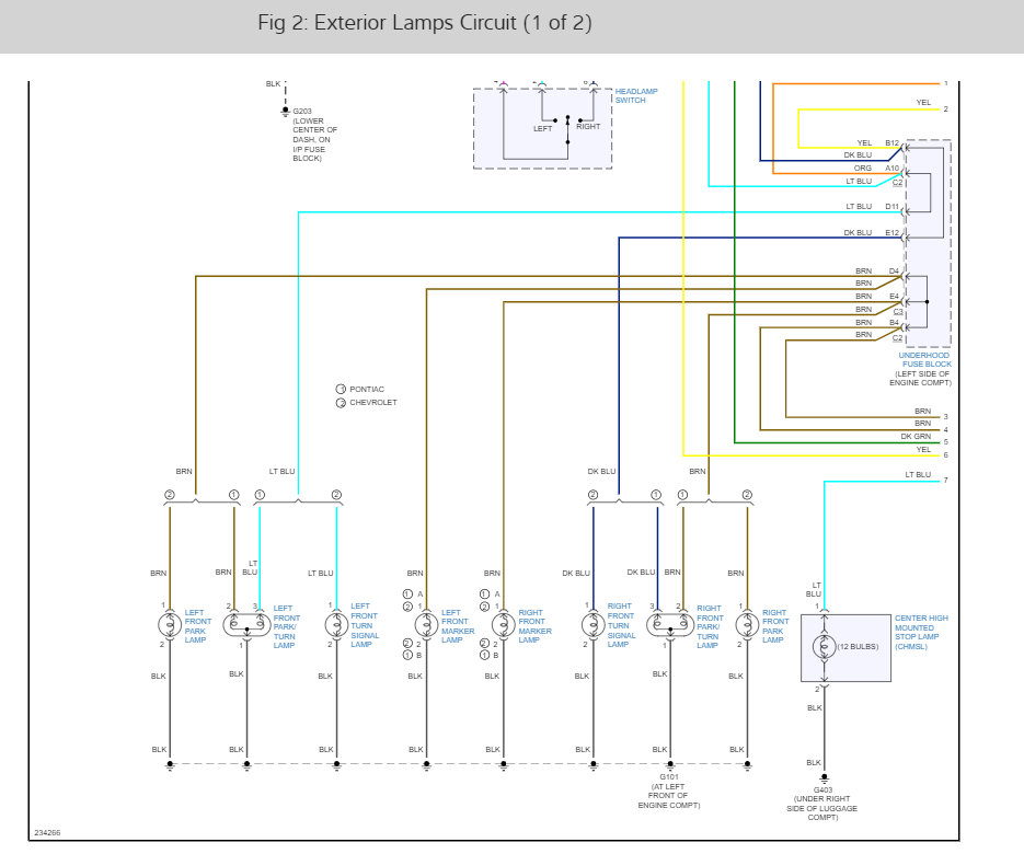

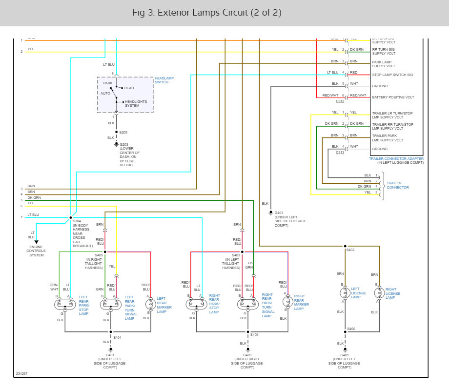

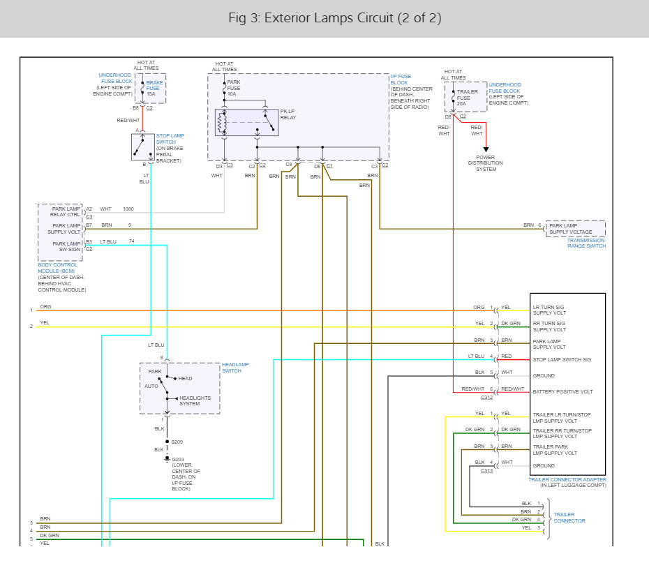

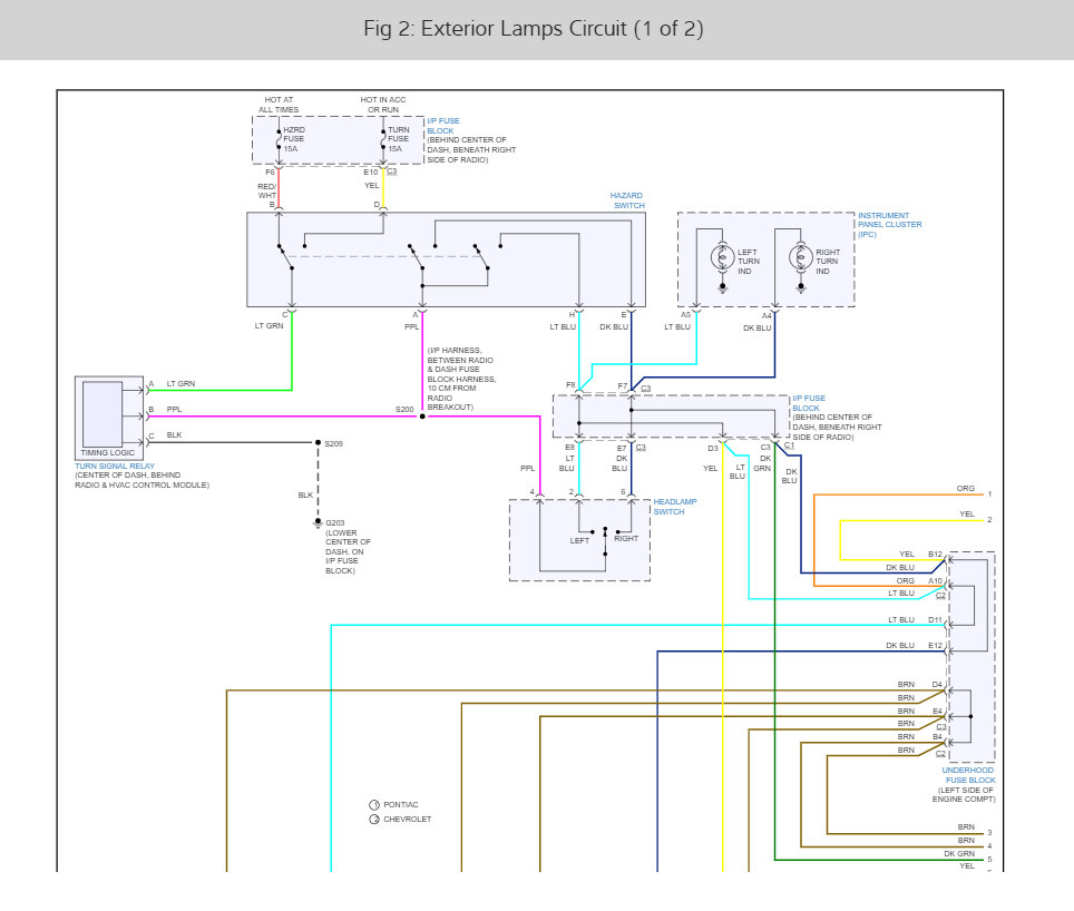

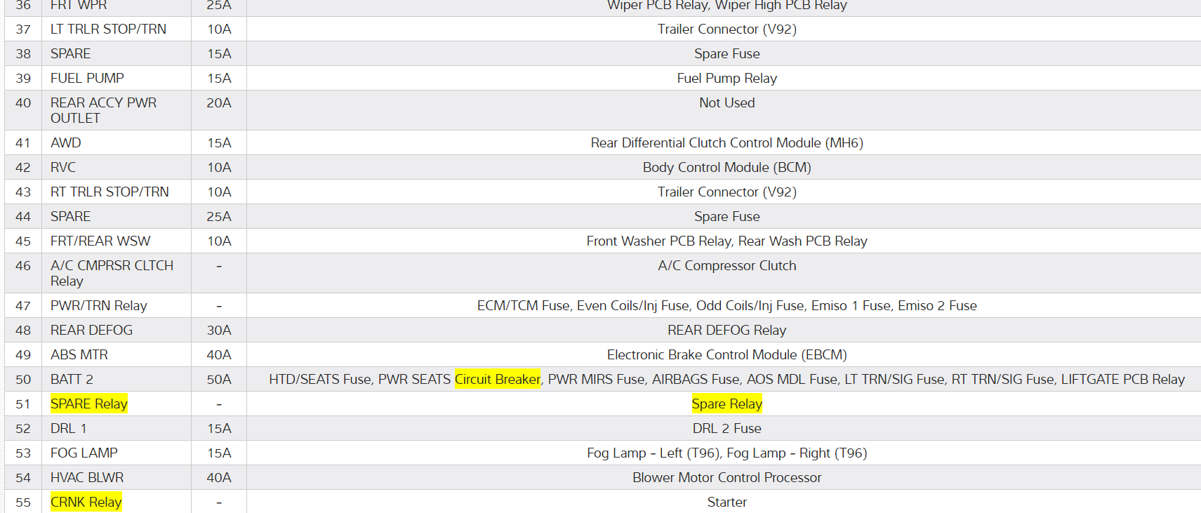

My blinkers stopped working. changed relay, blinker switch,fuse and bulb. what else could be wrong?
May 18, 2021 at 4:17 AM
  • 55,743 POSTS

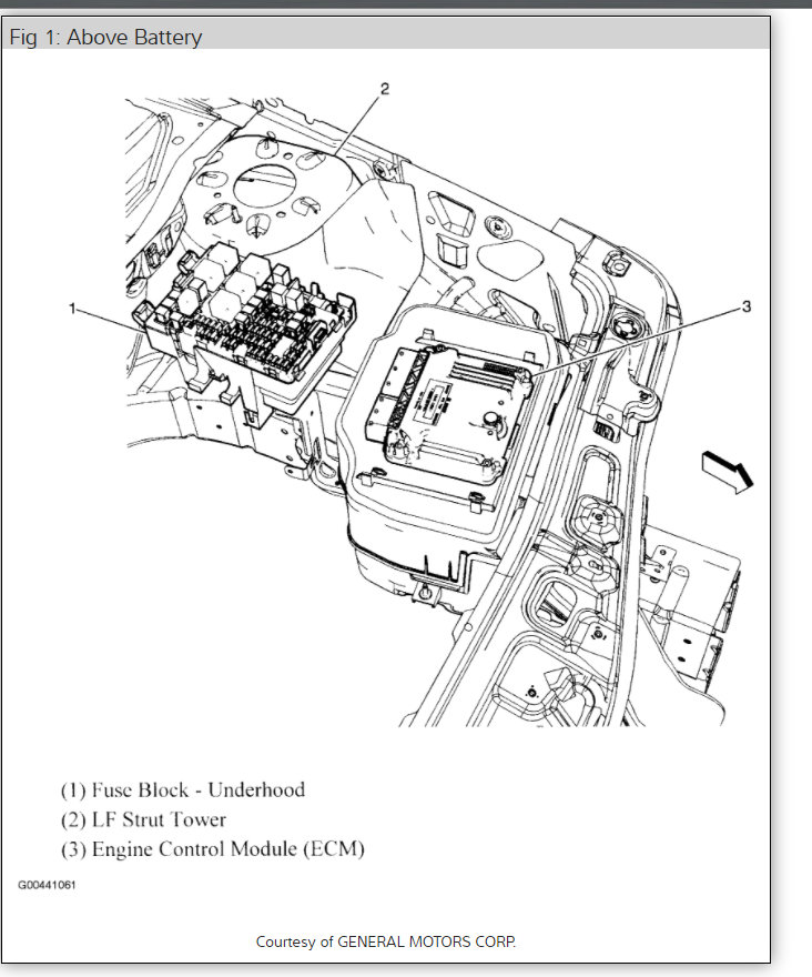

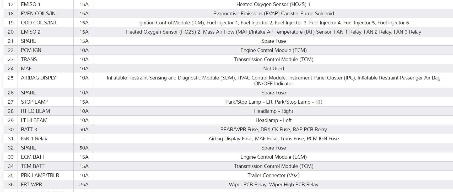

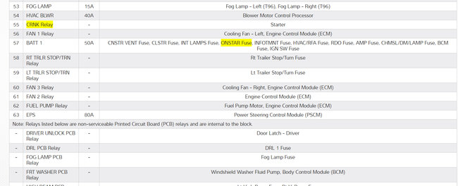

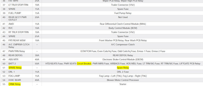

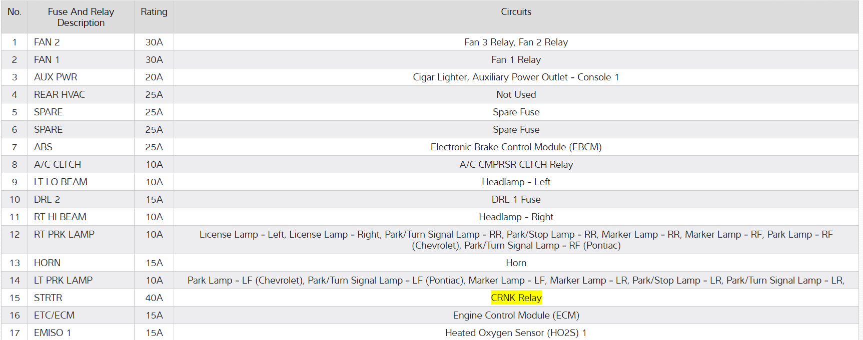

Lets check for power at the turn fuse in the under dash fuse panel. here is a guide to help you with the fuse location I have also included the turn signal wiring diagrams so you can see how the system works. This guide can help as well:
https://www.2carpros.com/articles/turn-signals-not-working-blinker
and
