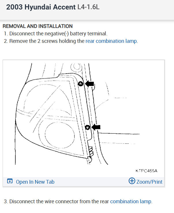

So, all of a sudden, I turned my blinkers on a I didn't hear them clicking or lighting up. But my brake lights and headlights and hazard lights still worked. I checked the fuse, and the fuse was blown so I put another one in same size 10a and as soon as I turn the blinker on it pops again. How can I fix this?
Dec 5, 2024 at 2:54 AM
  • 55,628 POSTS

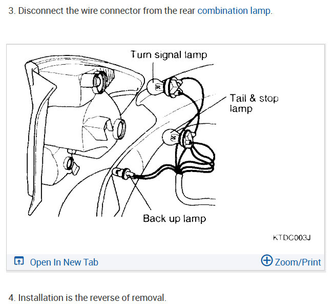

Yep, this is usually because the bulbs or sockets in the rear of the car get melted. Here is a guide to help and I have included how to remove the bulbs for inspection for your car:
https://www.2carpros.com/articles/turn-signals-not-working-blinker
Check out the images (below). Please upload pictures or videos in your response of any problems so we can see what to help you with.

But my brake lights work.
Dec 5, 2024 at 8:37 AM
  • 55,628 POSTS
Okay, I would look at the front blinkers then, they can have water damage and rusted. The bulbs are the most popular place to have a shorted circuit.
