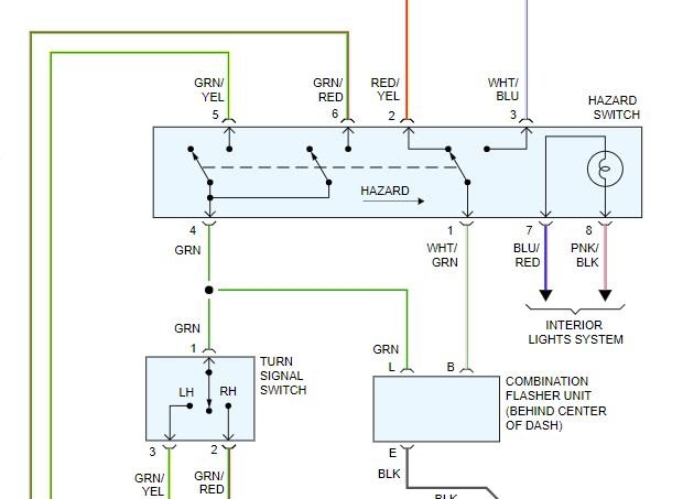

I replaced the heater core in my vehicle today, now the blinkers don't work. i unhooked the emergency flashers to move away console in front of dash. could that be the problem?

If you disconnected the emergency flashers and didn't reconnect them, that is the problem. Power goes through the signal switch, through the hazard switch and to the lights. I attached a schematic for you to see.
