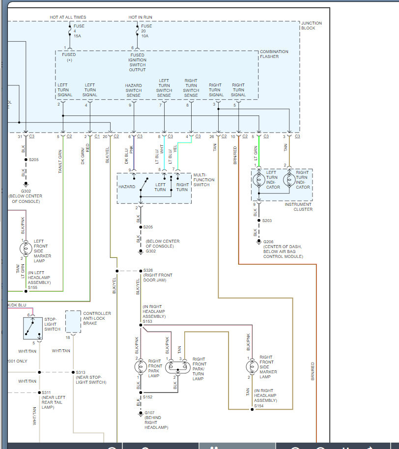

New tail light assemblies with good bulbs and new sockets. Blinkers still do not work. Relay problem? Any suggestions?

This is normally one of two issues. Either a blown fuse, or a flasher issue.
We are going to have to use a test light to find out where the issue is. I would suggest starting with checking power directly out of the fuse box that is shown in the diagram below.

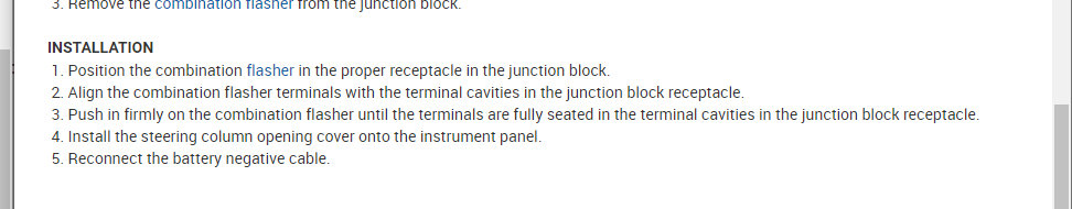

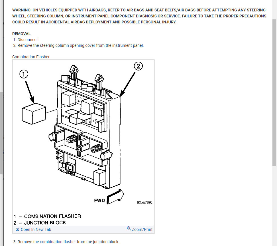

Also, here is a guide that will help with testing and replacing fuses and relays:
Below is the wiring diagram that we need to use to test for sure what the issue is but if it is the relay, I included the process for that as well.
Let us know if you have other questions. Thanks
