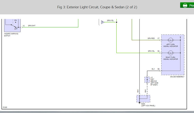

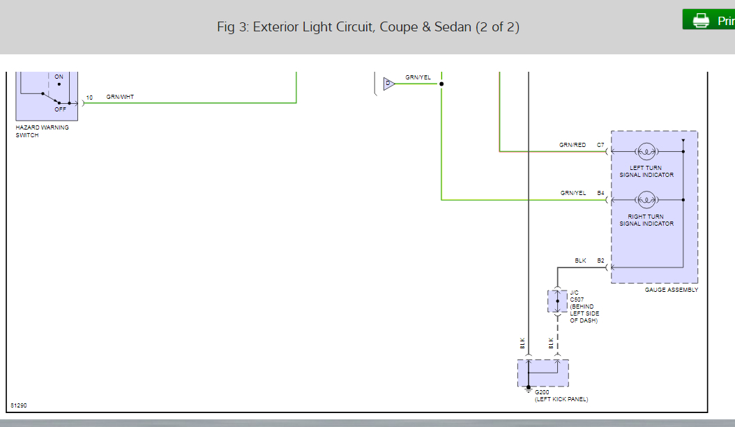

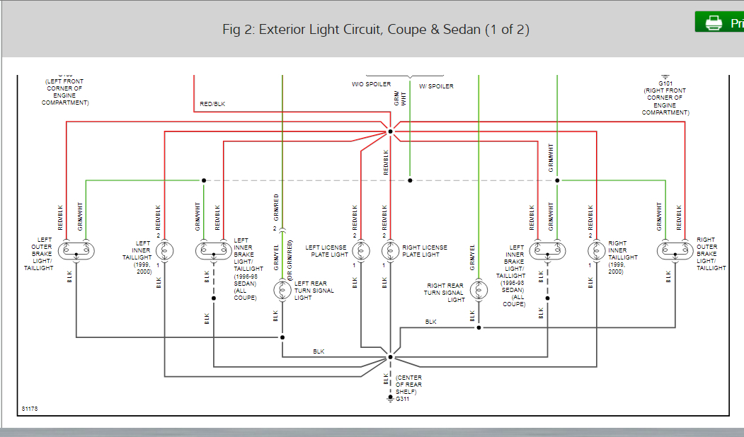

blinkers and lights not working properly
869,919 MILES • 2WD • MANUAL
POOTO

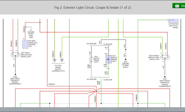

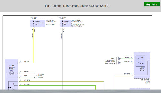

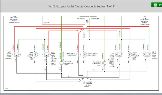

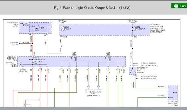

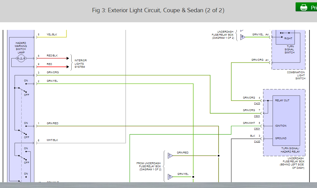

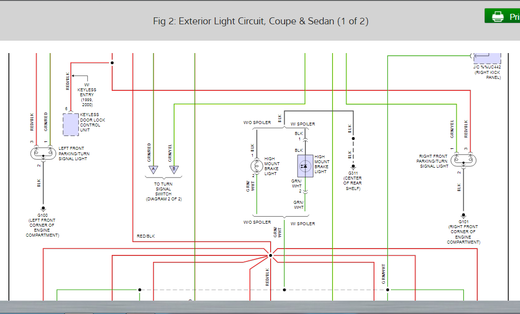

When brakes applied front left blinker starts, and when brakes not applied anymore it stop.
Back left blinker blinks but weak, the brake lights blinks as well with the blinker.
My front lights sometimes don't turn off when car is turned off.
May 5, 2019 at 10:34 AM
SCGRANTURISMO
  • 4,897 POSTS
This sounds to me like you might have a short circuit between the brake light circuit and the turn signal circuit. I have included for you in the diagrams down below a complete set of your vehicle's exterior lighting wiring diagrams. Please go through them and get back to us with what you are able to figure out, please.
