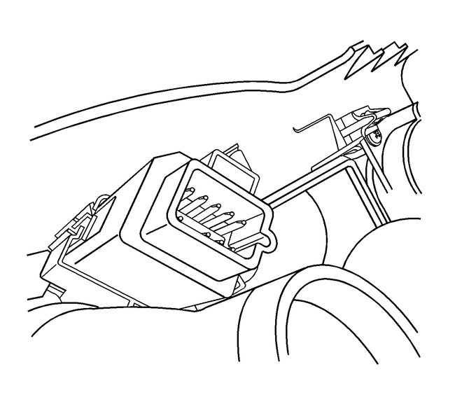

My blinkers and flasher all of a sudden stopped working. They don't blink inside nor out. I've been doing some research and I believe it's the signal relay? But still can't seem to find that. I've checked the fuses and relays under the hood and in the instrument panel fuse block and all is good there. Can someone please explain to me were the signal/flasher relay thingy is?
Mar 5, 2019 at 8:02 PM
  • 110,194 POSTS
The signal flasher is part of the hazard switch. Here are the directions for replacement. The attached pictures correlate with these directions.
HAZARD AND TURN SIGNAL FLASHER REPLACEMENT
REMOVAL PROCEDURE
1. Remove the instrument panel (I/P) center trim bezel.
Picture 1

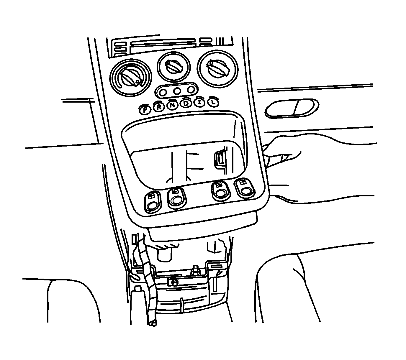

2. Remove the screws that retain the hazard and turn signal flasher switch to the I/P center stack. Remove the switch.
Picture 2
3. Disconnect the electrical connector from the hazard and turn signal flasher switch.

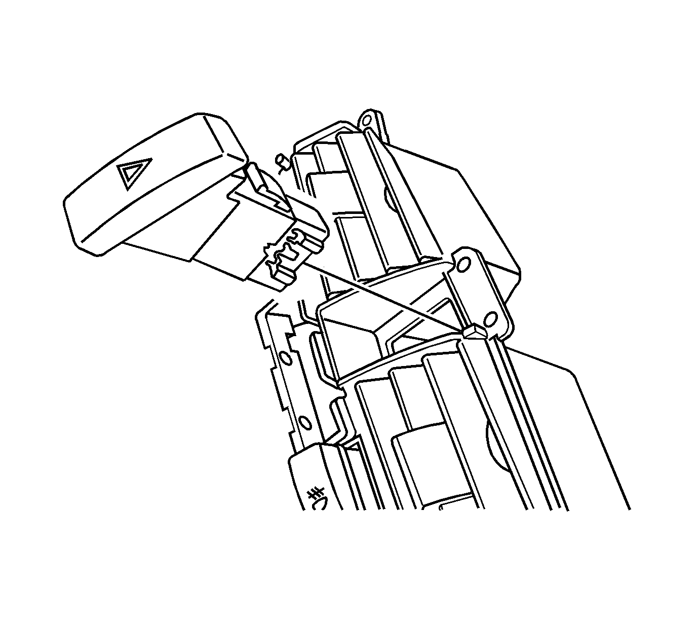

INSTALLATION PROCEDURE
Picture 3
1. Align the switch with the trim bezel and fasten in place.
NOTE: Refer to Fastener Notice in Service Precautions.
Tighten the screw to 2.5 N.m (22 lb in).

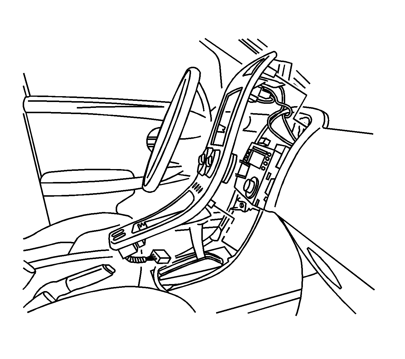

Picture 4
2. Connect the electrical connector to the hazard and turn signal flasher switch.
3. Install the I/P center trim bezel.
4. Test the flasher switch for proper operation.

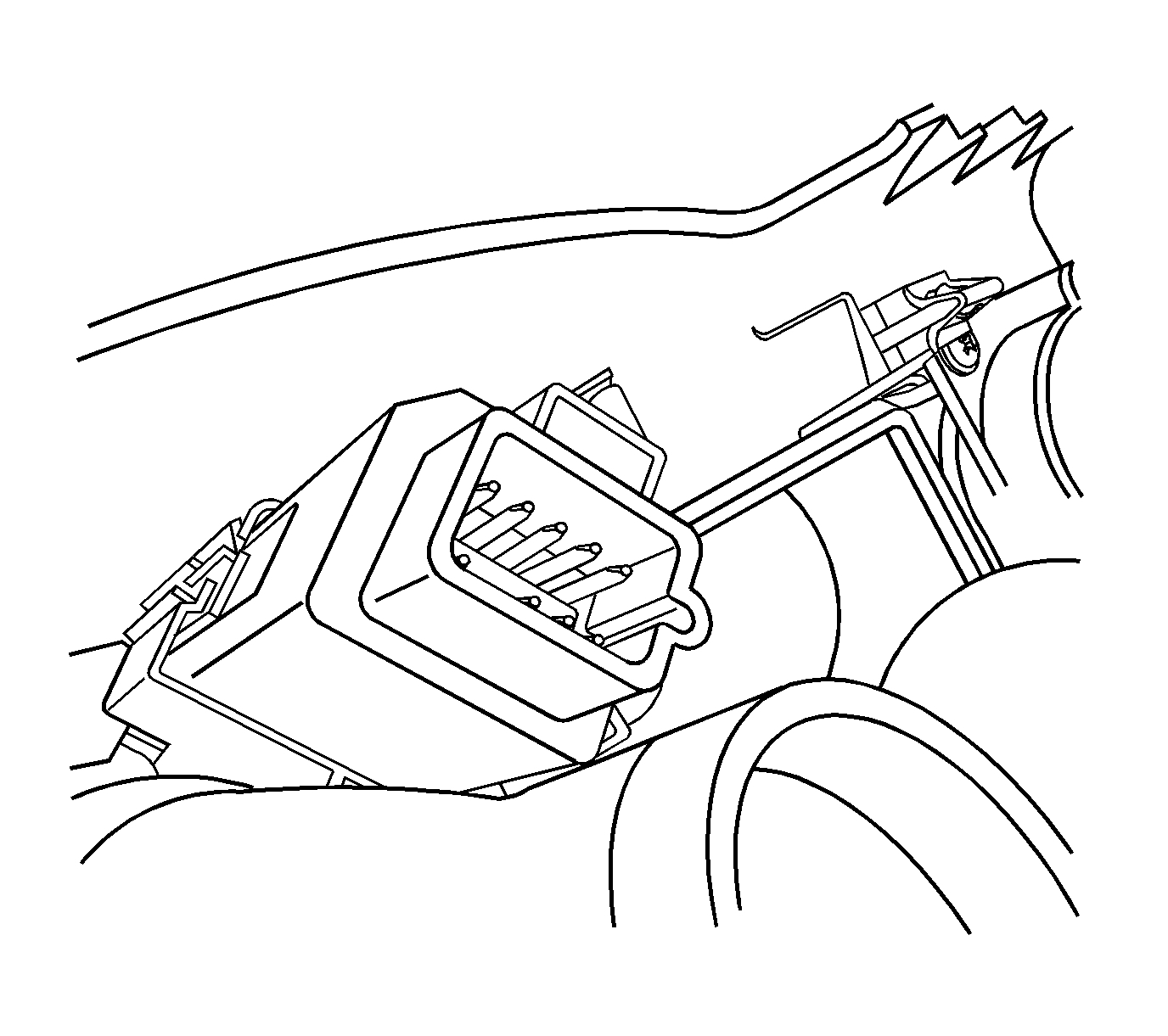

Here are the directions for removal / replacement of the center instrument panel bezel. The remaining pictures correlate with these directions.
TRIM BEZEL REPLACEMENT - CENTER
REMOVAL PROCEDURE
Picture 5
1. Starting at the bottom, pull to disengage the trim bezel clips.
2. Disconnect the electrical connectors from the center trim bezel.

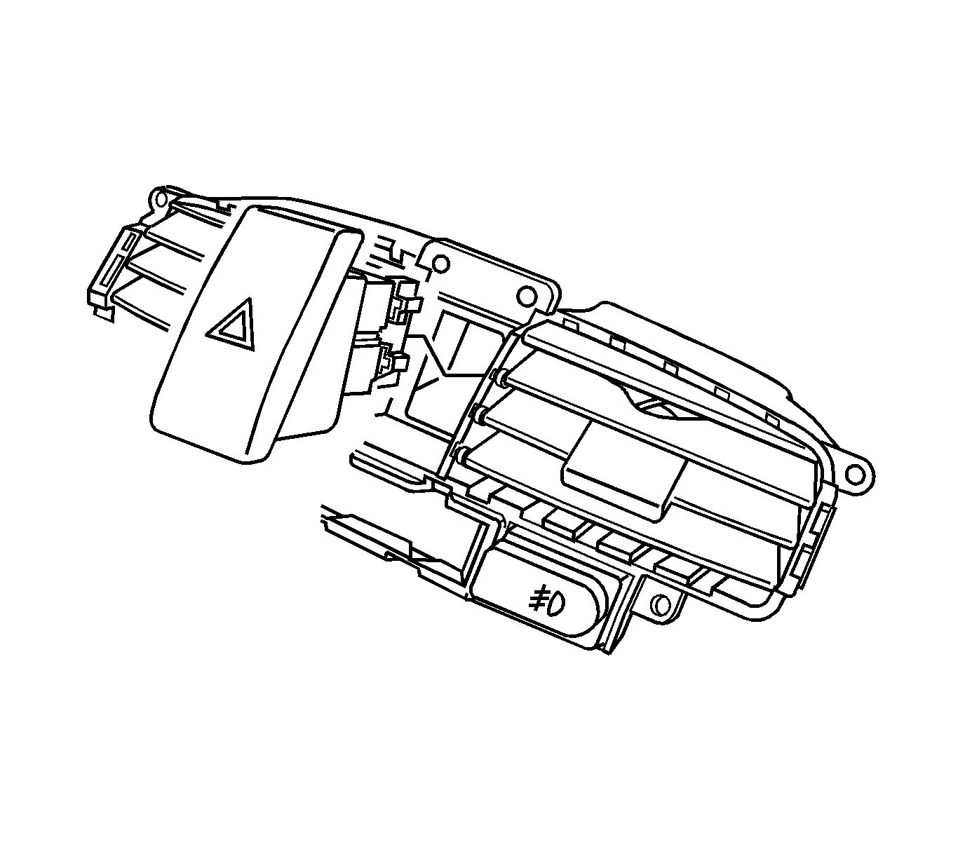

Picture 6
3. Remove the center trim bezel from the vehicle.
