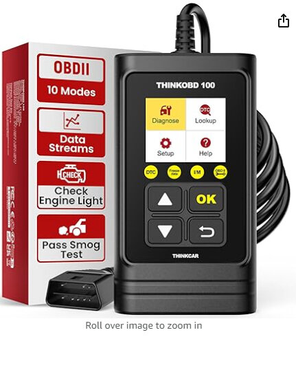

Well, I got it today and scanned it and there were no DTC issues. Any other ideas?

Can I ask which scanner you have?

it is THINKOBD 100.

right here.

Yep, it says CAN but it does not do it. please read these:
https://www.amazon.com/product-reviews/B083F65T8Q/ref=acr_dpx_hist_1?ie=UTF8&filterByStar=one_star&reviewerType=all_reviews#reviews-filter-bar
Here is the one we recommend:
https://amzn.to/3ZYCA1P

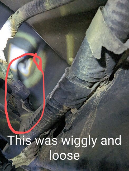

Okay, so here is the current update. Sorry it took so long but I ended up crawling under the truck and following the wires. I found some wires around the spare tire. I wiggled the wires and now it's working normal again.

I would lower the spare tire to see if the wiring harness is catch up or rubbed through. If you find damage can you please upload an image?

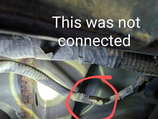

These are the 2 things I messed with. They both are against the side beam.

Thanks for the images :) I don't see that being plugged into anything?

yeah, i have no clue what that goes to, but it's a log wire with a lot of slack.

Also, i forgot to mention that i replaced fuse 72 - Auxiliary power point (Rear). that brought power to the back, but the blinkers were still on speed. then i went down and moved those wires and bam everything is working now.

It sounds like a bad connection inside the harness, or you have a loose ground at the rear of the truck near where you are moving the harness around.

Okay, sorry, it took so long but i was able to unplug the connector to the hitch/rear bumper sensors and that seems to have fixed the issue and not the rear sensors don't work but the lights work in the rear. so, i am counting this as a temporary win.
