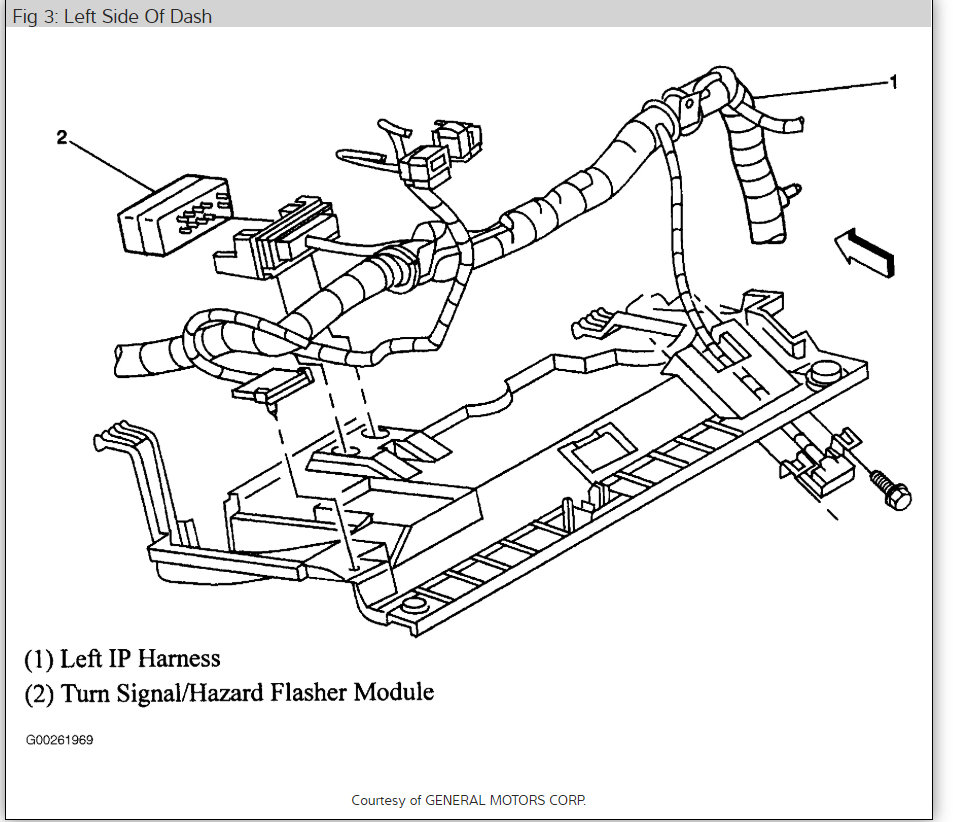

Blinkers not working. No light on, nothing. Replace turn signal and relay. Any ideas? Bernie

Okay thanks. Replaced relay with is behind radio. Where is flasher? Probably next to relay?
+1
Saturday, August 25th, 2018 AT 5:43 PM
WHSW2002
  • 9 POSTS
You will need to check a repair manual (physical copy or online) to find the location of the flasher in your vehicle. Mine is under the dashboard on the driver side.

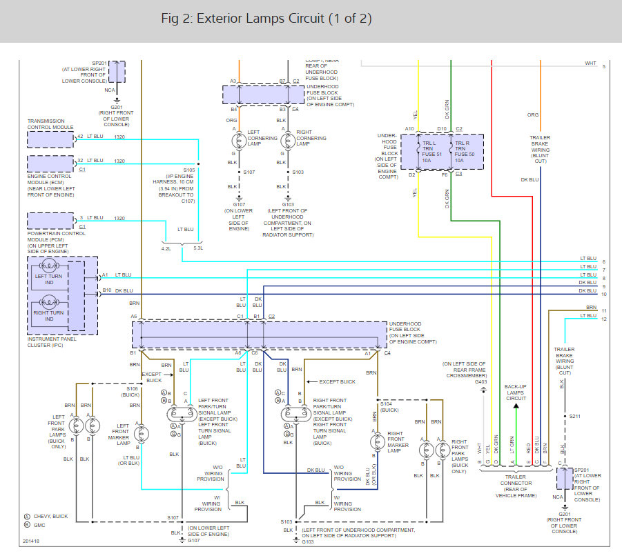

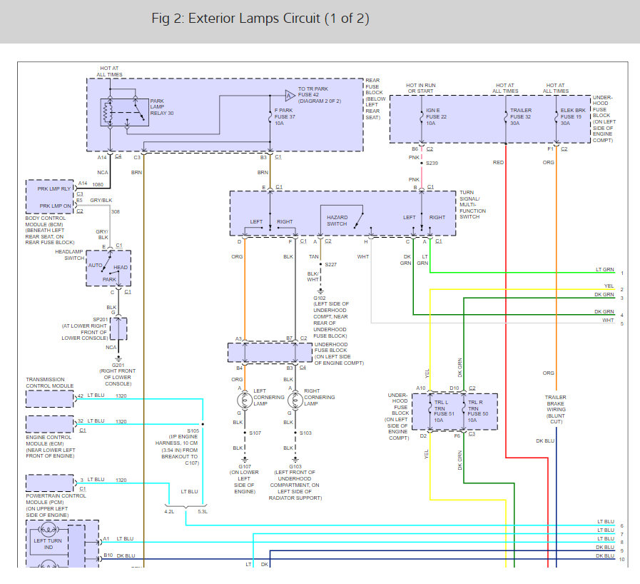

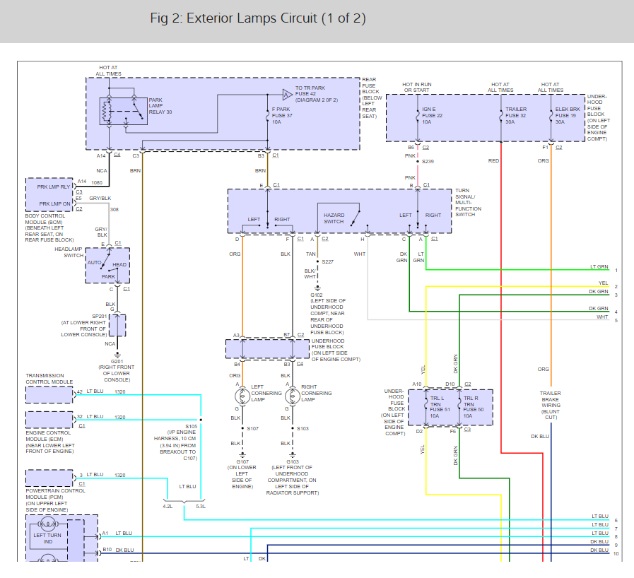

Here is the location of the flasher module and the blinker wiring diagrams to help you see how the system works. Here is a guide to help you check to see if you are losing power somewhere:

I pulled the cover down under dash where I think they say flasher is. But it is not there. My power steering pump and some wires.
Sunday, August 26th, 2018 AT 5:36 PM
KEN L
  • MASTER CERTIFIED MECHANIC
  • 47,513 POSTS
It should be there but it up high under the dash (hidden) use a flashlight to help.
Monday, August 27th, 2018 AT 10:27 AM

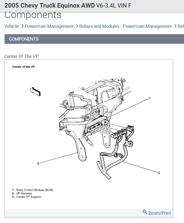

Today it started with not shifting into high gear. Also all dash lights came on and with turn signals not work in thinking it is a computer problem maybe BCM or ECM not sure.
Tuesday, August 28th, 2018 AT 10:51 AM
KEN L
  • 47,513 POSTS
Hmm, maybe it is related. It can be the BCM causing the is issue. Lets remove the BCM electrical connectors to check for corrosion. Sometimes just removing and replacing the connector helps solve the problem. Here is the location.

It cooled to 92, lol. Checked BCM connections looked good, but have no way to check board out looks good no burns or anything like that also flasher is. Also the relay changed that. What you think my friend? Blessings, Bernie
