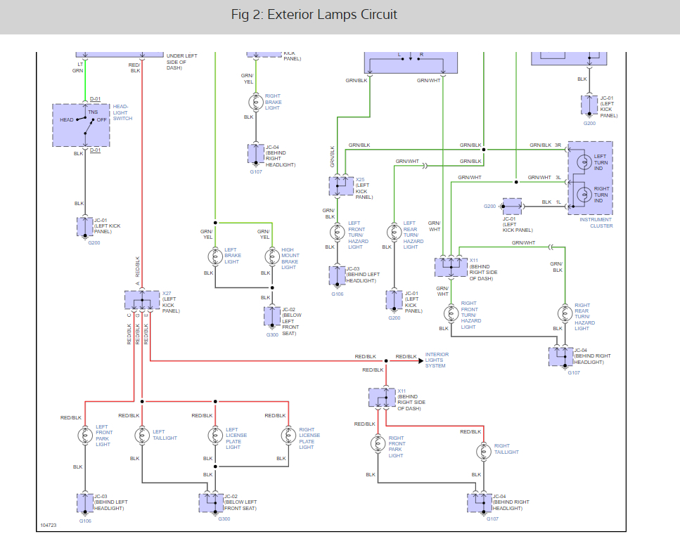

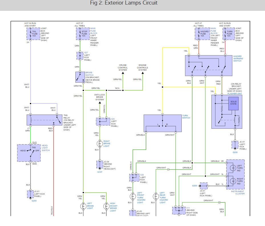

My blinker lights don't work now. It starts at the switch. I hit the switch down and nothing. No signals on the cluster board either side I switch it to. But my hazards work just fine.

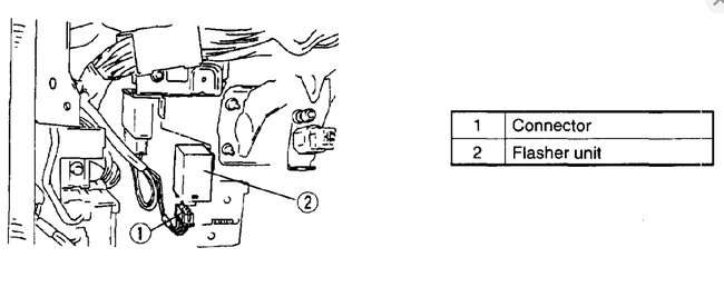

I would check the fuses first and if they are okay it sounds like the turn signal flasher relay has gone bad. here is the blinker wiring diagrams so you can see how the system works and I have included a guide to show you how to check for power and the blinker flasher which is under the dash on the driver's side in the diagrams below.
Check out the images (below). Please let us know what you find. We are interested to see what it is
