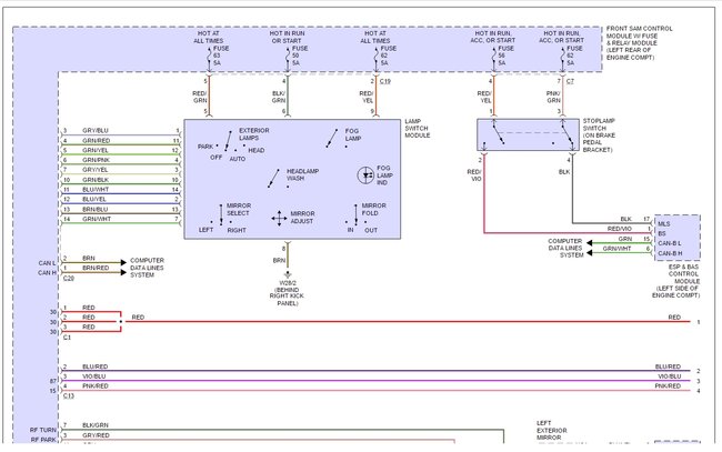

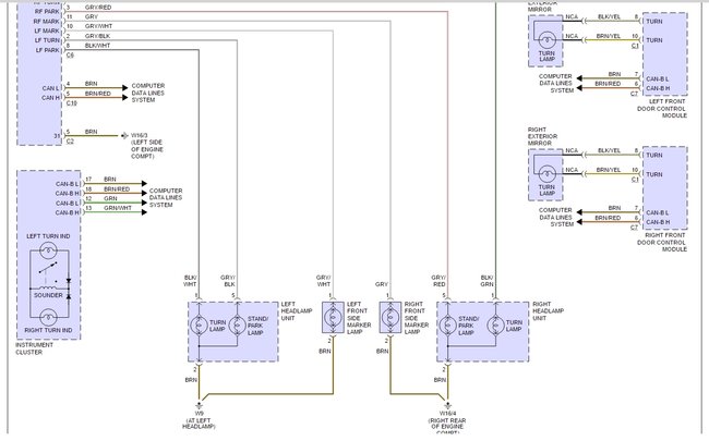

My blinkers work, but they do not stay blinking. If i press my left or right turning signal it will show for a second and it will just go away, it wont stay blinking. I would like to know what i have to do to fix that?

It looks like it could be a fuse or a the SAM module which controls the lighting. Please check all of the fuses.
Its could be the turn signal switch itself as well, here is a video and how to change yours. I just did one on my wifes car.
https://youtu.be/pLDjYWv-ApQ
https://www.2carpros.com/articles/turn-signal-switch-replacement
Here is a wiring diagram and a guide on how to do it.
Please let us know what you find so it will help others.
Best, Ken
