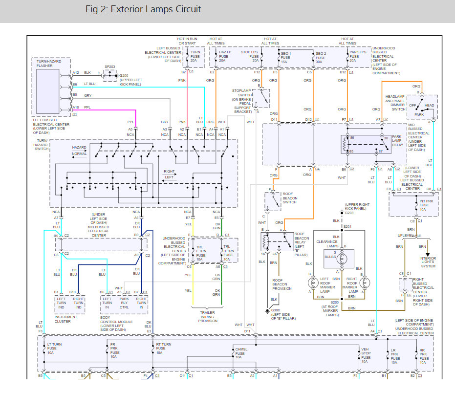

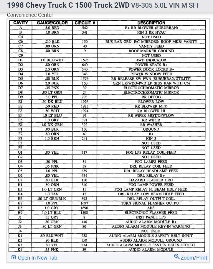

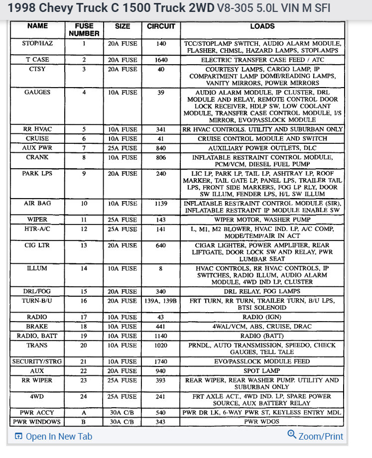

Turn signals won’t work but the hazards do.
May 19, 2021 at 6:23 PM
  • 55,286 POSTS

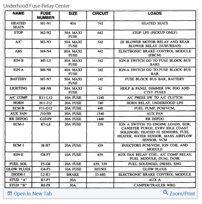

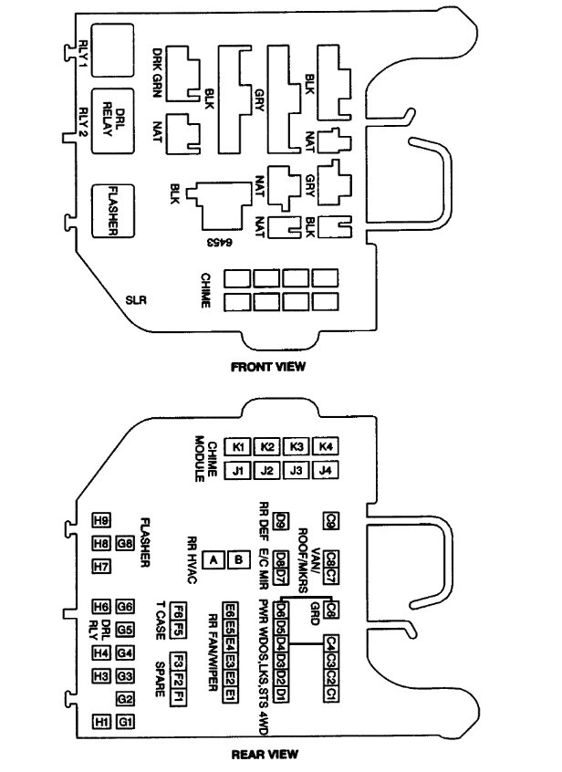

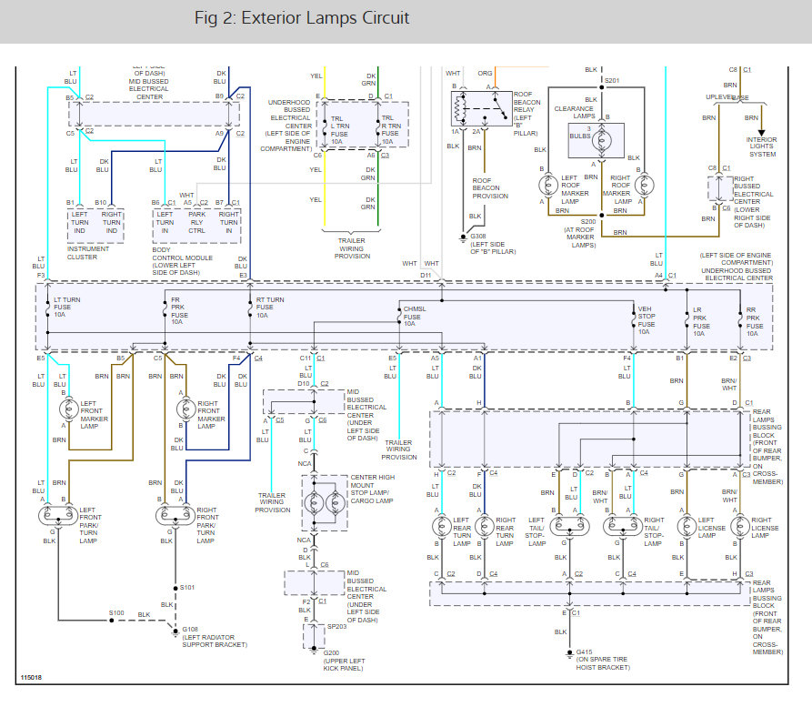

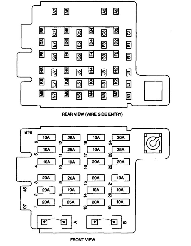

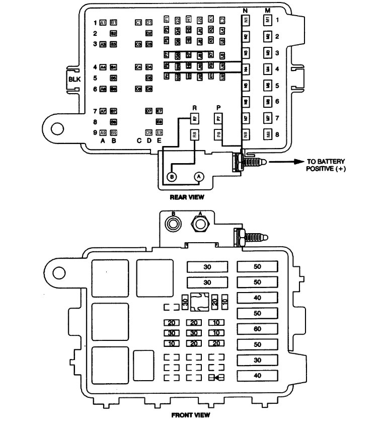

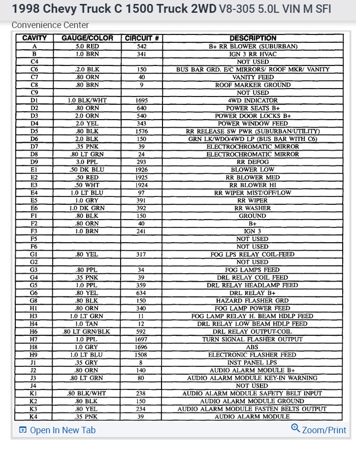

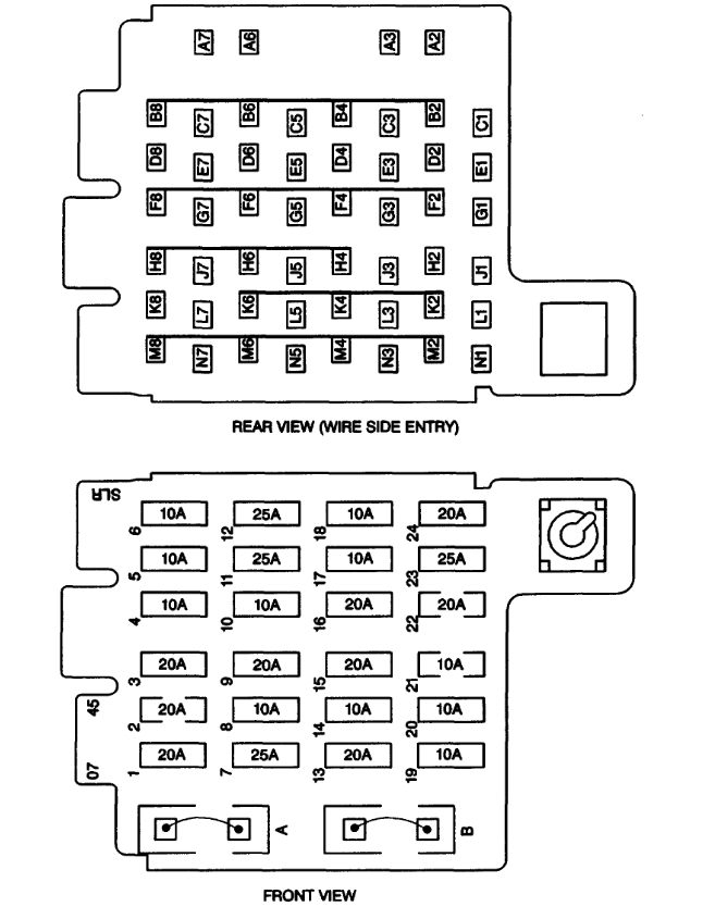

Do the lights stay on but don't blink or the lights not come on at all? here is a guide to help us fix it and the blinker wiring diagrams so you can see how the system works. Have you check the fuses? this guide can help as well with the fuse location in the diagrams below:
https://www.2carpros.com/articles/turn-signals-not-working-blinker
