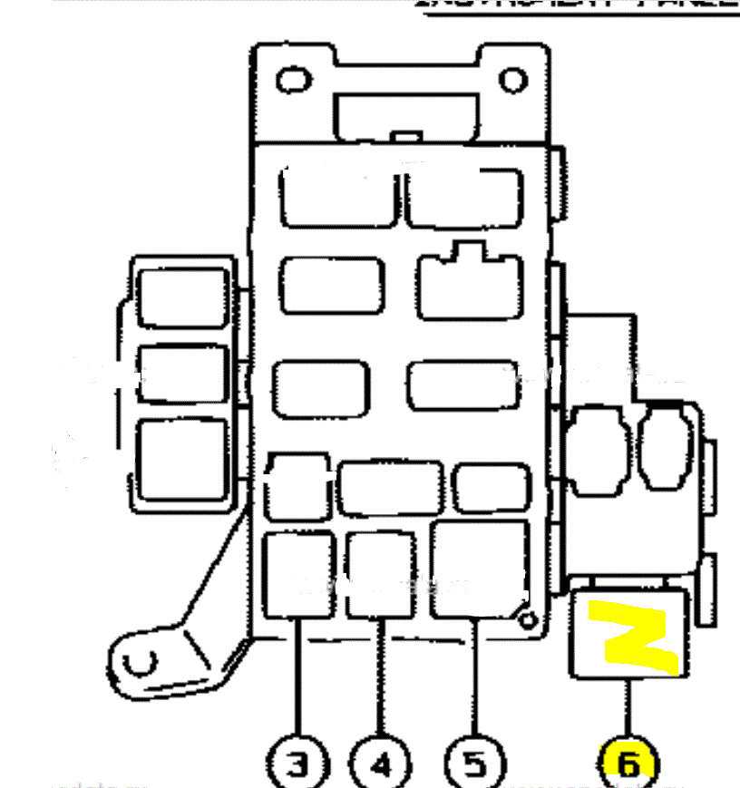

My blinkers go on while i am driving even when i haven't indicated.
Dec 8, 2021 at 11:22 PM
  • 110,241 POSTS
First, this vehicle isn't offered in the US, but I will try my best to help.
If the signals turn on without actuating them, the first thing I would check is the signal flasher relay. It may have failed internally and making contact at different times and conditions.
If you look below, I attached a pic I was able to find online and highlighted the flasher/relay location. Remove it and shake it to see if anything sounds loose. Also, here is a link you may find helpful:
Let me know what you find. Also, let me know if both sides turn on or is it just one side.
See pic below.
