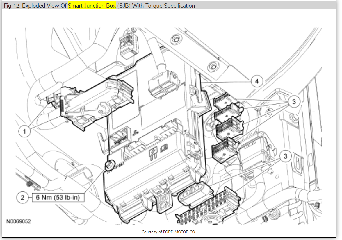

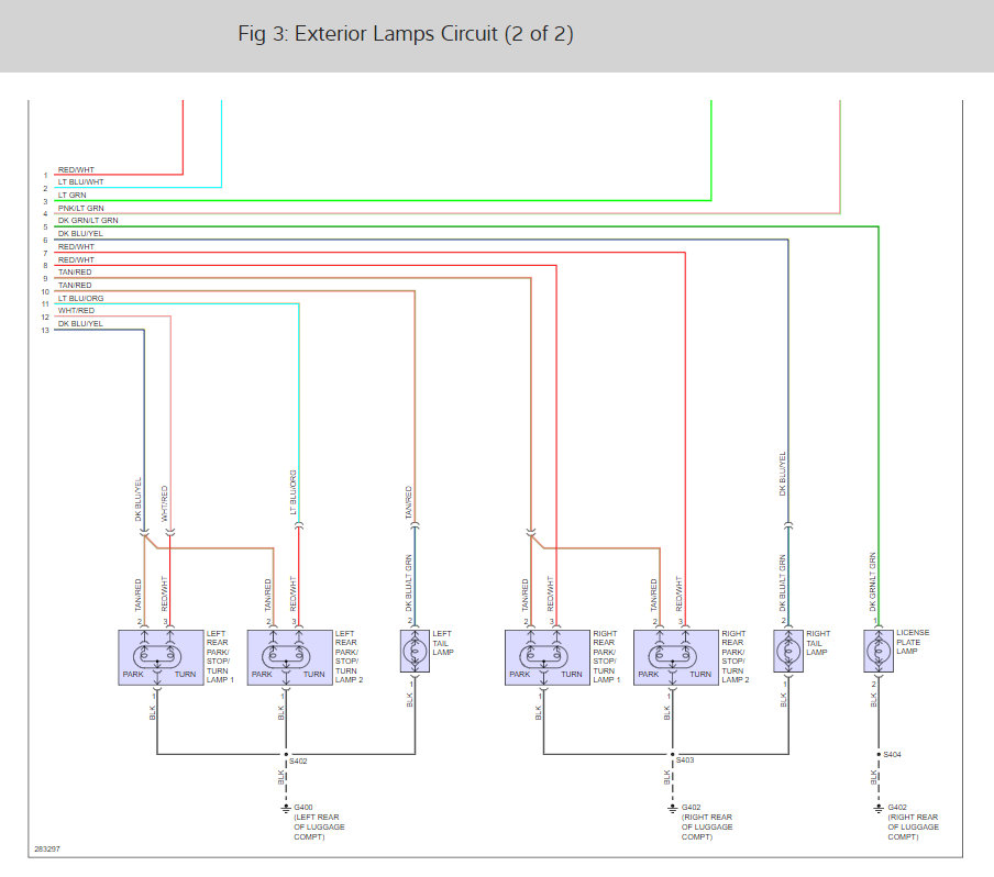

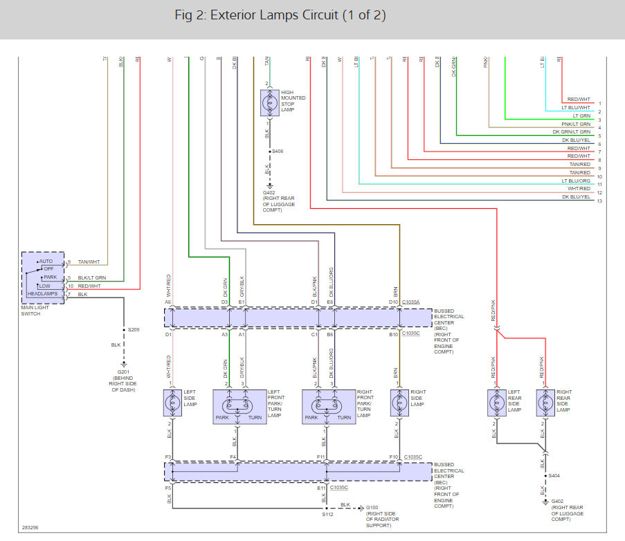

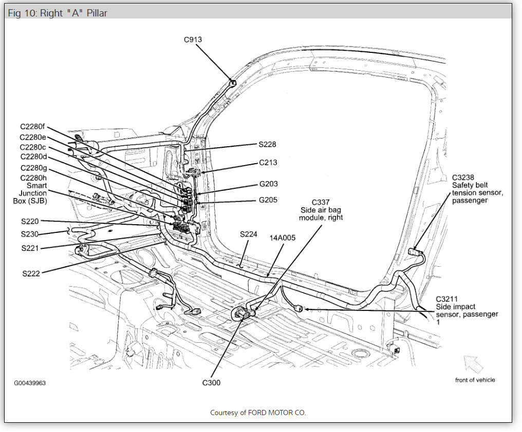

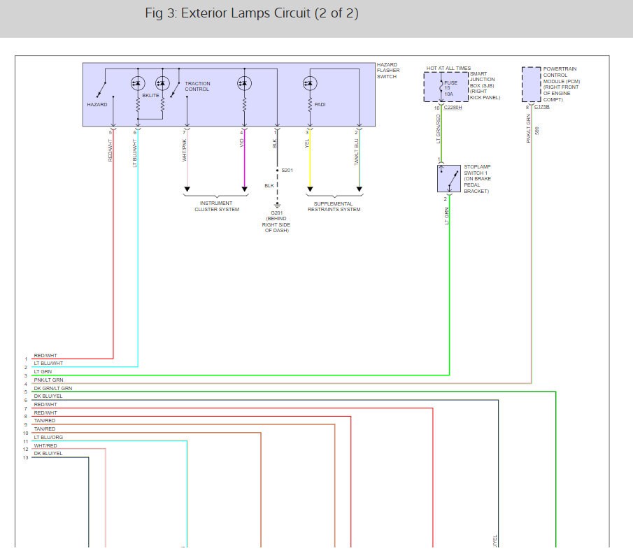

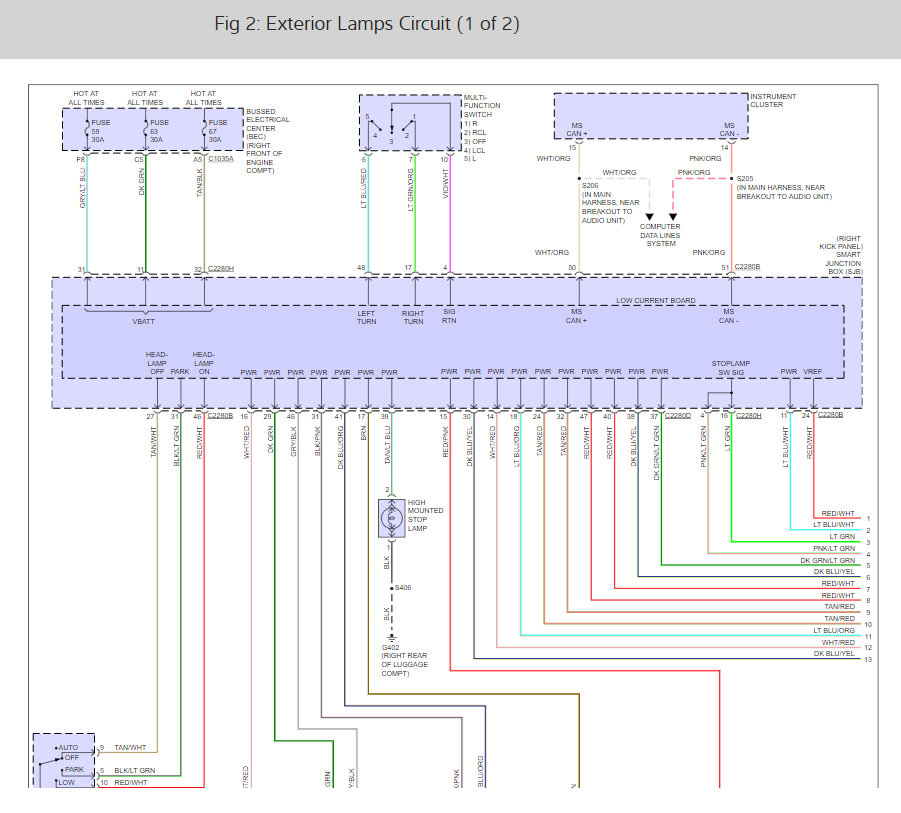

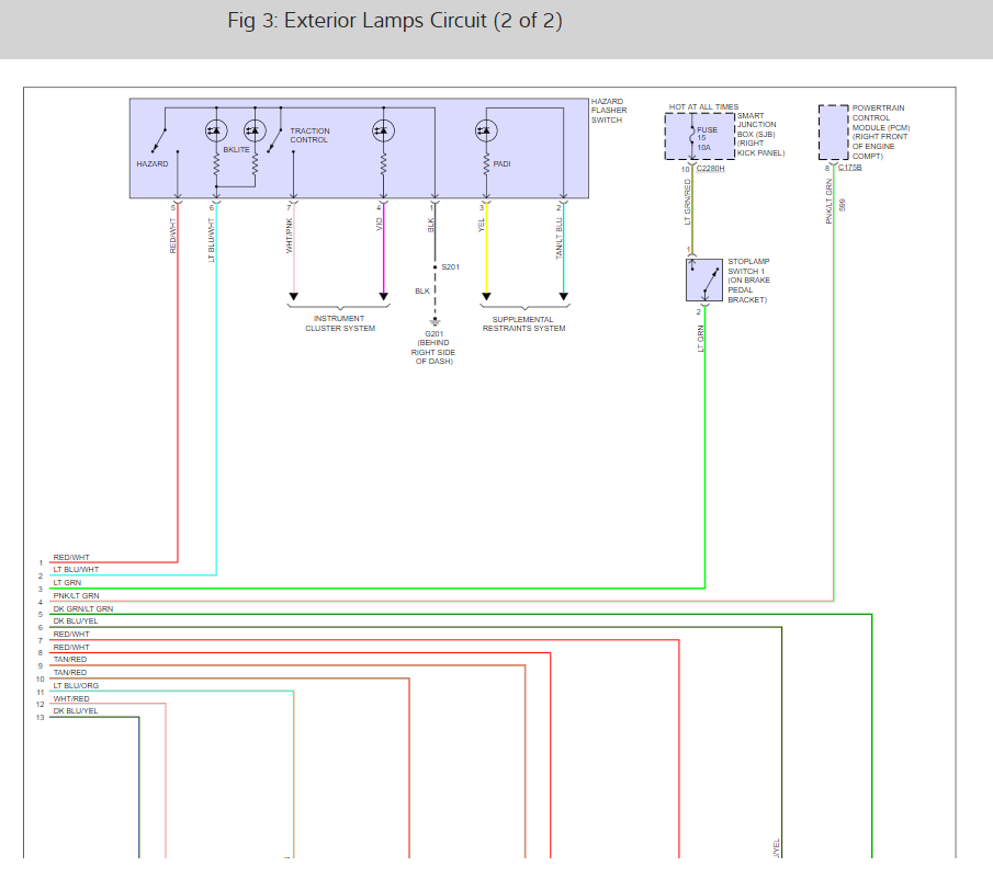

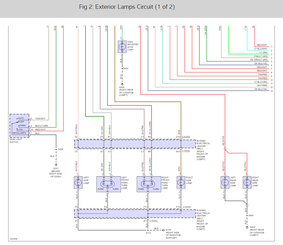

Blinker will not shut off. Replaced turn signal switch still will not shut off when driving.
Nov 18, 2018 at 11:51 AM
  • 55,746 POSTS
It sounds like the smart junction box is starting to go out. Here is the location and the blinker wiring diagrams so you can see how it works. Once you replace the box it should self initialize. Check out the diagrams (below). Please let us know what you find. We are interested to see what happens.
