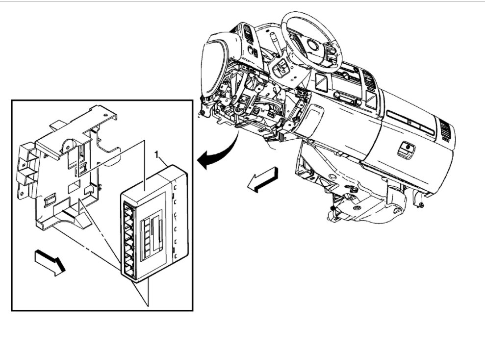

Put in left turn does nothing. off position and right turn signal show turning right service airbag light is on water over bumper yesterday an in floorboard.
Aug 29, 2017 at 10:45 PM
  • 55,447 POSTS

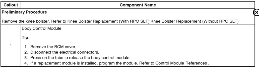

It sounds like the BCM got wet here is the location. I would try to unplug it and let it dry out for a couple of days while checking the terminals for corrosion. Disconnect the battery first leave the doors open as well. If that does work try a used BCM
