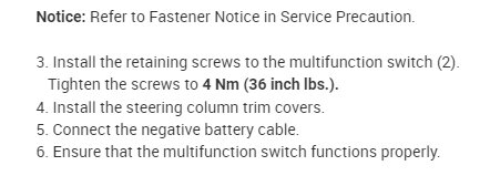

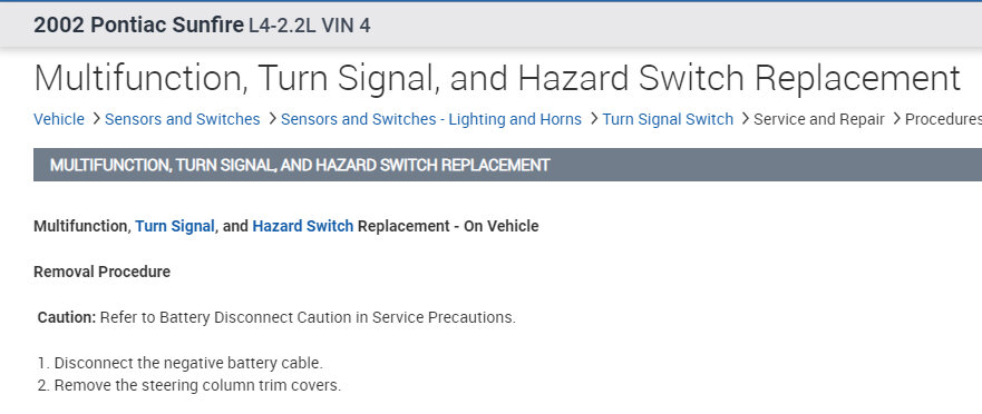

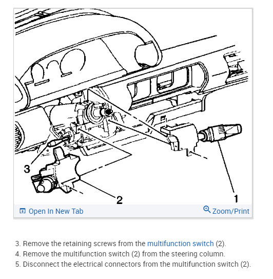

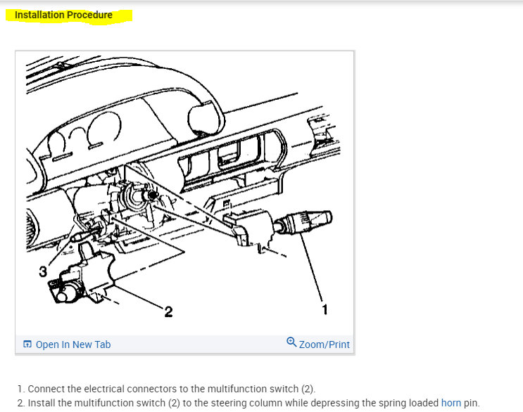

I'm not sure exactly what was ordered, but if it has cruise control and your vehicle doesn't, it shouldn't affect the signals.
I'm not sure if you need them, but I attached the directions for the removal and installation of the switch below.
Let me know if this helps.
