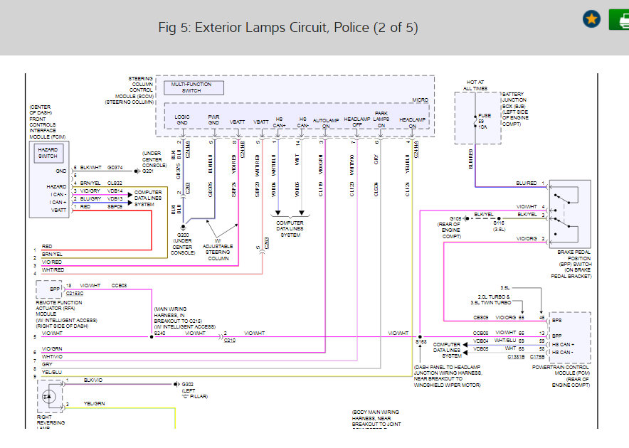

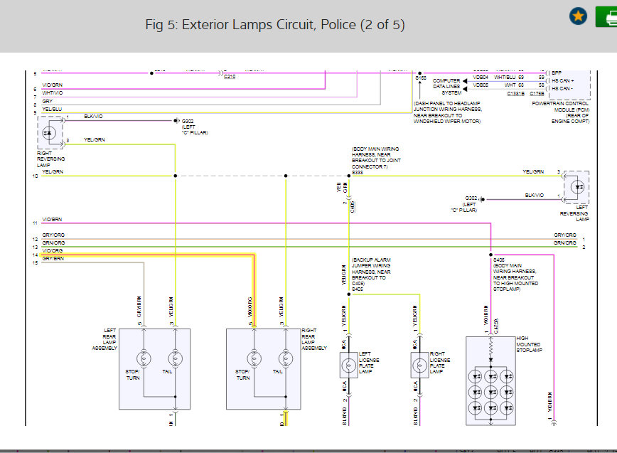

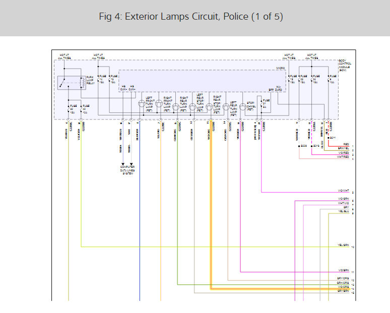

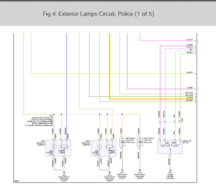

I have included the wiring diagrams for your vehicle's exterior lighting system in the diagrams down below for reference. Is your Malfunction Indicator Lamp (MIL) or "check engine" light illuminated?

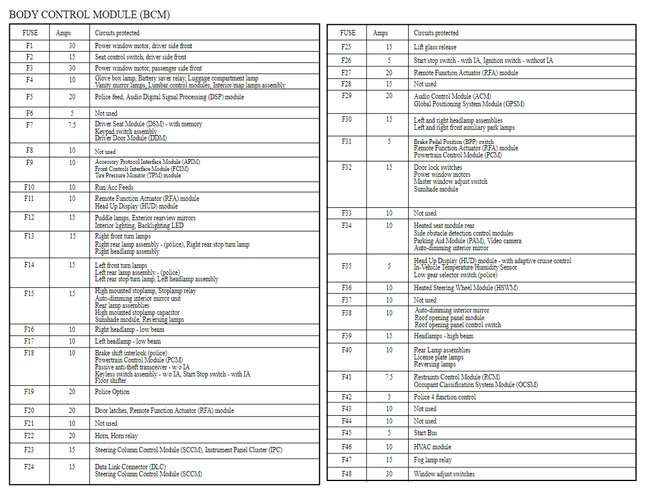

Try unplugging your battery and waiting 3-5 minutes before reconnecting it. The body control module has field effect transistors that act as internal fuses that will trip if there is a blown bulb or a short circuit so the only way to reset the transistor is either unplugging the body control module or taking away the power. Let us know what happens.

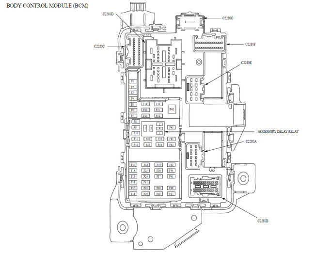

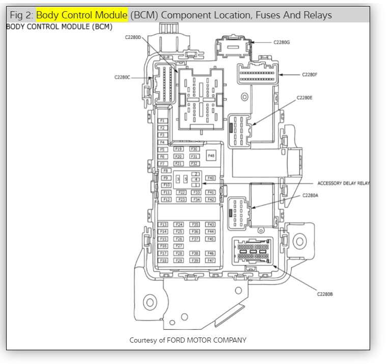

I would check the fuses on the BCM #15, 23, 24 and #9 if they are okay it sounds like the BCM is going out which is common, to confirm the failure you can get a CAN scanner (Controller Area Network) from Amazon for about $36.00.

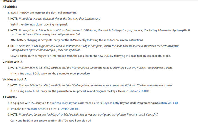

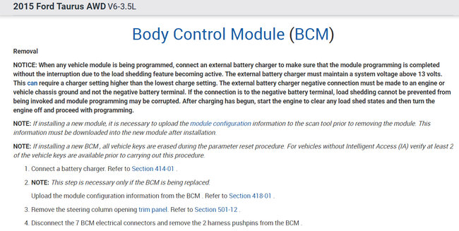

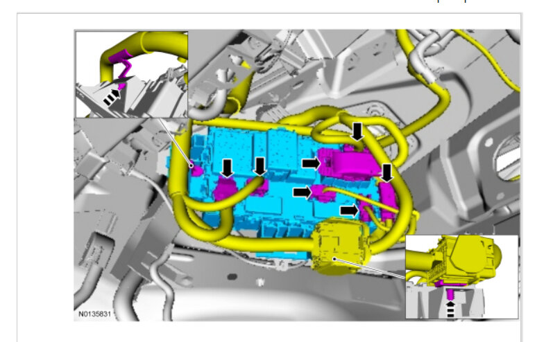

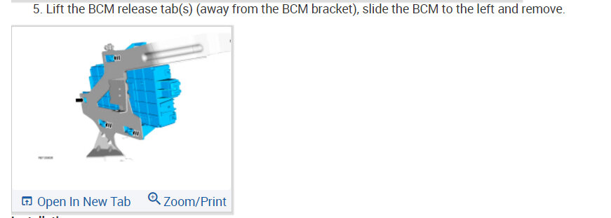

Here is how to change the BCM out in case you need it and the fuse locations as well. Check out the images (below). Please let us know what you find. We are interested to see what it is.
