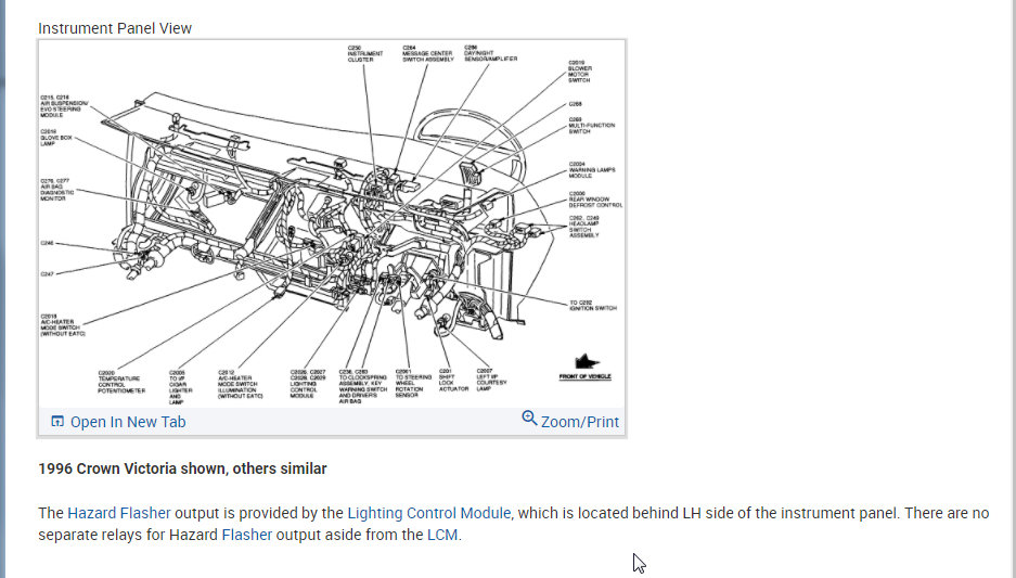

Can't locate relay.. Empty socket in fuse box, another in trunk. Can I use either or without causing a problem or reaction, or where is other socket located ?
Mar 11, 2021 at 1:59 PM

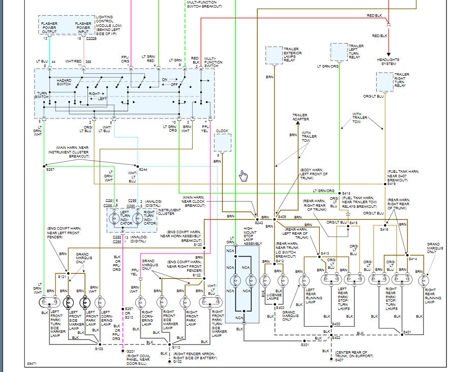

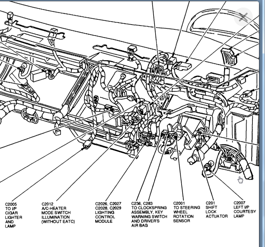

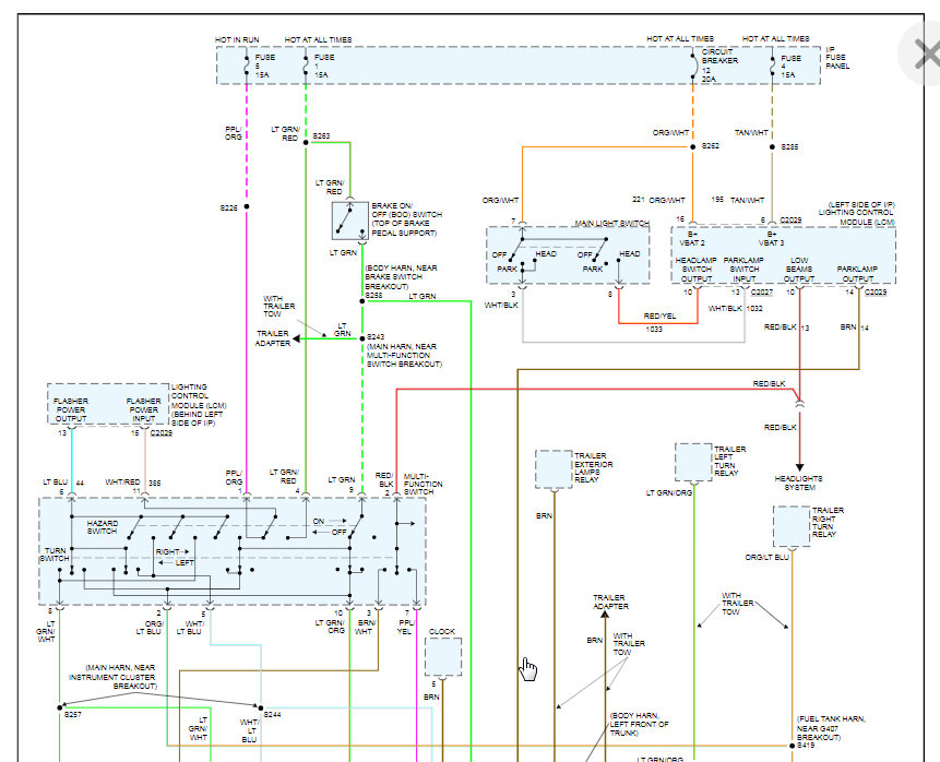

Your vehicle does not use a relay for the turn signals or hazards. You have what is called a lighting control module. So if you have no operation then we need to check the voltage coming out of the LCM.
So if you have no voltage coming out then you need to replace the LCM assuming that the LCM is getting the switch input which is most likely there but worth checking to make sure. However, it is unlikely that both the turn signal switch and hazard switch stopped working.
Let me know if you have questions and we can go from there. Thanks
