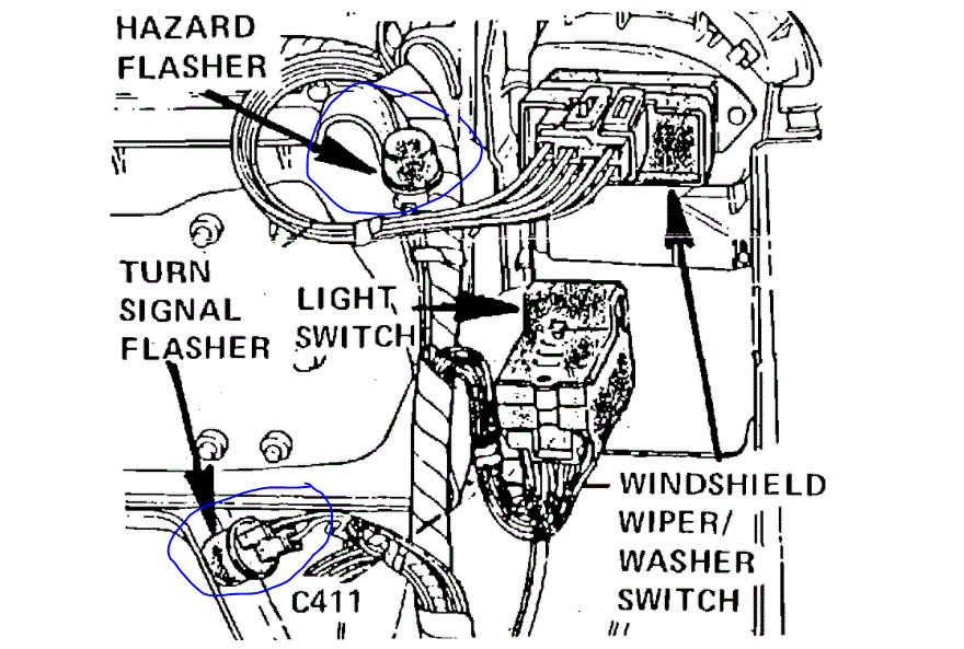

E250 van. where is the blinker flasher located?

Good evening,
Both the turn signal and hazard flashers are behind the dash on the left side. I attached a picture of the locations for you to view.
Hazard warning: Behind LH side Of I/P, On Fuse Panel.
Turn signal: Behind LH Side Of I/P, On Fuse Panel.
