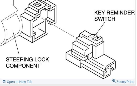

There is a key reminder switch in the steering column which I feel is the issue. Here are the directions for replacement and inspection:
___________________________
2011 Mazda Truck CX-7 FWD L4-2.5L
Key Reminder Switch Removal/Installation - Without Advanced Keyless Entry And Start System
Vehicle Steering and Suspension Steering Steering Column Key Reminder Switch Service and Repair Removal and Replacement Key Reminder Switch Removal/Installation - Without Advanced Keyless Entry And Start System
KEY REMINDER SWITCH REMOVAL/INSTALLATION - WITHOUT ADVANCED KEYLESS ENTRY AND START SYSTEM
KEY REMINDER SWITCH REMOVAL/INSTALLATION [WITHOUT ADVANCED KEYLESS ENTRY AND START SYSTEM]

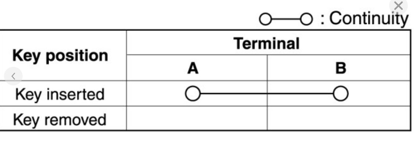

1. Disconnect the negative battery cable.
2. Remove the column cover. See: Steering Column Cover > Removal and Replacement > Column Cover Removal/Installation
3. Disconnect the key reminder switch connector.
4. Remove the key reminder switch.
pic 1
5. Install in the reverse order of removal.

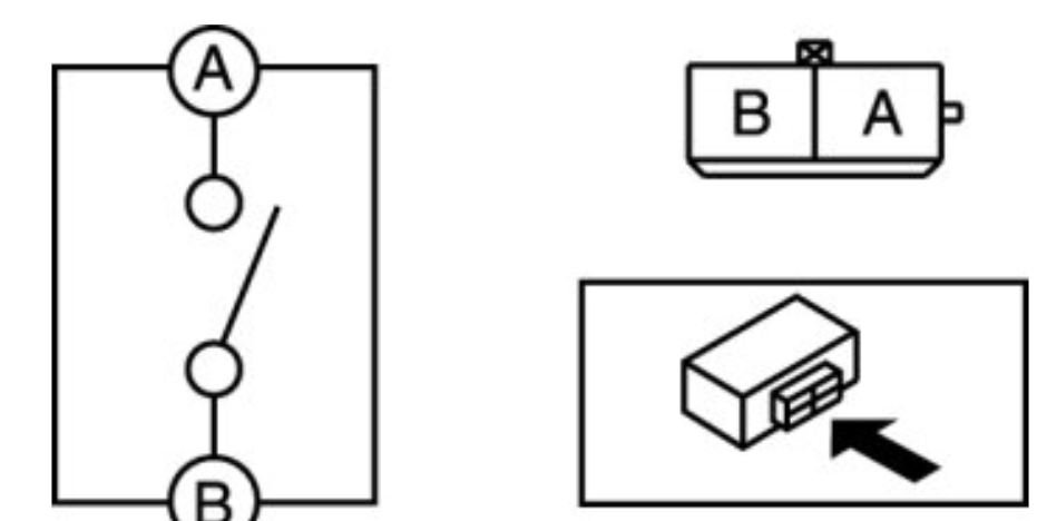

Here are the test procedures once the switch is removed.
KEY REMINDER SWITCH INSPECTION [WITHOUT ADVANCED KEYLESS ENTRY AND START SYSTEM]
4. Inspect for continuity between the key reminder switch terminals using a tester.
pic 2
- If there is any malfunction, replace the key reminder switch.
pic 3

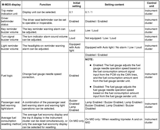

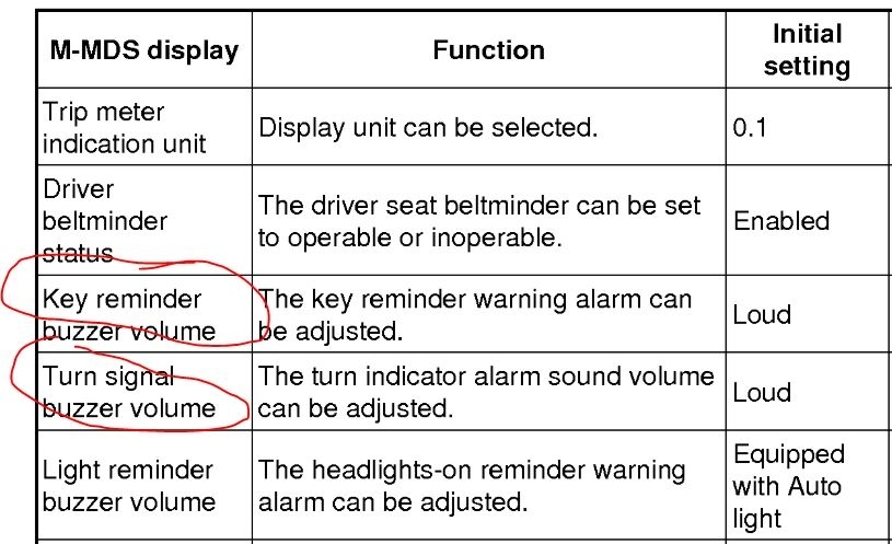

After I made the last post, I remembered something.

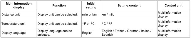

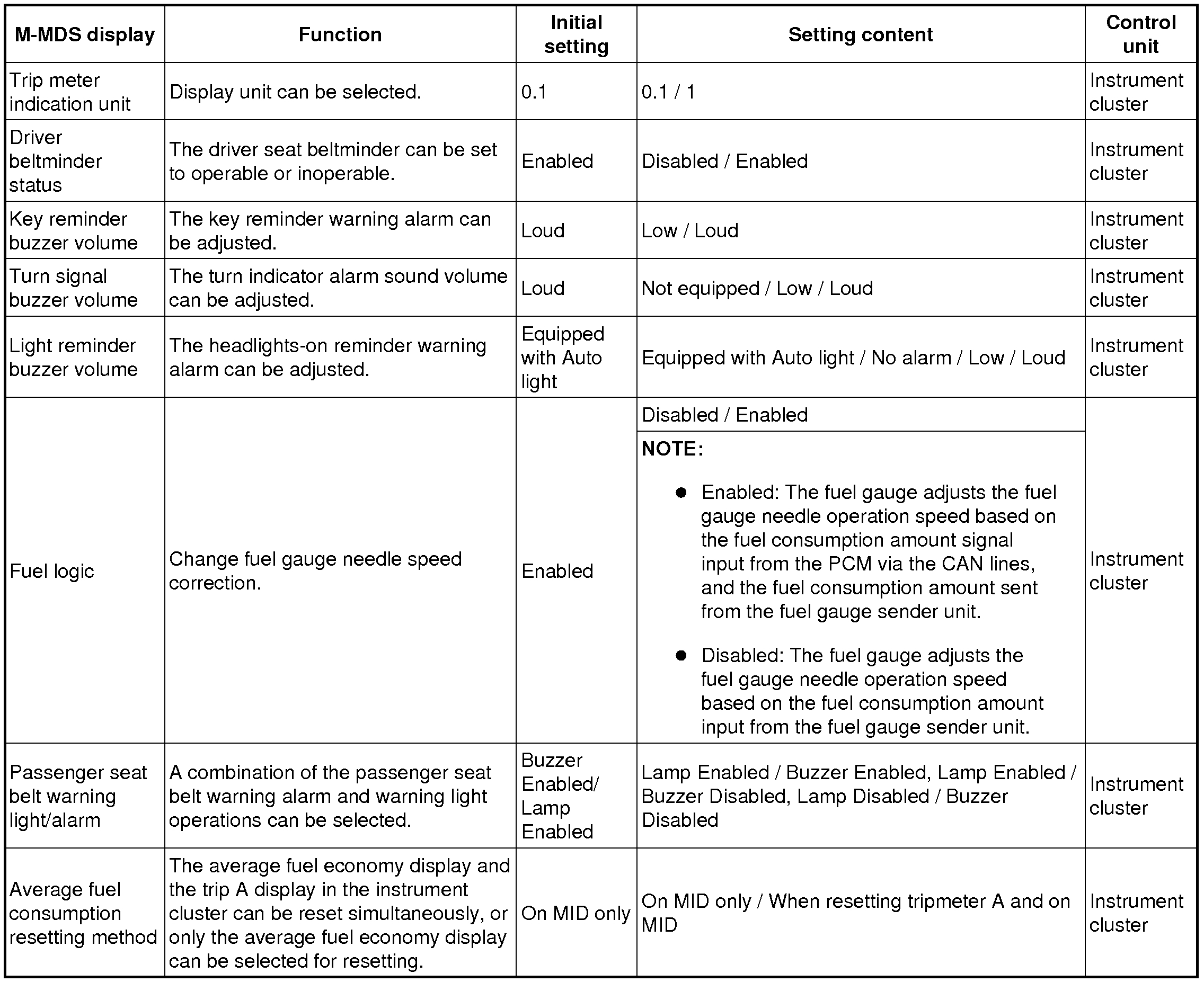

I knew I saw this before. It hit me after I sent the last post. Now, if you aren't able to access the volume via the dash, it most likely will need to go to a dealer that has the proper computer software. If you look at the first picture, you will see that the volume for both is adjustable. The problem is it needs done with a computer. Here are the directions. The additional pictures correlate with these directions.
Instrumentation/Driver Info. Personalization Features Setting Procedure
Vehicle Accessories and Optional Equipment Driver/Vehicle Information Display Testing and Inspection Programming and Relearning Instrumentation/Driver Info. Personalization Features Setting Procedure
INSTRUMENTATION/DRIVER INFO. PERSONALIZATION FEATURES SETTING PROCEDURE
Instrument Cluster
NOTE:
- Use the IDS (laptop PC) because the PDS (Pocket PC) does not support the INSTRUMENTATION/DRIVER INFO. PERSONALIZATION FEATURES SETTING PROCEDURE.

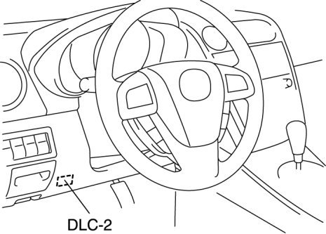

1. Connect the M-MDS to the DLC-2.
Pic 2
2. After the vehicle is identified, select the following items from the initial screen of the M-MDS.
- Select the "Module Programming".
3. Then, select items from the screen menu in the following order.
1 Select "Programmable Parameters".
2 Select "Warning Lamps / Chimes".
4. Select an item name, and then select option.
pic 3

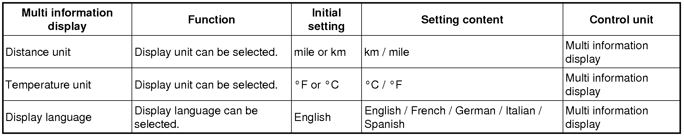

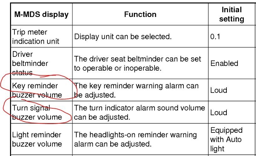

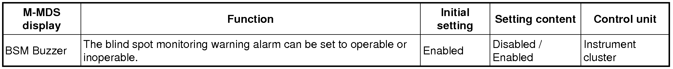

Blind Spot Monitoring System
NOTE:
- Use the IDS (laptop PC) because the PDS (Pocket PC) does not support the BLIND SPOT MONITORING SYSTEM CUSTOMIZED FUNCTION SETTING PROCEDURE.
pic 4
2 Select "BSM".
pic 5

1. Press the INFO switch until the SETTINGS screen is displayed.
2. Select PREFERENCES by pressing the Enter (up/down) switch up or down, and then press the Enter (up/down) switch.
3. Select the setting item you want to change by pressing the Enter (up/down) switch up or down, and then press the Enter (up/down) switch.
4. Select the desired setting by pressing the Enter (up/down) switch up or down, and then press the Enter (up/down) switch.
pic 6
