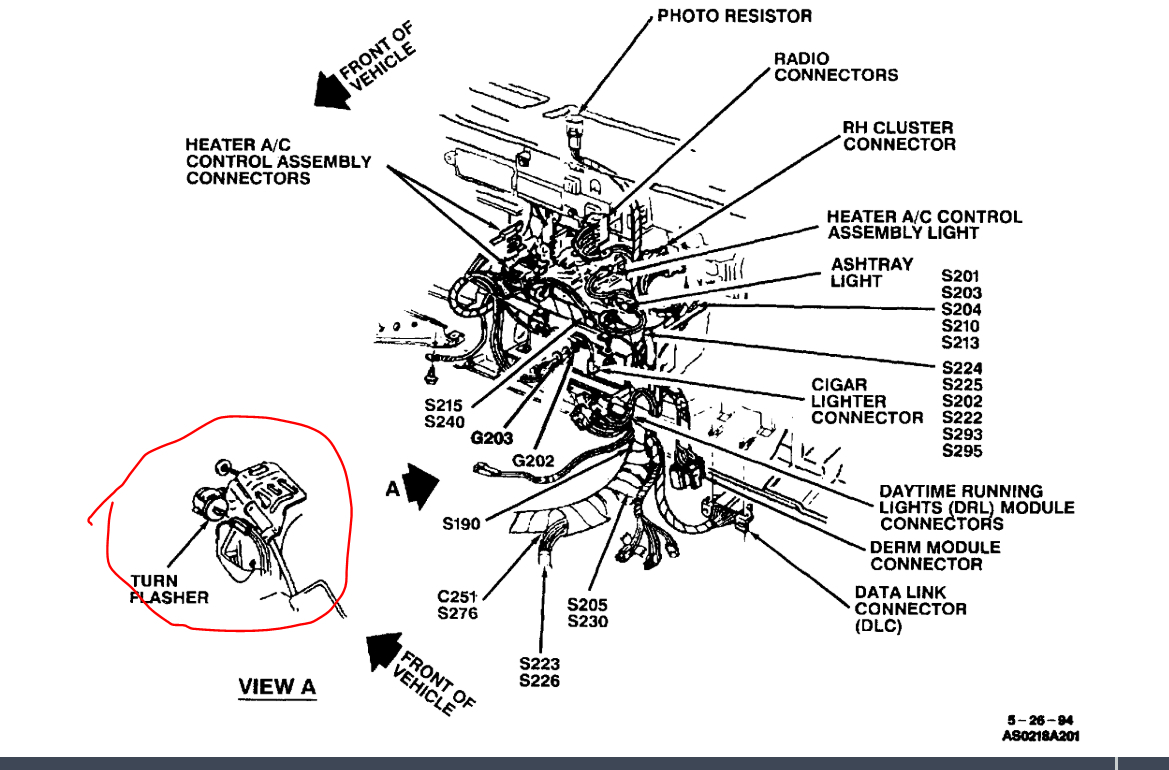

Blinkers turn on but do not flash
1996 OLDSMOBILE CIERA
54,800 MILES • 3.8L • 6 CYL • 2WD • AUTOMATIC
POLLIE MARLOW
MEMBER
2 POSTS
I need to know where it is located in my car. Flasher bulb where is it located?
Jan 8, 2020 at 5:11 AM
Experienced Mechanic
110,251 POSTS
The turn/signal lamp flasher is located behind the center of the instrument panel, behind ashtray. See pic 1.
