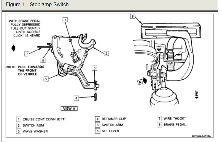

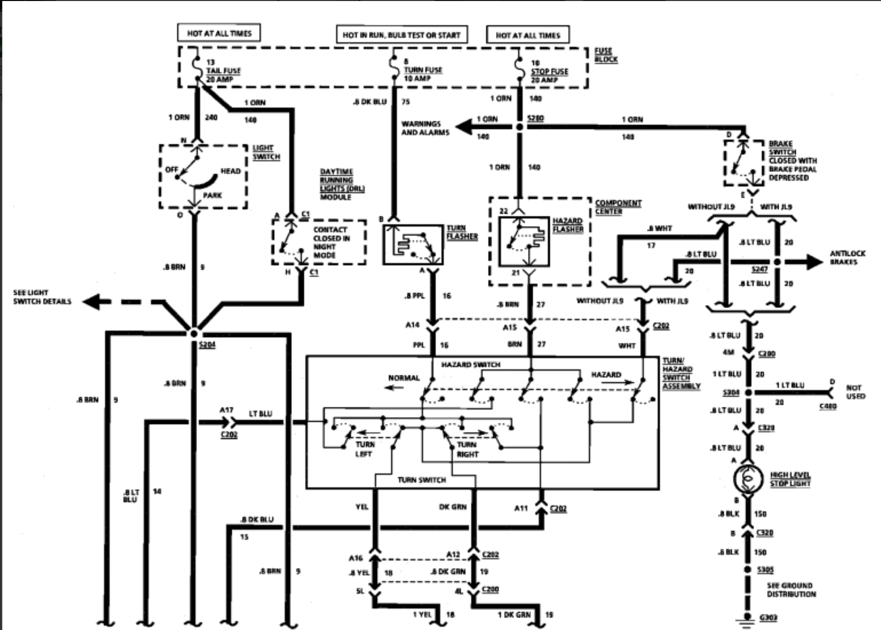

I think it is the brake switch. Because the hazard switch keeps blowing the 20 amp stop fuse when I keep putting a new fuse in the fuse box. I can hear it burn out and the head lights as in the headlight switch are malfunctioning and also do not have turn signals. The brake light gets grounded by the hazard switch which the fuse is powered at all times. Do you know where the brake switch is located in my car?
Jun 22, 2018 at 1:36 PM
  • 55,421 POSTS
Sure it is up on the brake pedal right below the pivot. Use a flashlight and you will see it.
Check out the diagrams (below). Please let us know what you find.

It has got to be the brake switch. I just checked it and the brake lights did not light up when I stepped on the brake. So it looks like from the wire diagram I was right. I need to buy a brake switch and see what it does now.
