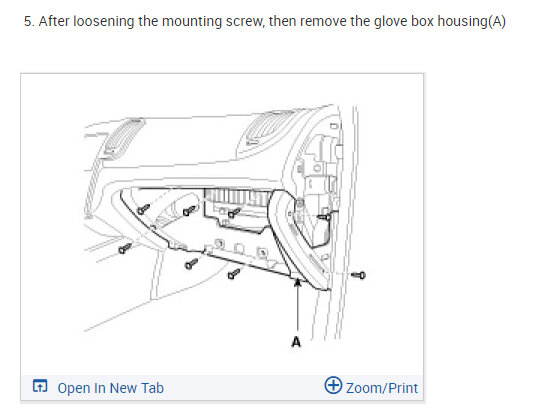

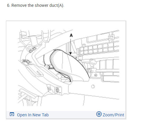

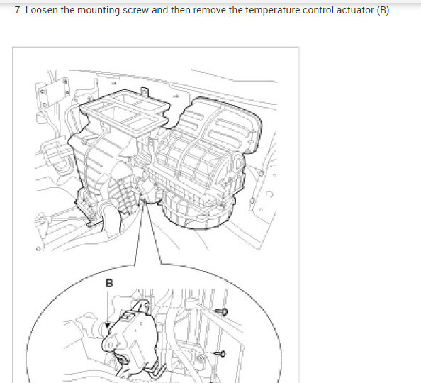

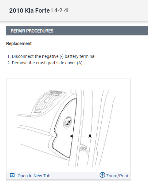

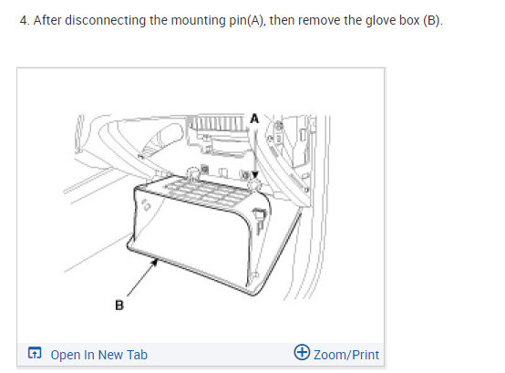

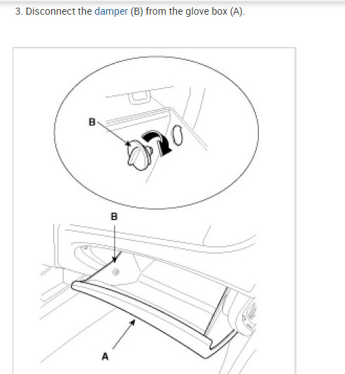

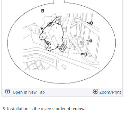

Hello, I have the vehicle listed above Koup and every time i turn my A/C system on i hear a knocking noise for a couple of seconds and then stops. However, this does not occur when turning on the heat, just the cool air. So, I am unsure of what blend motor actuator I need to change and where they are located on my vehicle.
Jul 27, 2024 at 5:07 AM
  • 110,244 POSTS

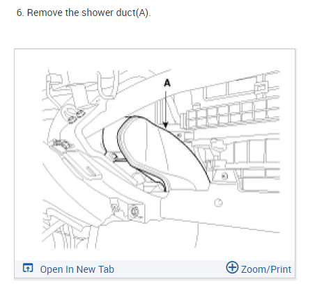

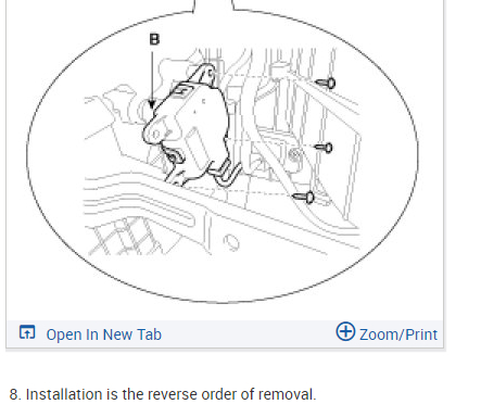

It sounds like the plastic gear in the actuator motor is failing. If you look below, I attached the directions specific to your vehicle for replacing it.
Additionally, here is a link that explains in general how it's done. You may find it helpful to look over it prior to starting the job.
Let me know if this helps.
