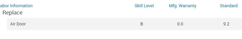

What is average cost to repair/replace foam on HVAC blend doors
2004 VOLKSWAGEN BEETLE
110,000 MILES
BOB FRENCH
All the foam has blown off and now is all over the inside of car. I believe I have the cable control and the split unit (under dash). Thanks, Bob
Oct 24, 2018 at 4:49 AM
  • 110,240 POSTS
Hi and thanks for using 2carpros.com
I don't have a concrete price on the part, but to remove and replace the door is labor intense. See the attached picture for labor rates.
I can't imaging parts to be more than $50.
