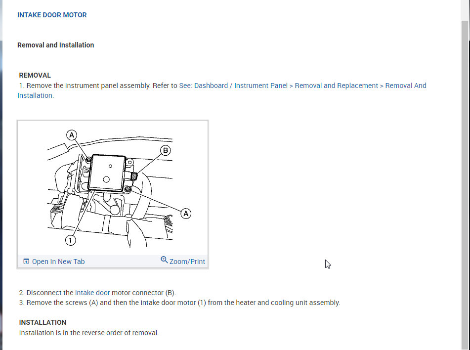

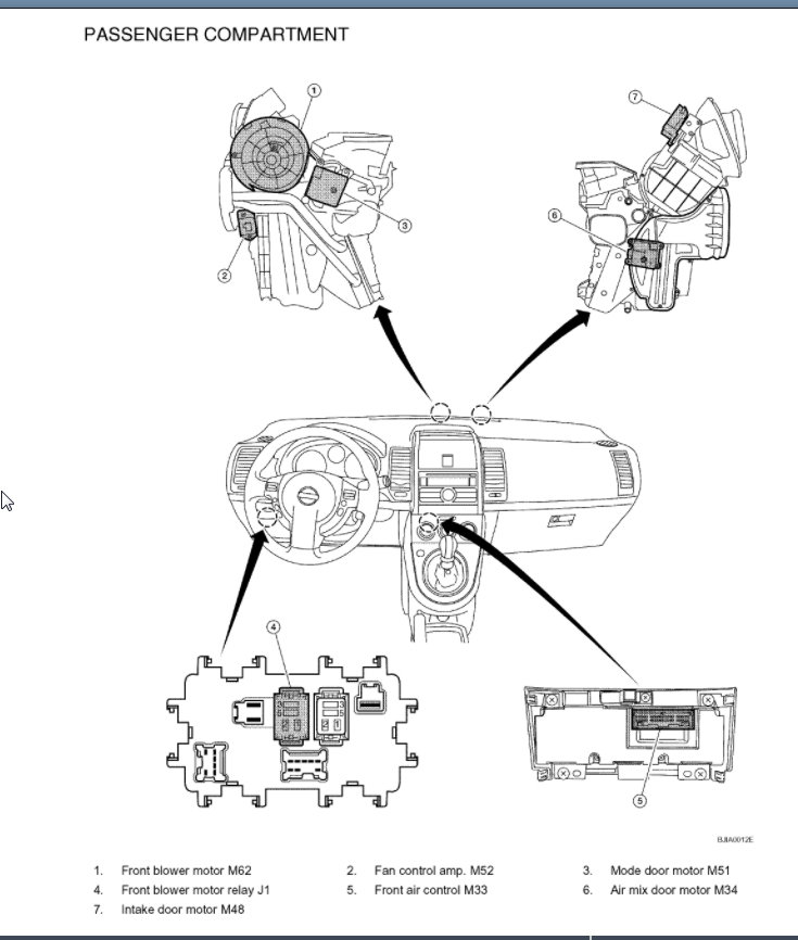

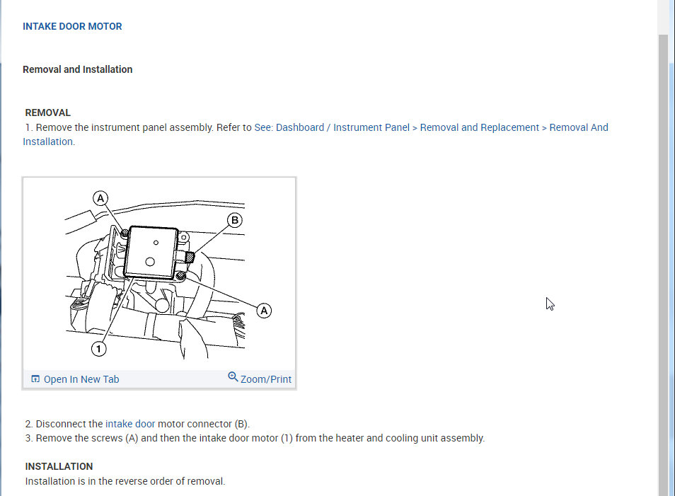

More then likely this is the intake air door motor has failed. The only thing that changes with this system when you go faster is the amount of air that is going past the vehicle so I suspect this door is failing. However, I would suggest starting with removing the blower fan and make sure there is nothing still in there. It sounds like you have or had a mouse in there that built a nest. If it is cleared out then I would start with replacing this door.

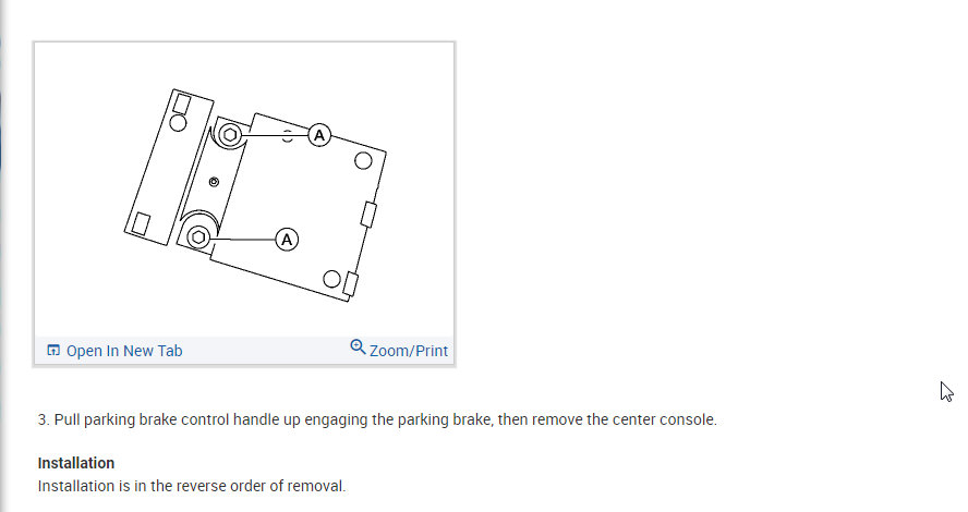

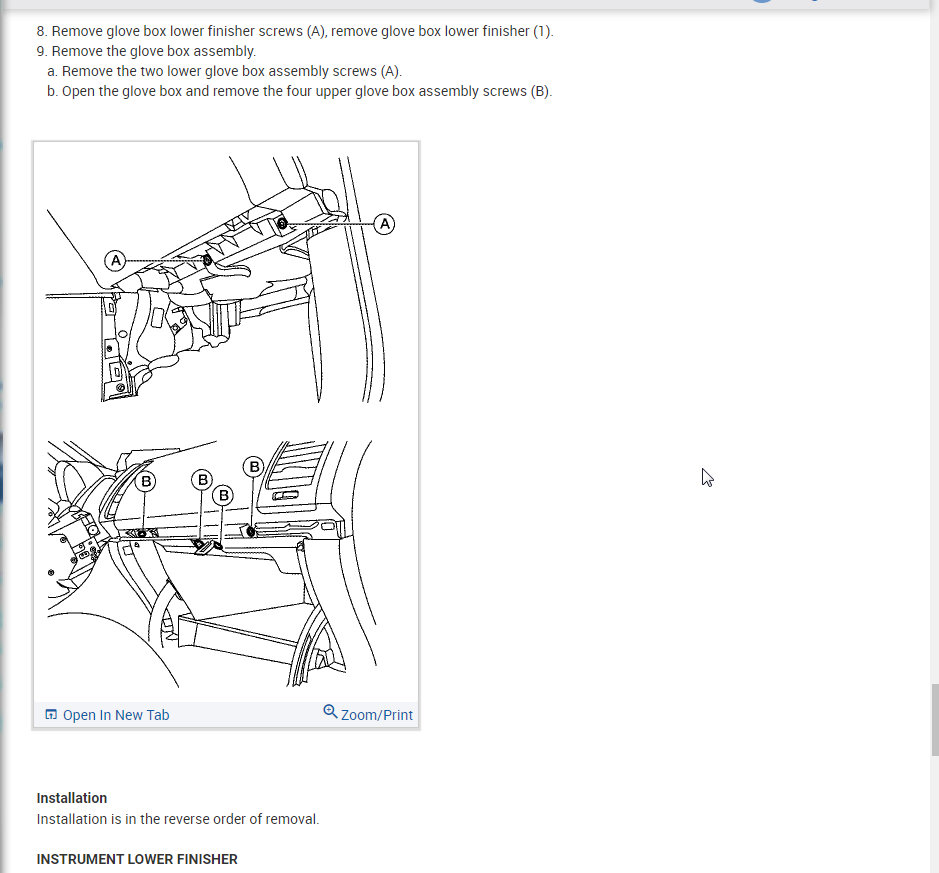

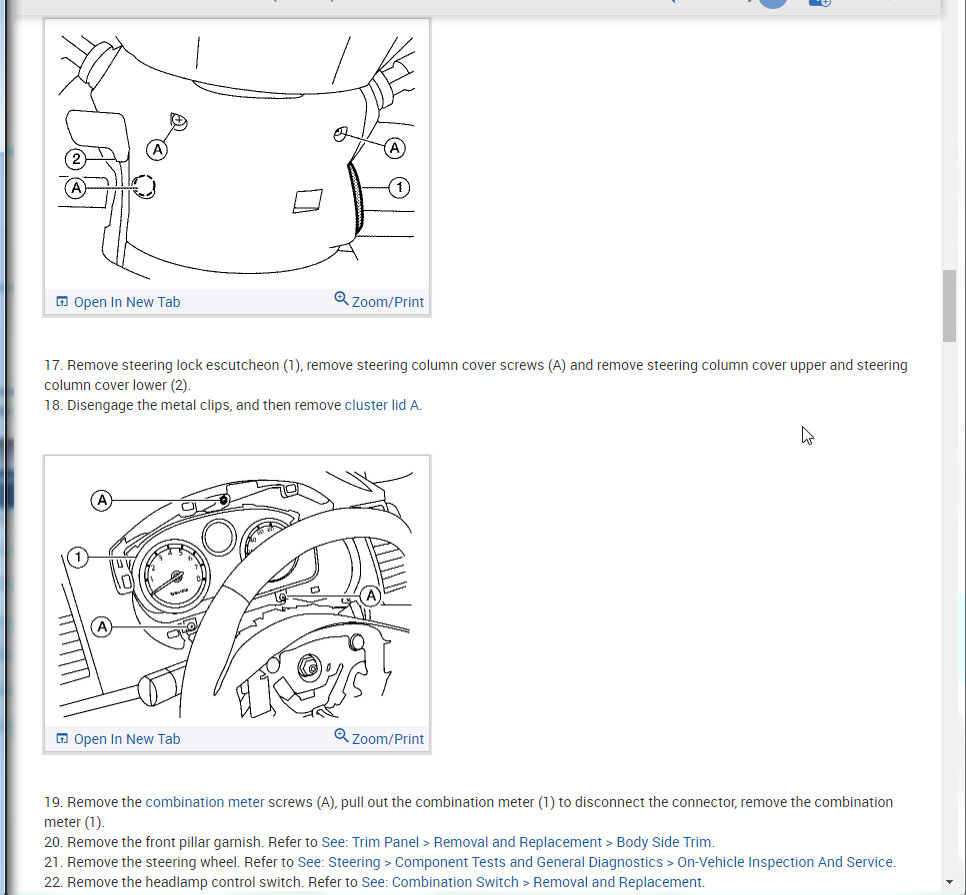

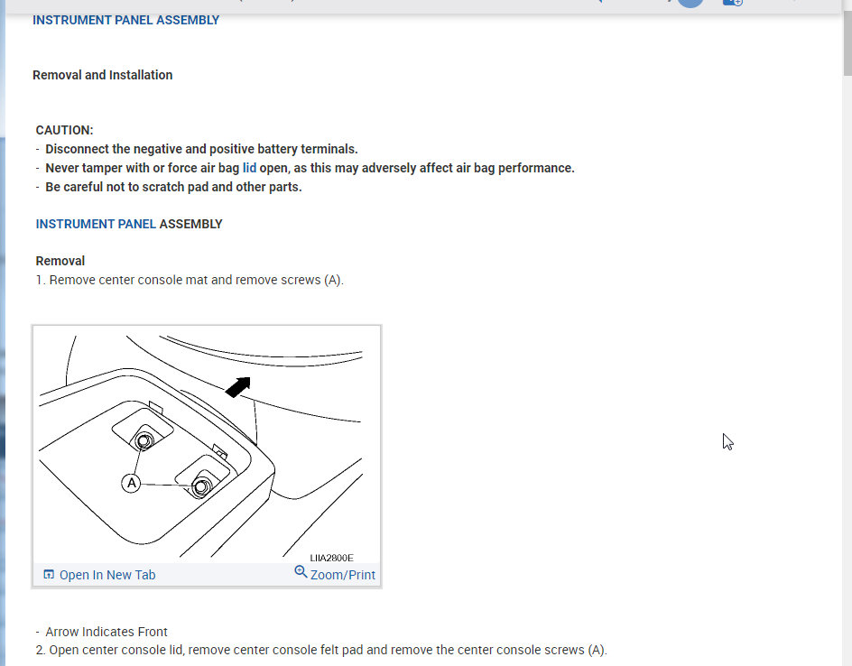

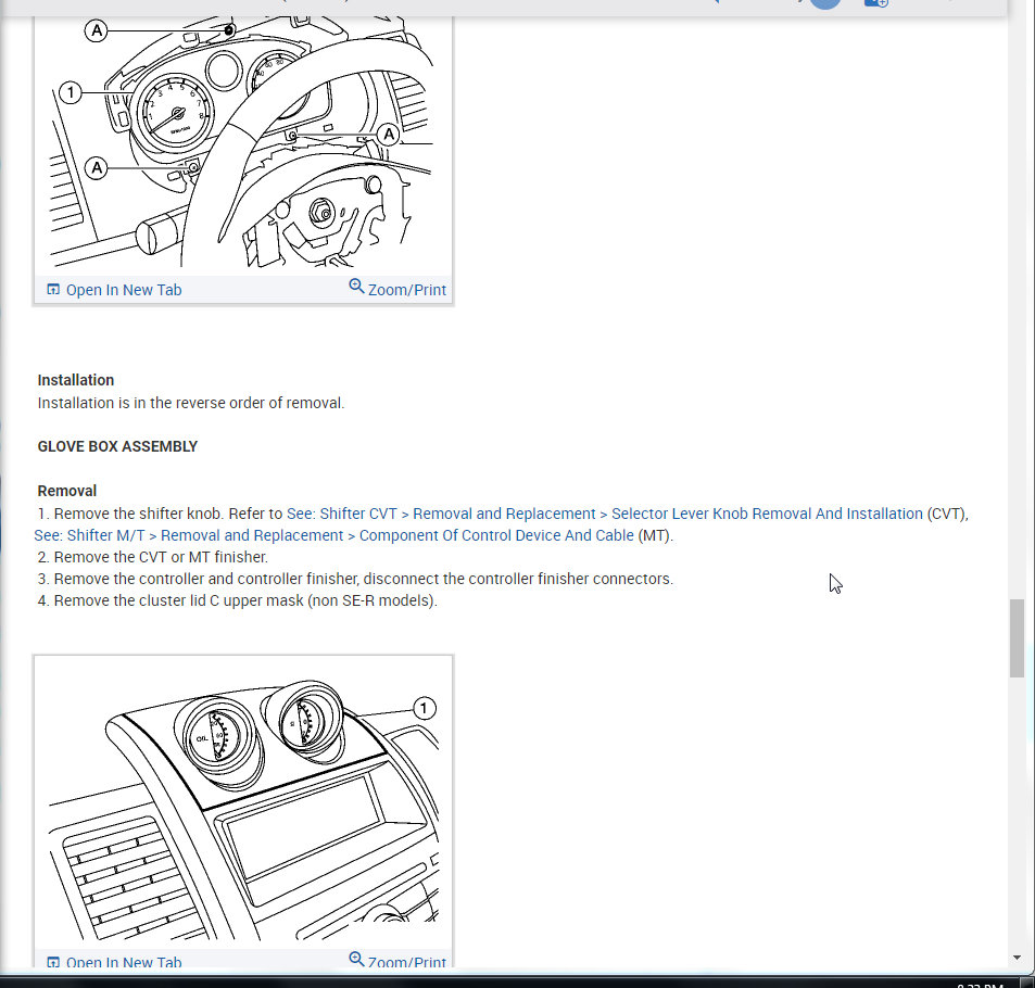

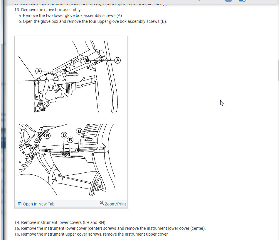

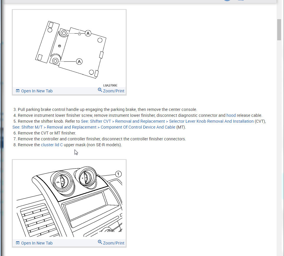

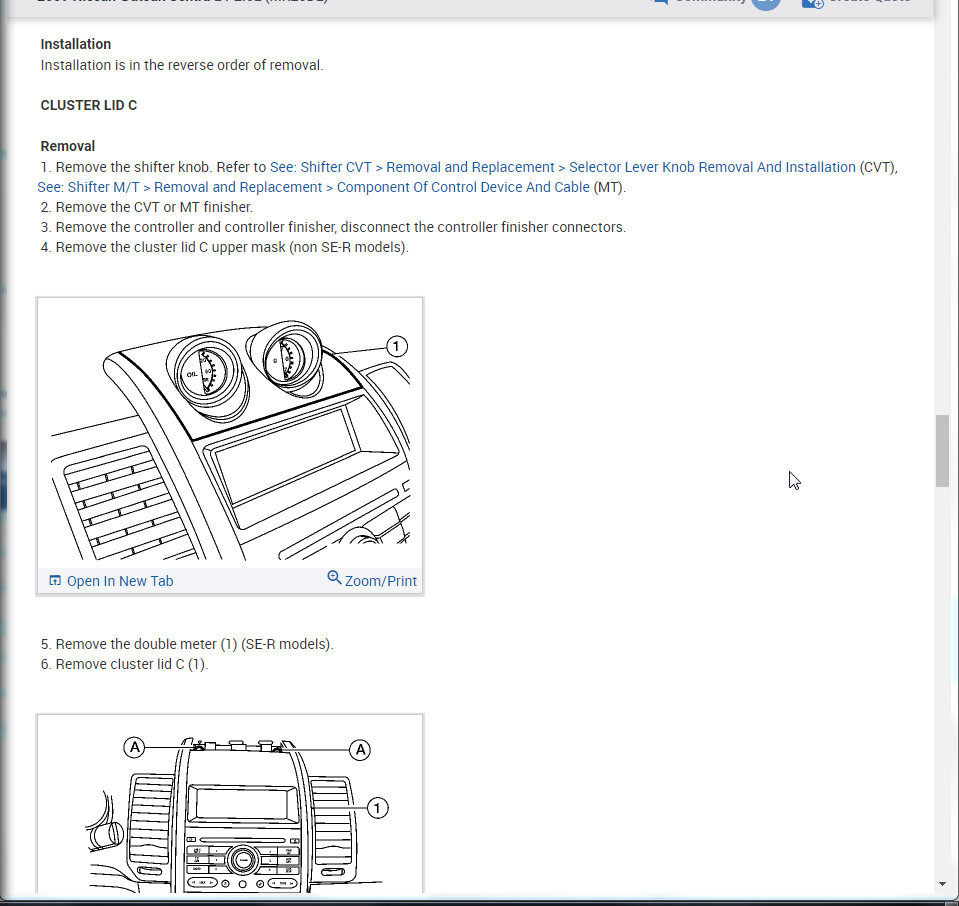

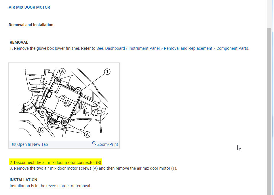

Unfortunately this is the case. If this does not happen all the time then I would not just replace this door until we have more proof.
When you say you can hear the fan running, I would suggest dropping the glove box out of the way and just drive it around like this so that you can literally put your hand on the housing where the fan is and make sure it is turning. I am wondering if this is air being mistaken for the fan. If the fan is running then you should feel air somewhere.

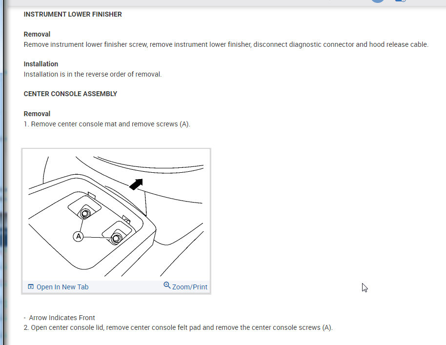

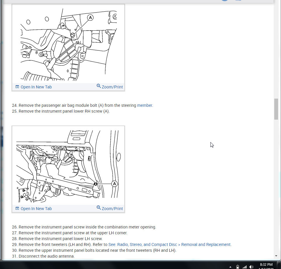

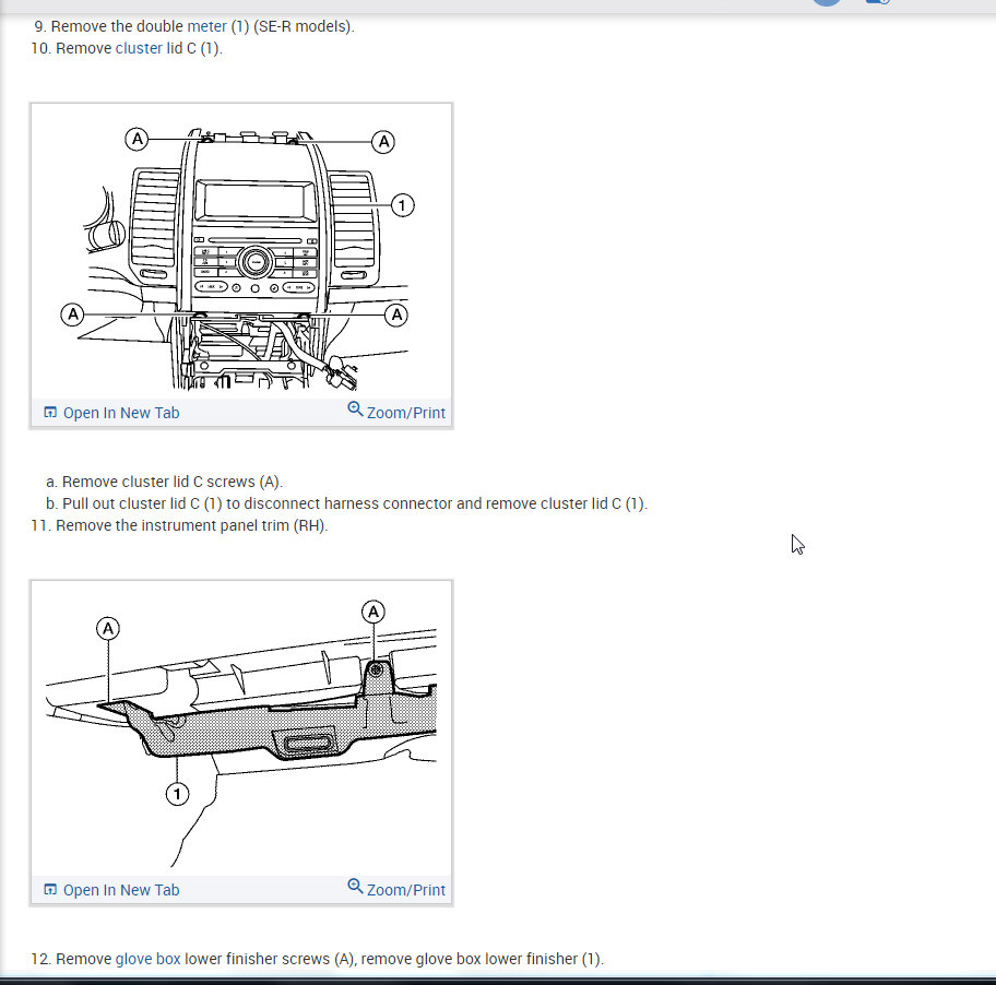

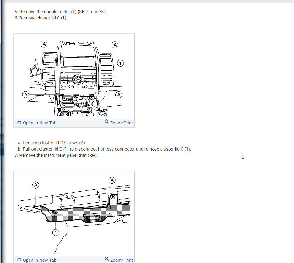

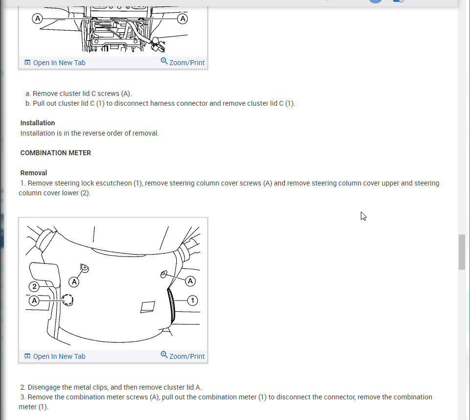

I attached the process below on how to remove this actuator for your review.

Your blend doors are electrically controlled. This would be possible if they were still run off vacuum but that has not been used since about the late 90's. Most all actuators started moving from vacuum to electric starting in the 80's.
