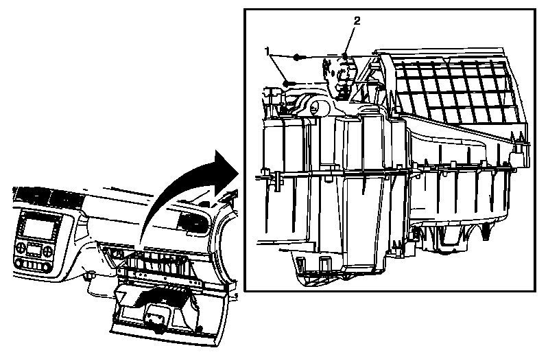

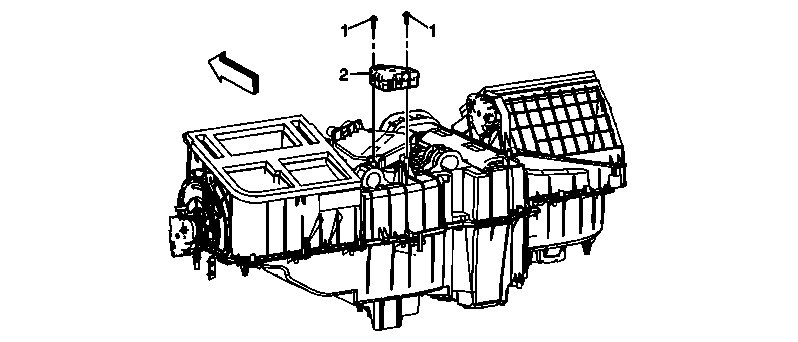

The defrost mode will not engage. It stays on the main vents. I can change the temperature for both sides of the truck. But will not go to the defrost vents at all. This is a 1500 crew cab.
Jan 21, 2019 at 2:35 AM
Good afternoon,
I attached a picture for you to view. The actuator, which is a common failure, is under the dash that controls the mode door operation.

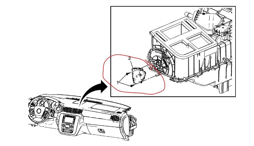

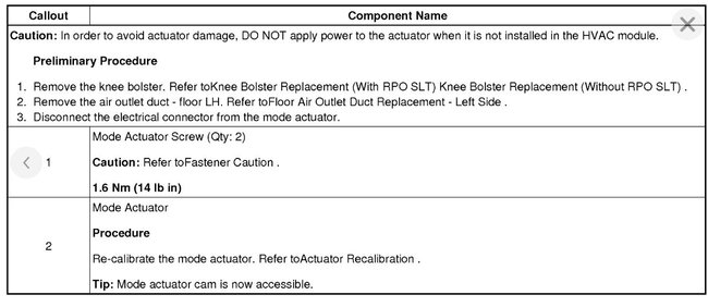

KOUNTREEMALLORY86

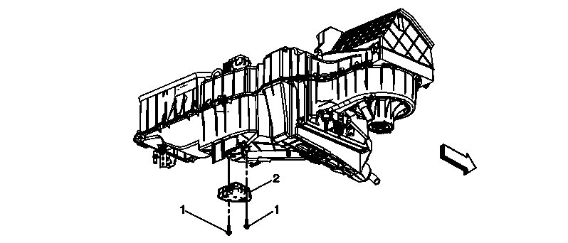

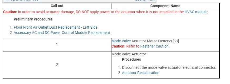

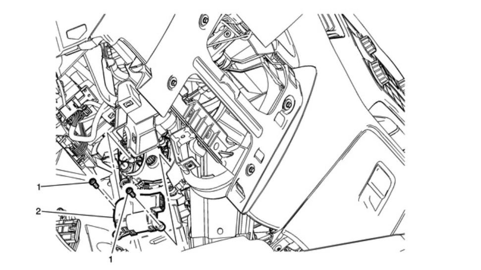

My AC and heat only blow through my vents. I can control everything else but where it comes out of. Is that what needs to be replaced and if so where is it located?
Dec 18, 2020 at 12:21 AM (Merged)
Good afternoon, I attached the picture and procedure for you. It is under the dash on the left side of the heater case. Check out the diagrams (Below). Please let us know if you need anything else to get the problem fixed.

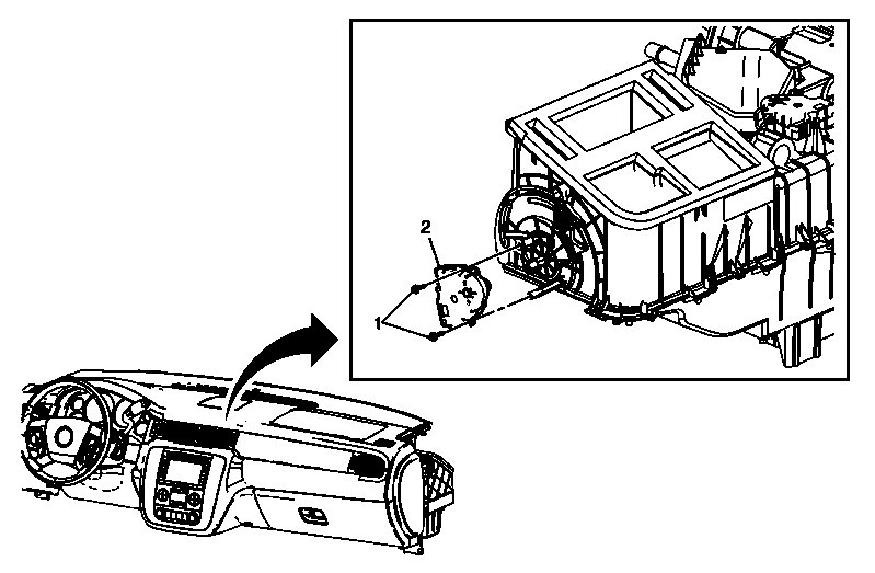

BWK
Are there four actuator's ? There is a diagram on your sight that shows four actuator's I wanted to make sure this is correct. Thank you for your time.
SATURNTECH9
  • 30,869 POSTS
If you have dual temperature controls there are two blend door actuators.

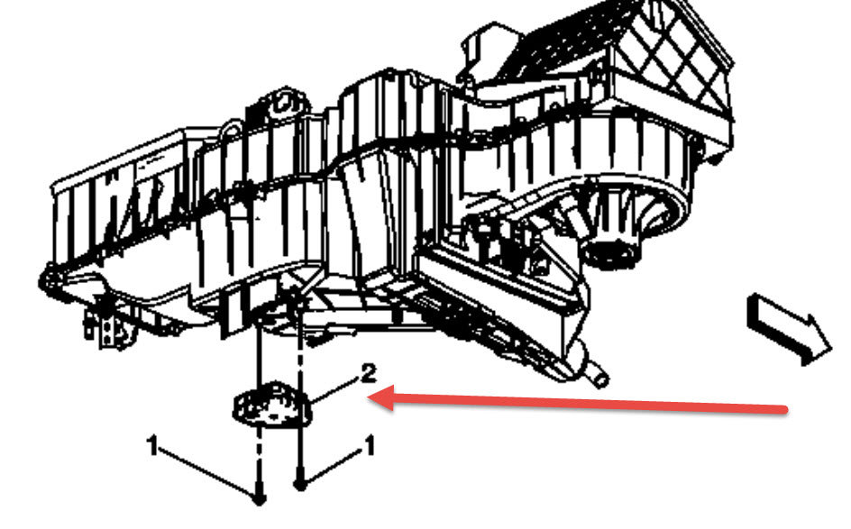

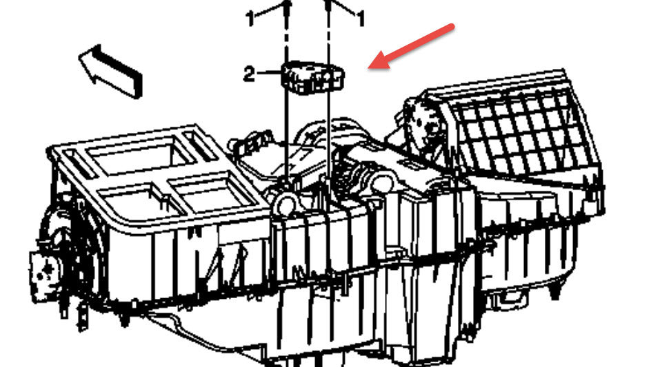

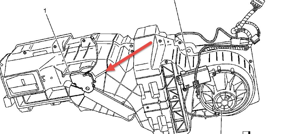

PATENTED_REPAIR_PRO
  • 1,853 POSTS
Here is the location of all 4 actuators,

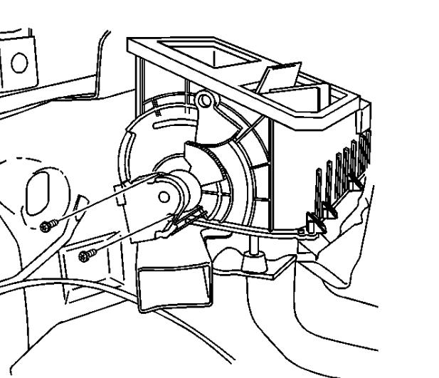

NAMVET
need to know how to put the actuator and the piece behind it back on the vehicle. This is the actuator that opens and closes all the doors to route the air to floor, defrost, in your face, etc. replaced actuator but didn't get the other piece in correctly. only have air to defrost and in your face.
Dec 18, 2020 at 12:23 AM (Merged)
HMAC300
  • 48,601 POSTS
it may have to be retimed I thikit's the mode one you are talking about it has to be put back in as an assembly. the dash should have pbeen pulled as well. you have to line up the levers with the cam slot and mode actuator cam
