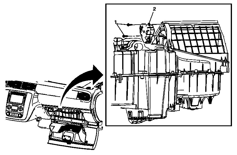

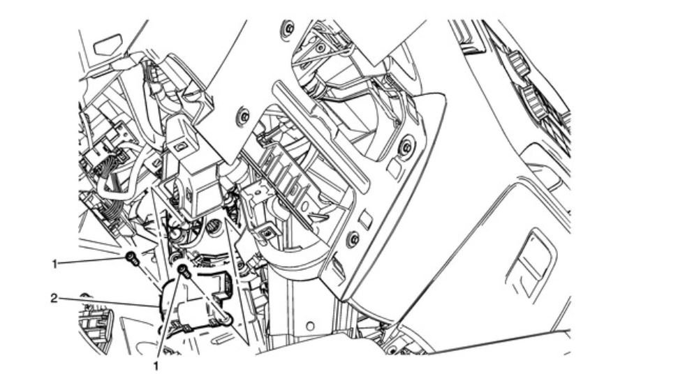

The defrost mode will not engage. It stays on the main vents. I can change the temperature for both sides of the truck. But will not go to the defrost vents at all. This is a 1500 crew cab.
Monday, January 21st, 2019 AT 10:35 AM
22 Replies
  • 52,797 POSTS
Good afternoon,
I attached a picture for you to view. The actuator, which is a common failure, is under the dash that controls the mode door operation.
+1
Monday, January 21st, 2019 AT 1:09 PM
FOWLER17Z
Well there it goes. Lol so anyways thank you for the information and photo. The dealer contacted me and said it’s a safety hazard. So there fixing it for free. But I’m sure all that information will help in the future and all the other people having similar problems.

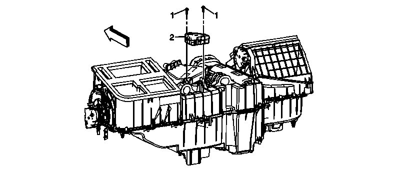

I am looking for locations of the blend door actuator under the dash. I have changed both the ones on the floorboard area on the driver and passenger side.
I appreciate any help!
+2
Friday, December 18th, 2020 AT 8:21 AM (Merged)
HMAC300
  • 48,601 POSTS
If you replaced on e on bottom and one on driver side that is for left hand side and mode- meaning direction. The right hand side is on top and normally requires dash to be pulled to access it.

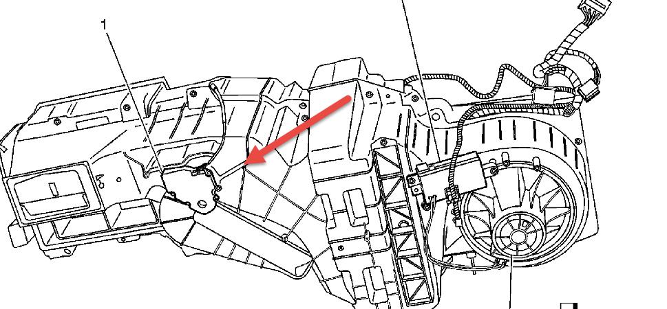

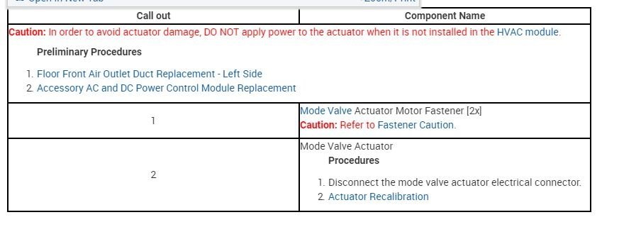

My AC and heat only blow through my vents. I can control everything else but where it comes out of. Is that what needs to be replaced and if so where is it located?
+2
  • 52,797 POSTS

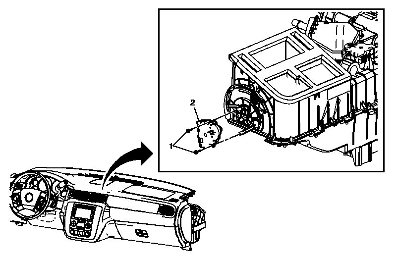

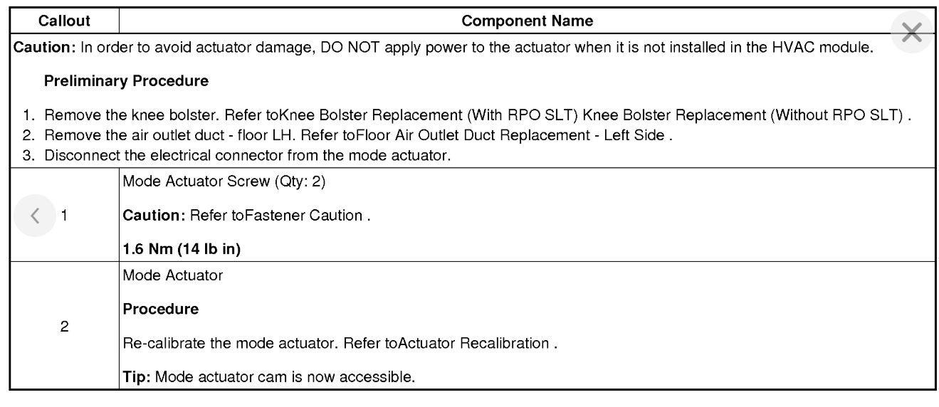

Good afternoon, I attached the picture and procedure for you. It is under the dash on the left side of the heater case. Check out the diagrams (Below). Please let us know if you need anything else to get the problem fixed.

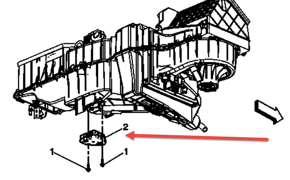

Are there four actuator's? There is a diagram on your sight that shows four actuator's I wanted to make sure this is correct. Thank you for your time.
+1
SATURNTECH9
  • 30,869 POSTS
If you have dual temperature controls there are two blend door actuators.
+1
SATURNTECH9
  • 30,869 POSTS
If your talking about the other actuators as well you have a recirculation actuator and a mode door actuator.
BWK
I have dual temperature control. Where are the two actuator's located? Thank you again.
SATURNTECH9
  • 30,869 POSTS
There both bad? That is highly unusual that they both would fail at the same time. What is the issue your having?
PATENTED_REPAIR_PRO
  • 1,853 POSTS

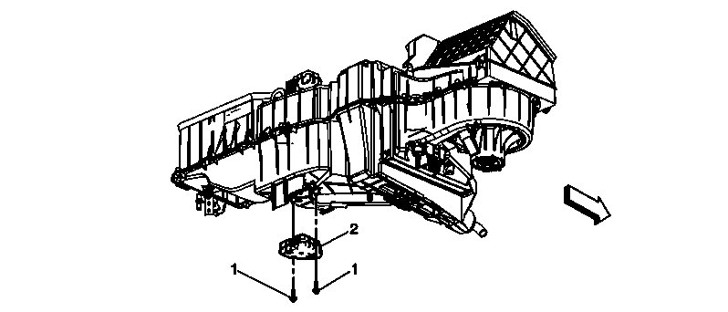

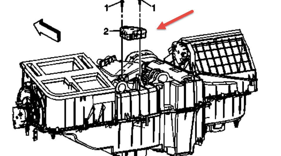

Here is the location of all 4 actuators.

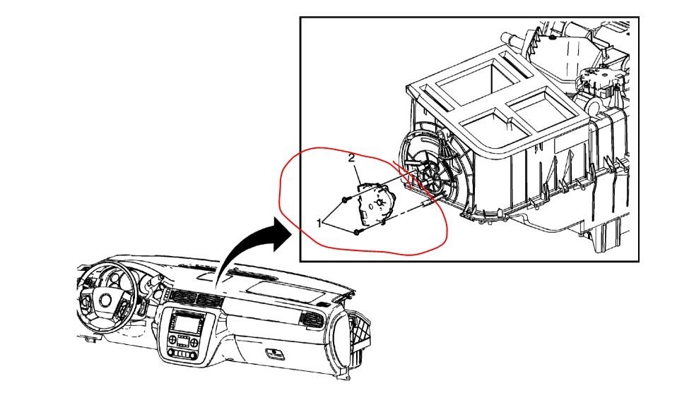

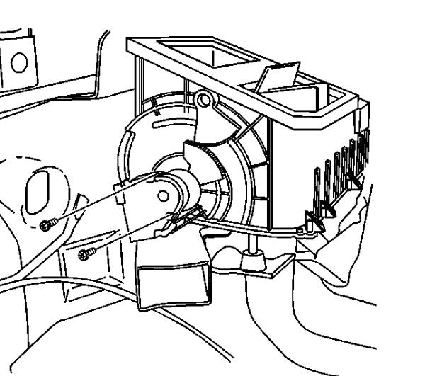

Replaced failed blend door motor. Motor only operates in one direction and will not move again no matter where temperature control for left side is set. I may not have the proper initialization instructions. Left side blows cold air only, no warm air selection.
Friday, December 18th, 2020 AT 8:22 AM (Merged)
  • 52,797 POSTS
Did you check to see if you could move the door freely before installing the new one to be sure there is not an obstruction?
KGKINC
Both defrost lever and blend door (white) control move freely.
  • 52,797 POSTS
Hook up the motor out of the dash and see if it moves both directions on command.
HMAC300
  • 48,601 POSTS
It may be on the bottom of hvac on or center by pass side there are two different types of hvac Delphi and Visteon so they may be a little different.
