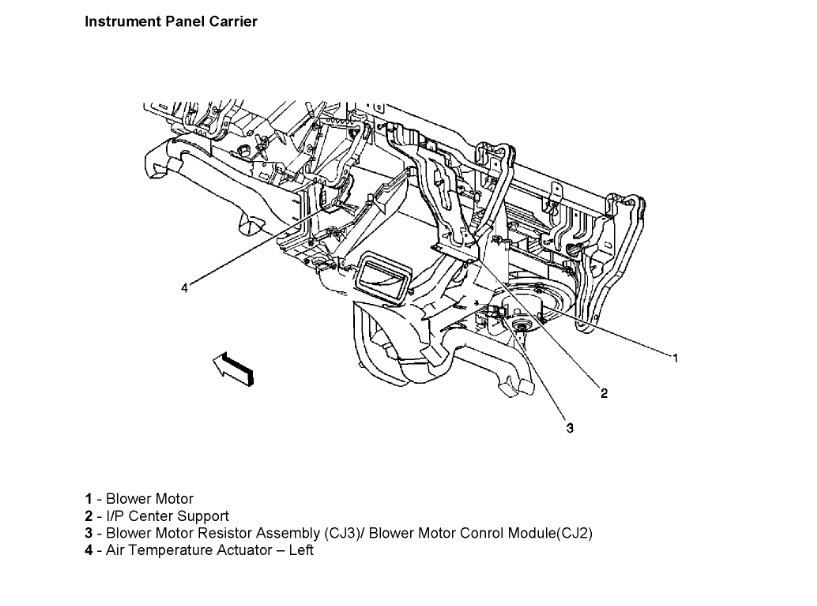

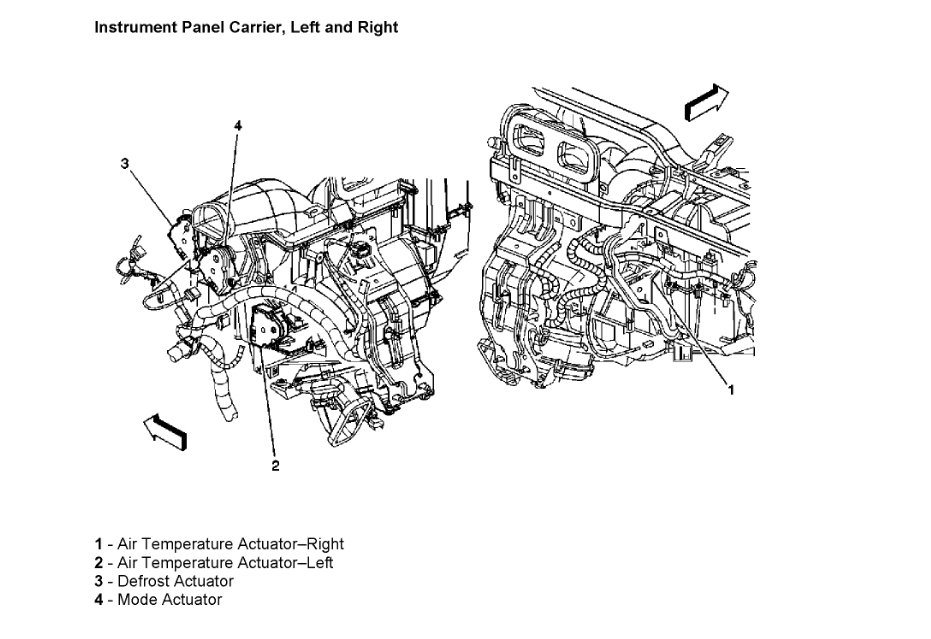

I have the SUV listed above that I have a constant clicking in my dashboard. already tried the reset does not work. looking for the actuator door or actuator motor that runs the vent system heat and defrost. I have heat on the floor and sometimes out of the frost. I do believe it's mounted at the top of the HVAC unit, not positive do not want to rip it apart until I get a hint. I do not have access to all data anymore. that I have been twisting wrenches 4/36 years was the dealership tech now unfortunately disabled and retired would appreciate any information. thank you
Nov 13, 2019 at 1:04 AM
SCGRANTURISMO
  • 4,897 POSTS

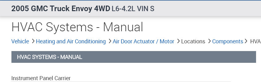

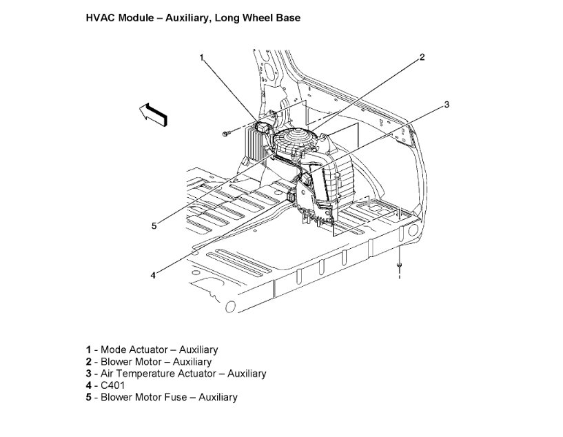

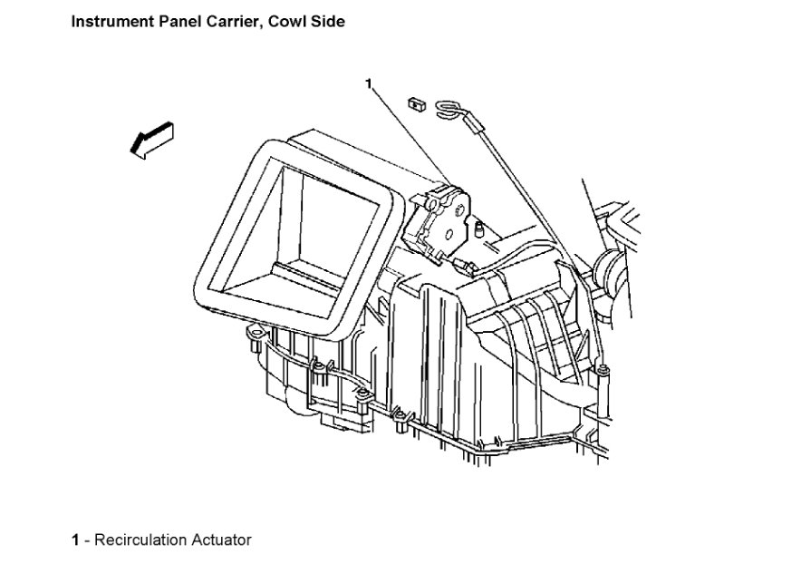

In the diagrams down below I have included the diagrams that you requested for the Air Temperature Actuator [Manual System] for your vehicle. Please let us know if your vehicle has the automatic system, and we can shoot those diagrams right over to you. I hope that this helps.
Thanks,
Alex
2CarPros
Nov 13, 2019 at 4:55 AM
AJCUSTOMS
I thank you for your help and the diagrams it's the mode motor and it's on driver side I just have to get to it.
