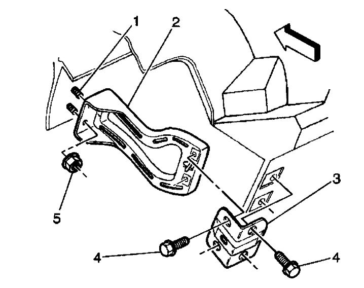

I need to replace the blend door that controls where the air blows out ( defrost, vent, or floor).
Been doing research but can't find anything.
Dec 31, 2018 at 6:47 PM
Good evening,
I attached the procedure for you with some pictures for you to view.
REMOVAL PROCEDURE
The mode door actuator is located on the top left side of the heater/vent module.
1. Remove the knee bolster.
2. Remove the right side driver knee bolster bracket (2) from the steering column bracket (1) and the intermediate bracket (3).

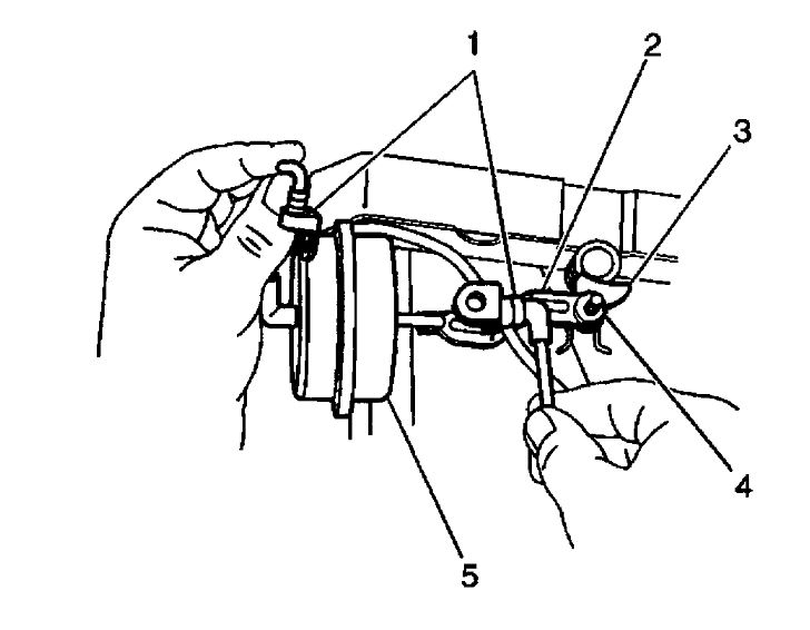

3. Disconnect the vacuum connectors (1) from the mode actuator (5).
4. Remove the actuator rod retaining clip (4).
5. Remove the actuator rod (2) from the mode door lever (3).

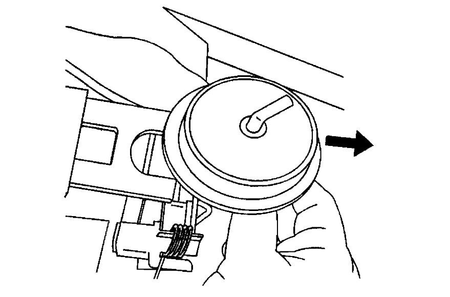

6. Firmly pull on the mode actuator in order to remove the actuator from the heater/vent module.

So it’s not a normal blend door? Because that’s what the parts store sold me.
Jan 1, 2019 at 11:57 AM
Not according to Alldata.
Did you get the mode door motor?
The blend door is electric.
