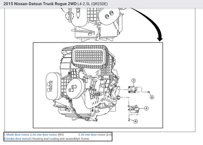

The blend door motor gear and the attaching blend door gear have chewed each other to the point where the blend door has failed in the cold position. It appears that the blend door or the door gear and/or the linkage needs to be replaced (and a new blend door motor as well) I did have my mechanic turn the blend door gear with a screwdriver to the heat position but over time and vibration it needs to be turned again. What does it take to have this problem resolved to normalize my blend door function?

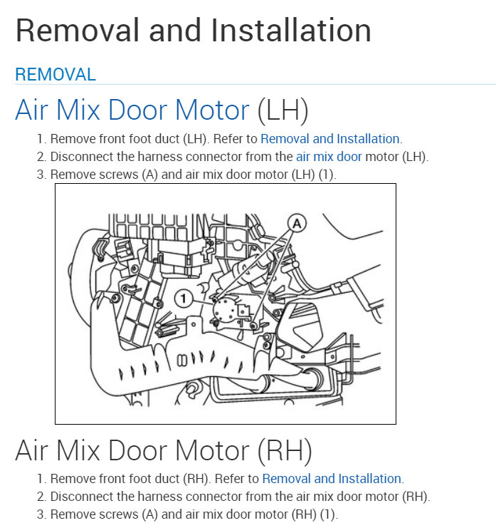

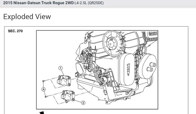

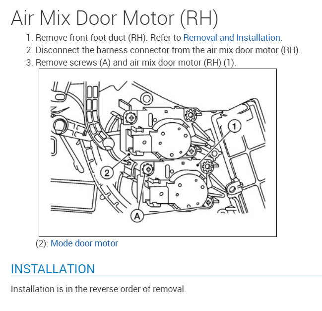

Sure, it sounds like the air door mix actuator needs to be replaced. I am looking at the unit and I don't see the gears you are talking about on the plenum, check out the images below to see what I am talking about and how to replace the actuator as well. Check out the images (below). Let us know what happens and please upload pictures or videos of the problem.

Hello, thank you for the reply. The gear I am describing is the white gear that couples to the blend door actuator gear. This gear is supposedly part of the blend door and to repair this the door needs to be replaced, then a new actuator motor. Is there a way to access this door and secure it to the heat position, as if to pull off one panel and put a screw in it? I do not like to make a hokey fix but from what I'm told the entire heating system and the dash needs to come off just to replace this door and that's a few thousand from what I'm told. Any direction on how to fix this temporarily or permanently without ripping out the dash is much appreciated. Thank you for your time and advice.

Yep, it sounds like the HVAC plenum needs to be removed. You are going to have to use your imagination on how to secure the door. Paper clip, rubber band, wood screw, anything to get the door to stay. If you can upload a picture of the situation I can try to help.
