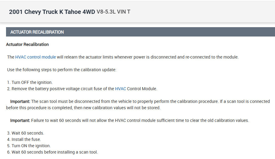

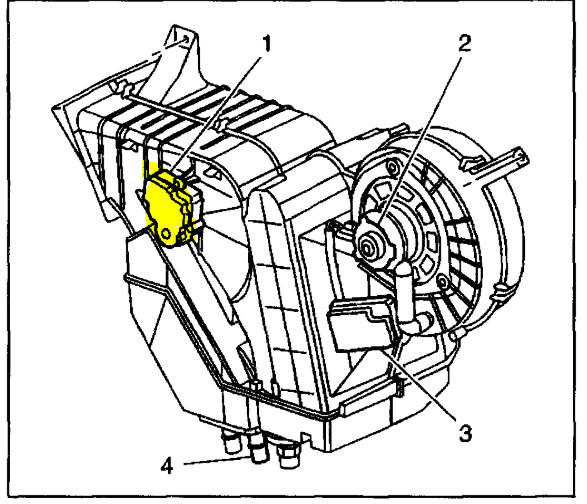

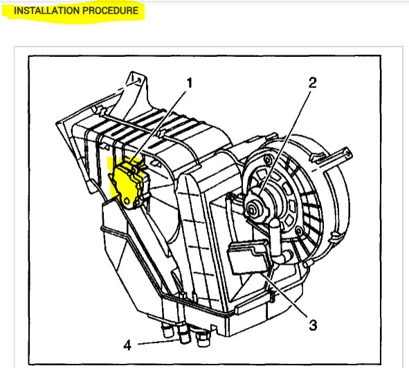

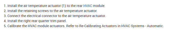

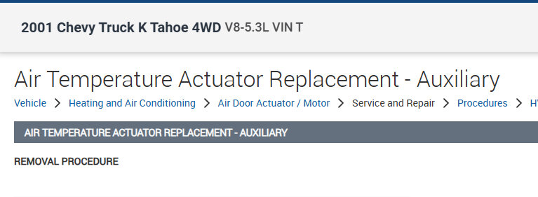

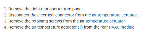

There is an air temperature actuator for the rear HVAC. It is located behind the passenger side rear trim panel.
If you look below, I attached the directions for removing and replacing it. Also, the last pic provided the re-calibration process.
Let me know if this helps.

I took off that panel yesterday and there is no blend door actuator in that area. The controls for the rear are fan speed only.
