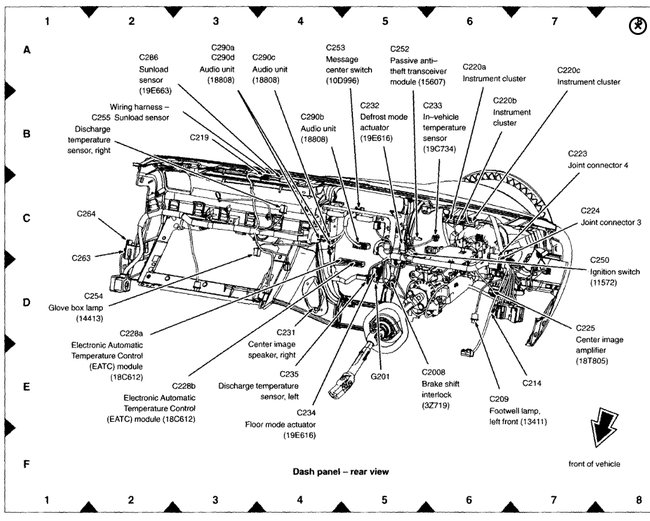

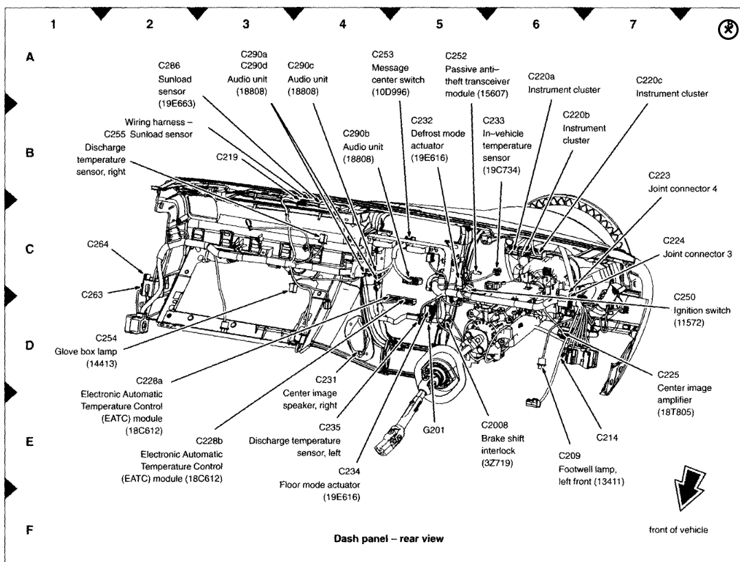

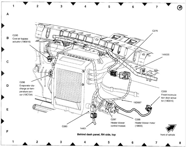

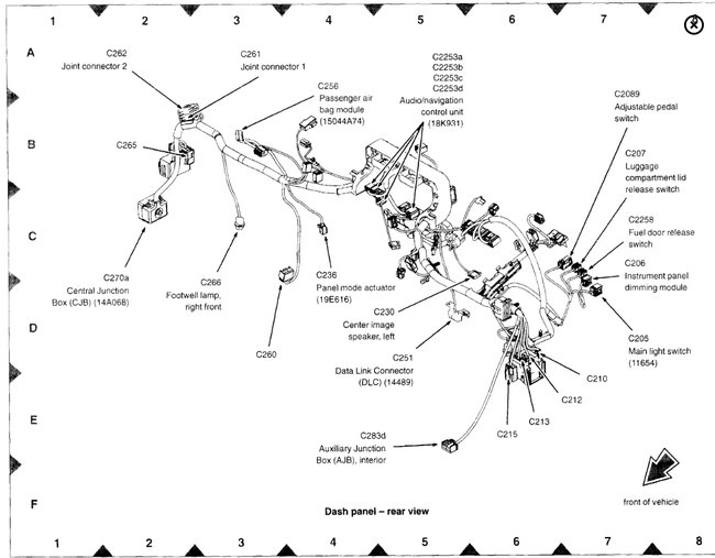

Where would the blend door actuator located inside my car?
Nov 14, 2016 at 6:52 AM
HMAC300
  • 48,601 POSTS
Here is a guide to help you see what you are in for when changing the blend door actuator out and diagrams below how how to do it on your car:
Cheers
