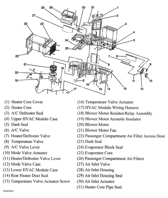

blend door actulator location
2002 GMC YUKON
210,000 MILES • 4.8L • V8 • 2WD • AUTOMATIC
GIOVANTA LILPOET MCPHEE
My air flow only blows through my defrost.
Aug 21, 2016 at 8:38 AM
SATURNTECH9
  • 30,869 POSTS
You want the mode door actuator the blend door adjusts the temperature .It is number 10 in the diagram.
