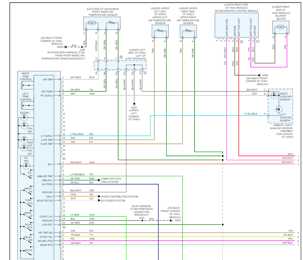

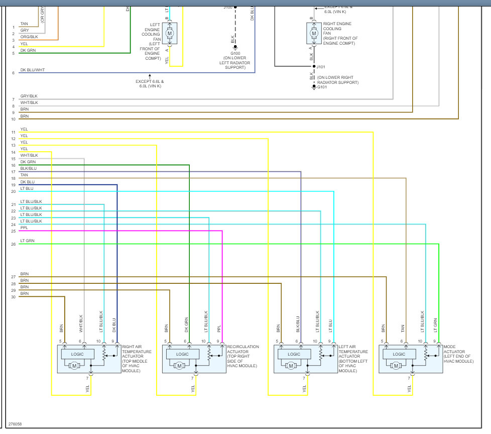

Blend door actuators will not sync up?
105,000 MILES • 6.0L • V8 • 4WD • AUTOMATIC
CLINT HOPE
I had discovered that my 2 blend door actuators were stuck on cool/cold air. After taking the entire dash off, I replaced the upper temperature blend door actuator. It sits almost center of the dash in the middle of where heater core and cold air are. After I started the truck up it continued to blow cold air now. The actuator will move to the cold air position and stop there every time. It will not go back to the hot air position and open the hot door. I've tried a couple of different actuators and they all do the same thing, stuck on cold!

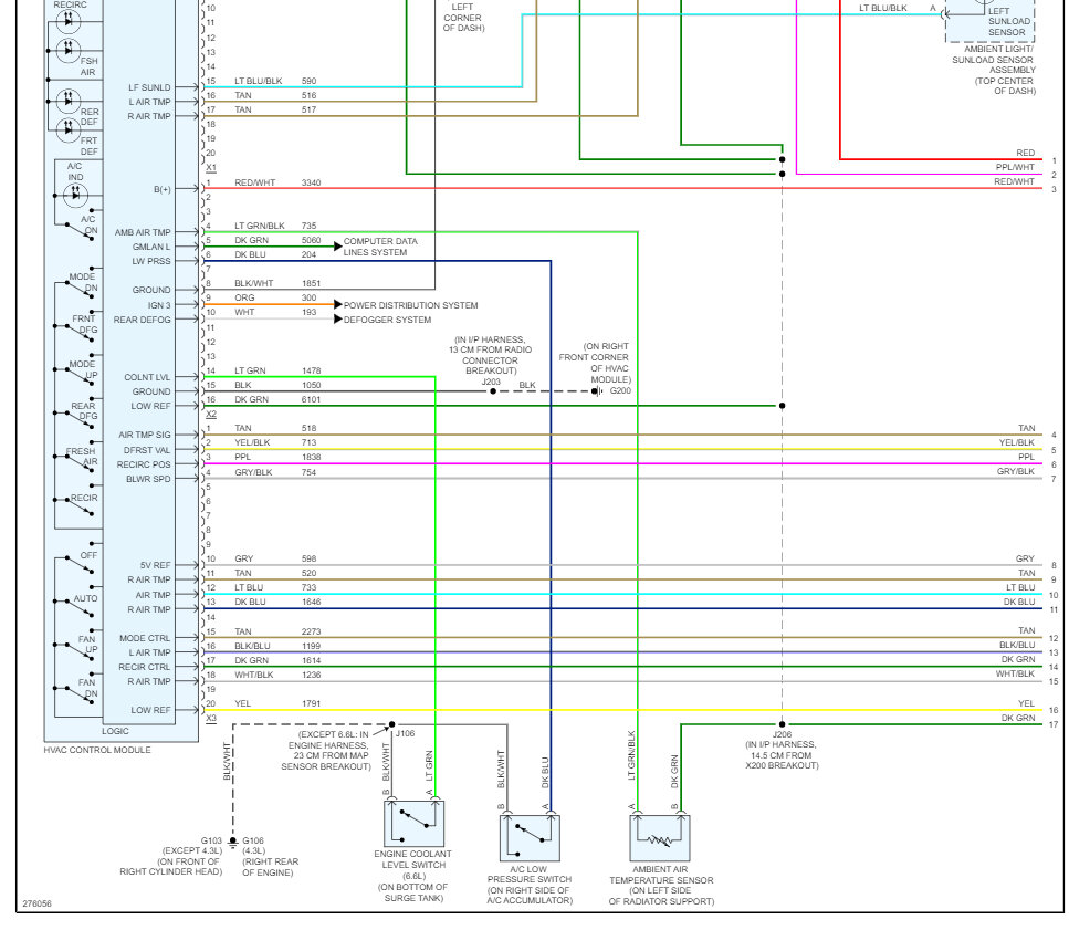

I have tried the re-set option of pulling the fuse method... probably a good 20 times. I have not tried the scan tool method. mostly because I was trying to avoid taking it to the dealer. But at this point I think it's my only option. I have tried 3 different climate control modules and they have all been the same model #. I have tried at least 7-8 actuators. Making sure that each one was the correct OEM part #. And also made sure that the correct actuator was in the correct spot. Of the 4 actuators, I believe only the Inlet/recirculation actuator is a different part # than the other 3. The other 3 are all interchangeable. I have bench tested the actuators and calibrated them to where the line is directly in the middle of its throw/cycle. Granted I have used entirely actuators that I have pulled from the salvage yard, along w/ the climate controllers. But none of them seemed to work. At least from bench testing them with a 9v battery. And yes... it is the dual climate with auto. The digital display one.

When the actuators were off of the HVAC plenum did you make sure the inner door pivots moved from one closed position to the other? This guide can help you see what I am talking about:

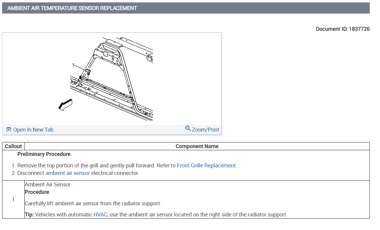

I would try to unplug the ambient air temperature sensor to see if that changes anything. Also, we could do a CAN scan to see if anything comes up. You can get a CAN scanner (Controller Area Network) from Amazon here is a video to show you how.
https://youtu.be/u-4syLc-ifQ
and

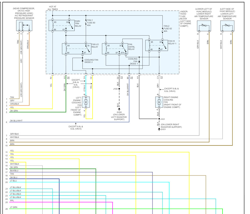

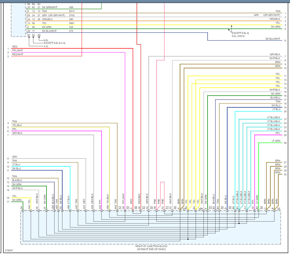

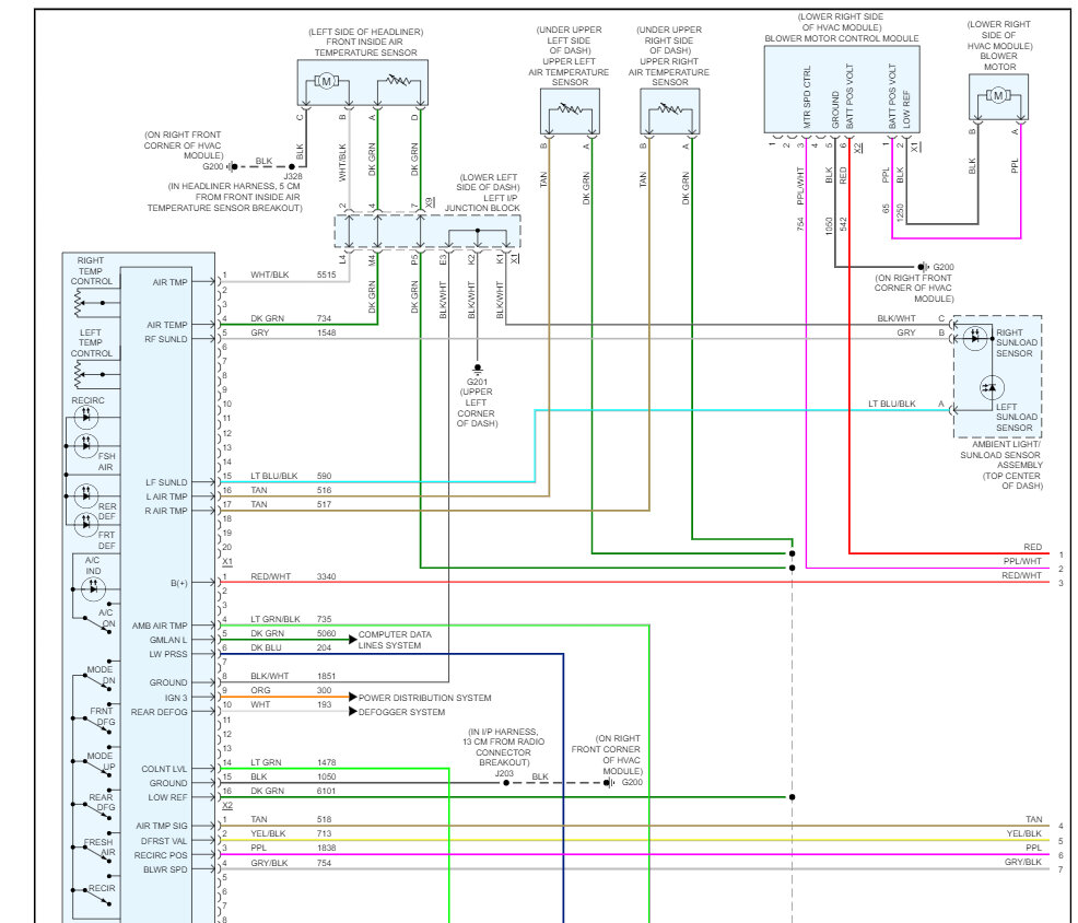

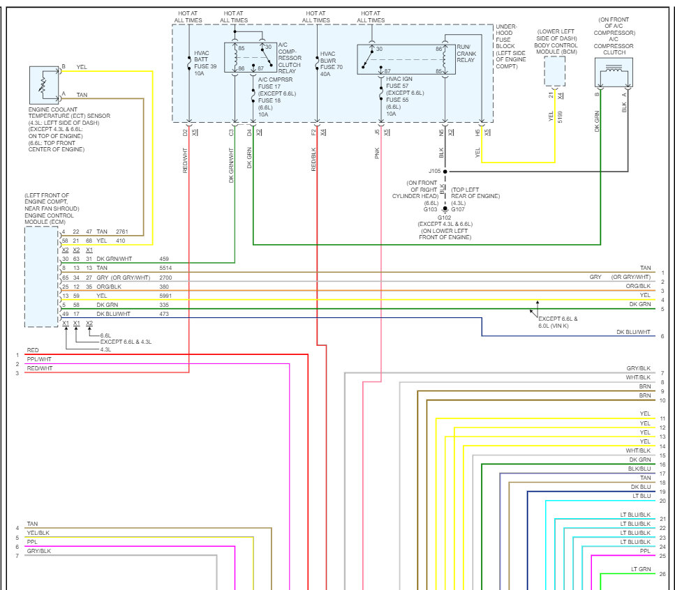

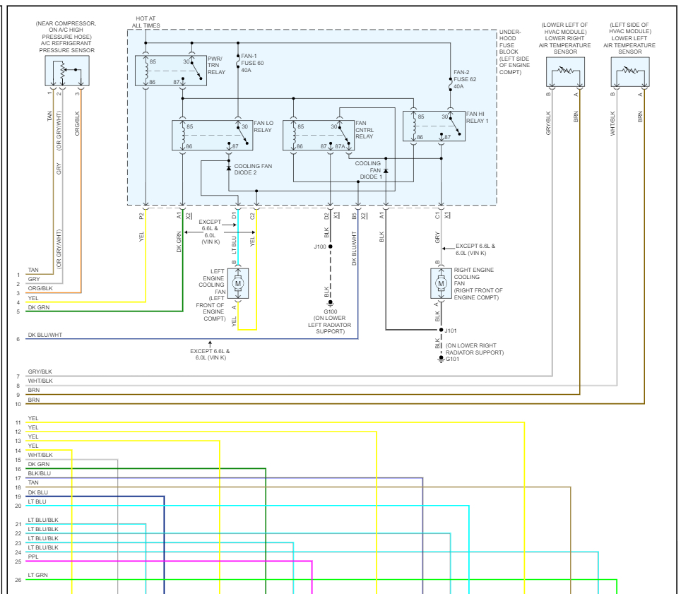

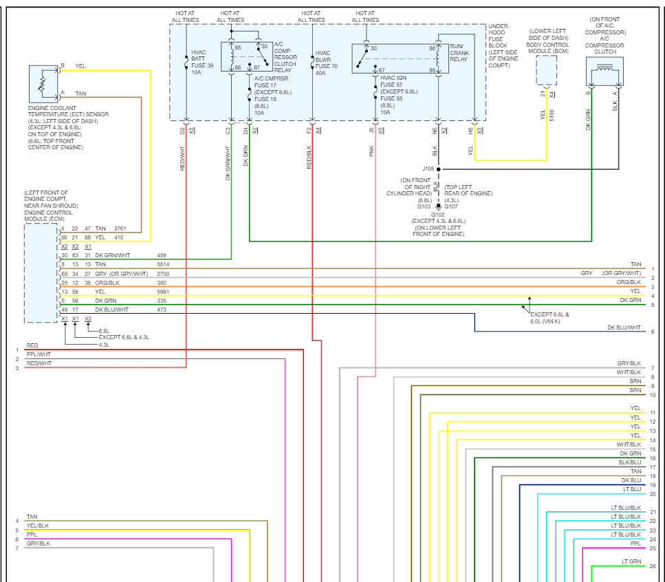

Here is the location of the ambient air temperature sensor in the front of the truck so you can check it out. Also, I have included the HVAC wiring diagrams so you check the grounds and connections.
