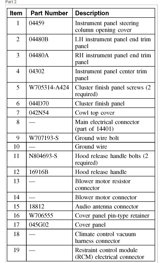

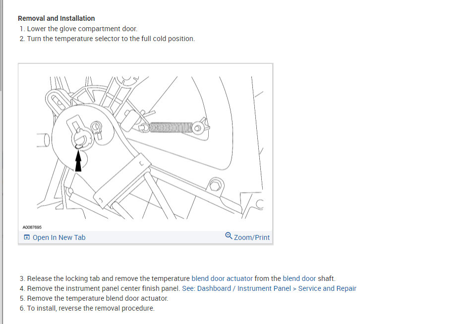

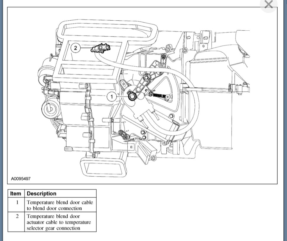

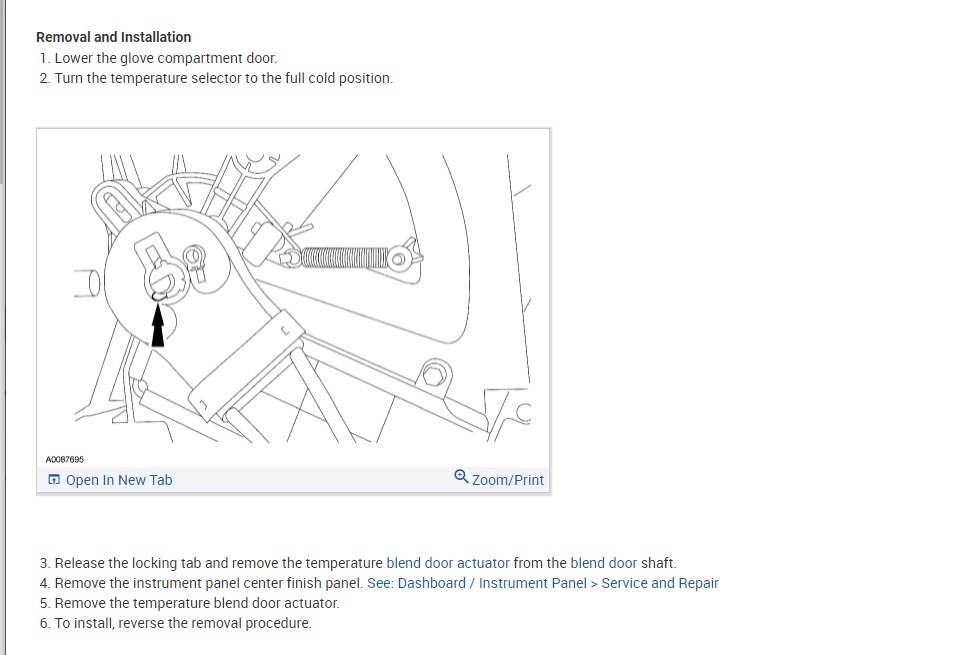

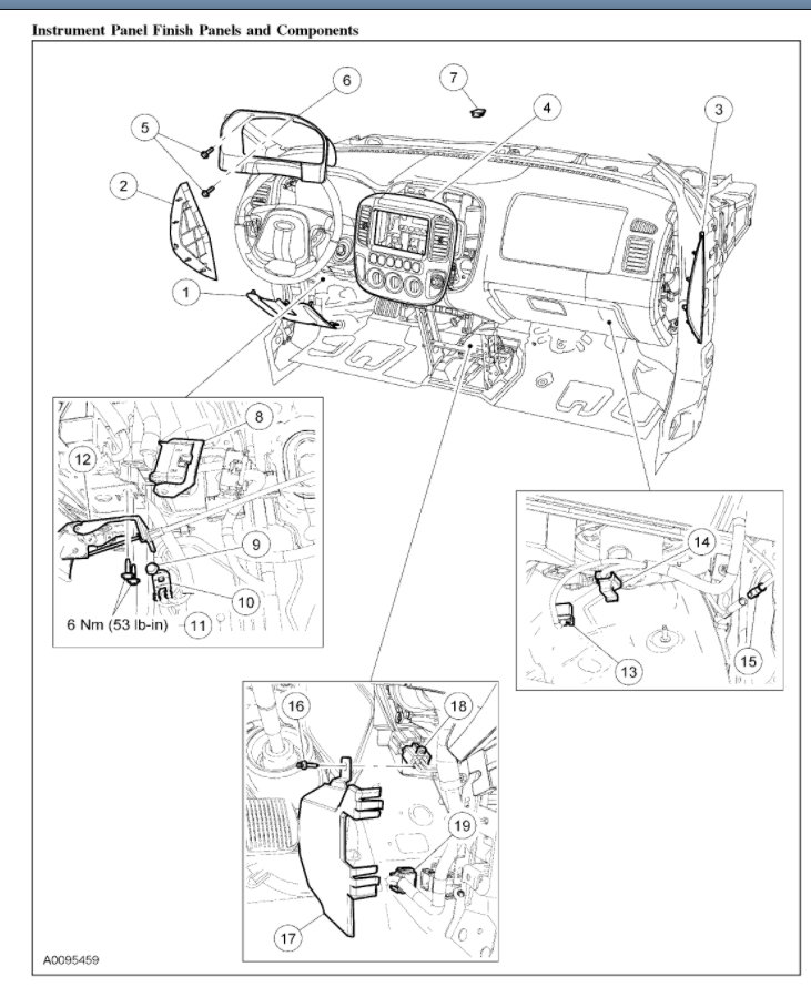

I've narrowed my air conditioning problem down to the blend door actuator and I bought the part from my local parts house. But I can't find the damn thing to replace it! Where can I get a schematic of the switches and relays that are behind or under the dash?

Sorry for the delay but when the case is updated it puts it back to the bottom of the cue and we work from the older cases to the newer cases, but we can definitely help with this.
No need to go to the library when you have 2CarPros. :)
I attached the process from the manual on how to replace the blend door actuator on your vehicle.
Also here is a guide that will help with step by step instructions on this:
Please let us know if you have other questions. Thanks

Thank you!! The more detailed of the 3 pictures is going to speed things up for us!
